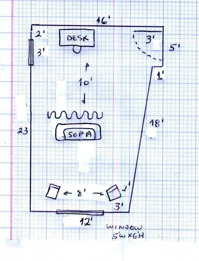

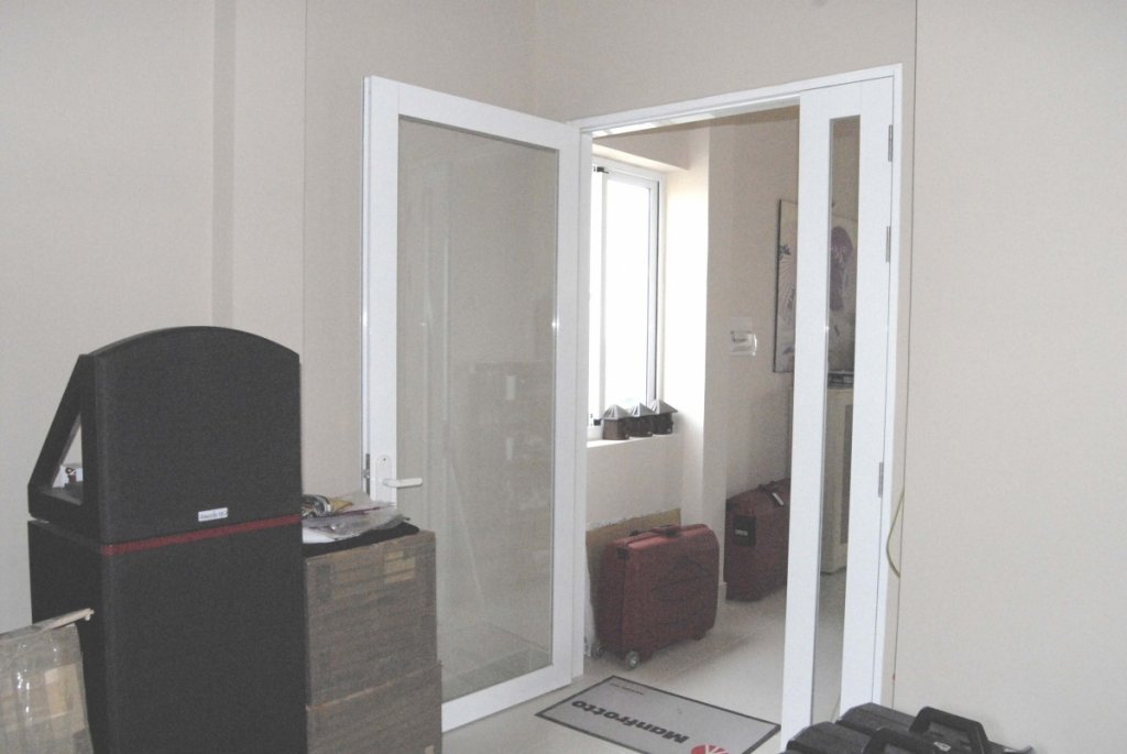

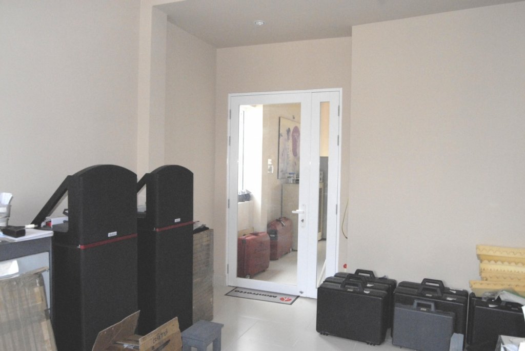

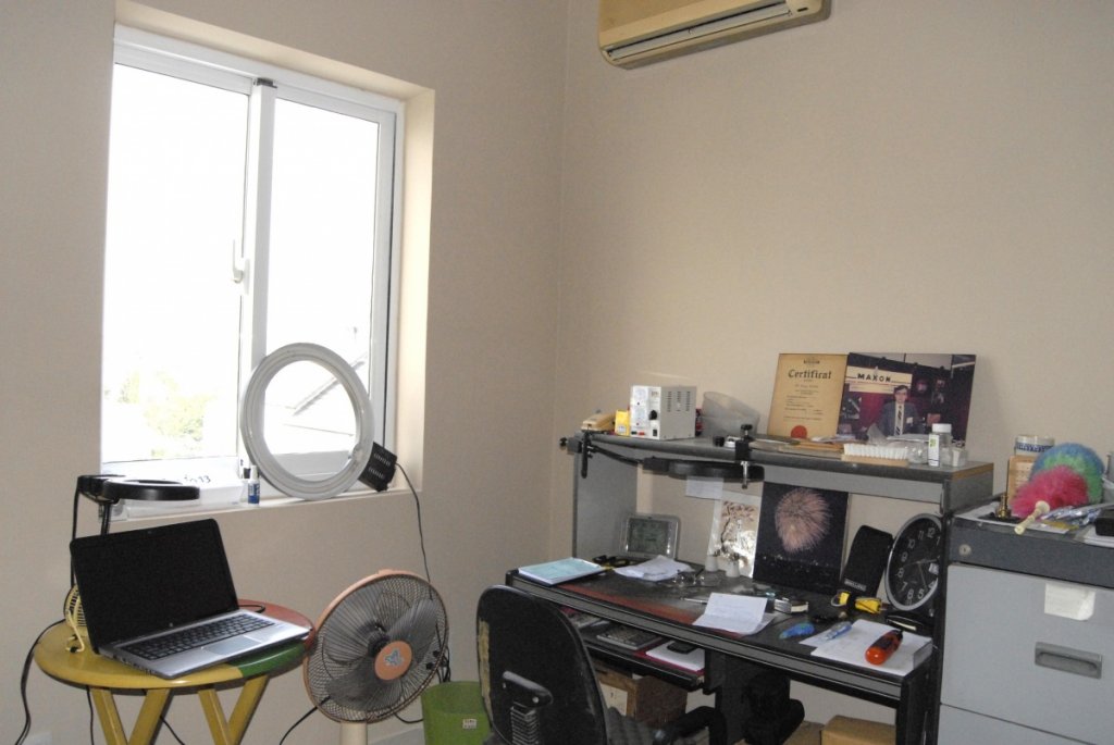

Hi Shawn the Martian.
Before hanging some curtain and laying down a carpet,
my listening room was an echo, echo, echo, box box, box, box…
Not it’s better, for the mids and the highs, but the bass is the one that has to be taken care of.
Your suggestion about buying a good pair of headphones arrive a little late, because I have already bought a pair of Sennheiser HD-650 and the Bottlehead Crack headphone amplifier is on the way.
However, nothing to compete with a good pair of speakers (I have that already) in a good acoustically treated listening room.
Please find herewith a more informative hand sketch with some more pictures of the problematic corners in my office.
I could easily fit at 45 degrees a 6” thick bass trap, between the window and the desk that can be moved to the right.
In the door area, I could fit a 4” thick absorber or bass trap (Whatever you call it) behind the door.
At night the door is open, therefore a 4” thick panel can fit behind the open door.
As for the curtains I’ve tried to blow thru them, not much air goes thru it. I wonder if having some 2” thick Fiberglass behind the curtain would be a waste of money, maybe a large absorber panel (4’ X 4’) 2” thick instead of the curtain, might be more efficient.
I gave up looking for acoustic stuff that in USA you take for granted. Here it’s Vietnam, it’s not what you want, it’s what they want to sell you.
I have checked carefully my budget and I have 500 USD for four (04) boxes of 6 pk of 703 Fiberglass, total cost : 268 USD from ATS Acoustic. They have cheaper stuff, like their own brand and some Roxul, but not sure of the efficiency of those products, even with the technical data.
Of course included in the 500 USD there is transport, custom, local wood frame, etc…
If I could sell some of my audio stuff that I don’t use anymore, that would solve my $ $ $ problem, but here, if it’s not a well know brand, they don’t even look at it.
Don’t forget the reinforced concrete ceiling.
Just want to add that I found some Made in Vietnam Styrofoam diffusers, (The one with different length cubes) at 7 USD each for 2’ X 2’.
Not sure if this could be of some help?
That’s it, I hope you have enough information to start educate me on listening room acoustic treatment.
