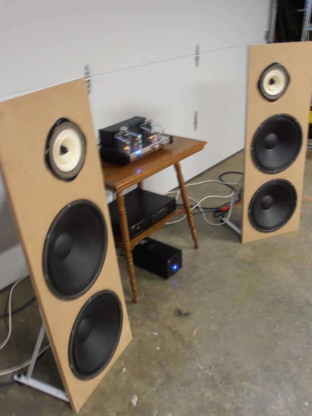

I was fortunate to win a pair of DX3's on ebay and have been enjoying them all evening. At the moment I'm driving the Lowthers straight off a SET amp with a Dayton APA150 providing power and crossover for the double Alphas. The Lowthers are giving me great clarity and detail and the sound tops everything I've had before.
The flat baffles are 19 inches wide and I would have gone wider but I used what I had on hand. The Lowther cones are so light and thin they remind me of butterfly wings.
The rare earth magnets are not nearly as large and heavy as the Tang Band W8-1808. They are very powerful and have a warning not to be used by anyone wearing a pacemaker.

Hi Poultrygeist and all Audio Circle members.
Not the nicest and best (Acoustically) listening room. :lol:
However, I like your set up and speakers arrangement.
Please post more pictures when your system will have found
it's final destination in your house.

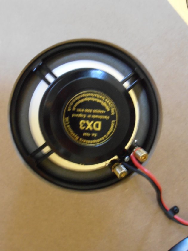

The cones pass light and are almost transparent.

Hi Guy,
The room treatments are disguised as paint cans and dog food bags.
My wife :roll: has already quizzed me on "what do you plan to get rid of to make room for those things?"

Hi (Again) Poultrygeist and all Audio Circle members.
I am sure they sound good, but would not put them in my living room,
unless they where at least painting a color matching the furniture... :lol:
Maybe those speakers should stay where they are, after all, you already have room treatment
with all your paint cans as diffusers.

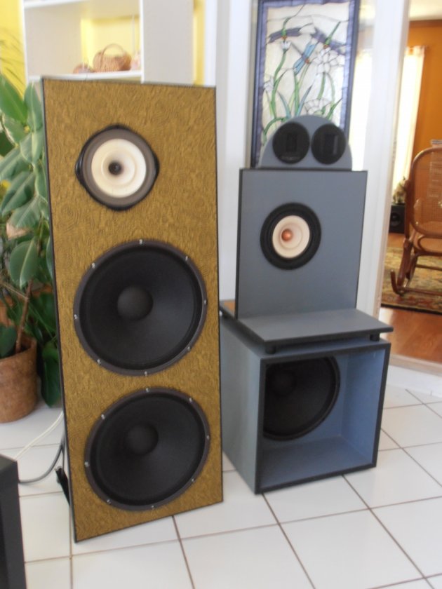

Completed OB's
Poultrygeist
Re: Lowther Open Baffles
« Reply #15 on: 3 Oct 2013, 12:47 pm »
Lowther flat baffle next to Tang Band H-frame
