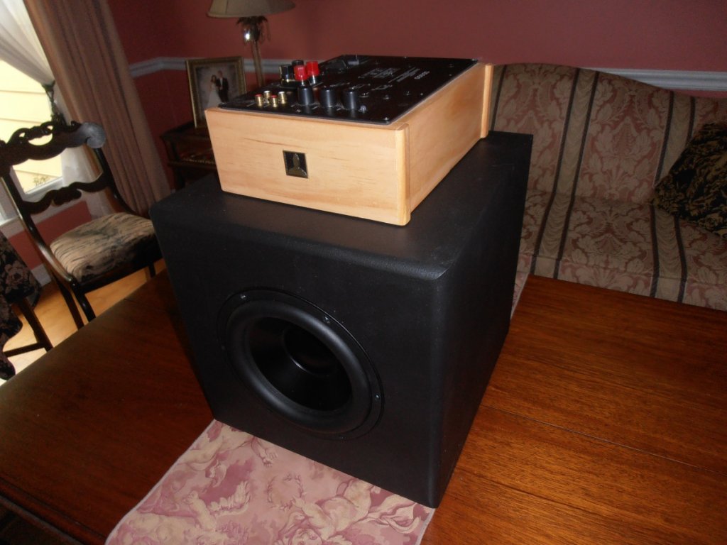

Here's the 8 inch Dayton I use with these OB's. The subwoofer and knock-down cabinet ( best MDF I've seen ) are on sale at P.E. Very impressed with their strong internal bracing. Augments the Alpha's extension and allows feeling the bass.

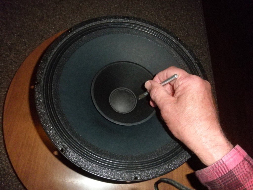

Although the Lowthers are my favorite wide banders the modded Beta 12LTA's are a close second. Paired with a Radio Shack tweeter and Alpha woofers they will play anything you throw at them. The Fostexs while slightly more detailed sound thin compared to the 12LTA's.
With a craft store phase plug "egg" painted silver the 12LTA can be handsome.

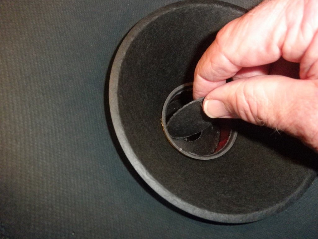

Cutting out the 12LTA dust cap.

Dust cap removal.

12LTA phase plugs aka Michael's Craft Store wooden eggs. Select the size closest to a real egg and counter sink four wood screws in it's base. Picture shows two but I added two more. These metal screws will magnetically attach the phase plug to the throat of the 12LTA.
