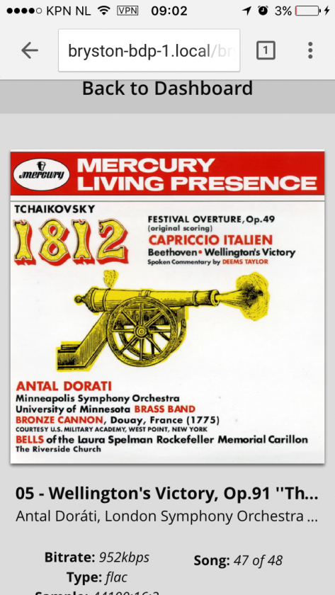

Album art issue: I finally have determined why some of my albums are not displaying thumbnails in the Artists View:
Any Artist Name or Album Title with an apostrophe (or single quote: ' ) fails to display in Artists View.
I went through and found a number of albums without thumbnails being displayed, yet found bdp_front_44 and _250 images in their respective folders; images that are correctly sized and display the correct album art.
After trying a number of things, like re-embedding scaled images, resetting the DB, et al., I noticed that all of the albums failing to display had this characteristic. So, I went through my entire collection in the Artists view and, yes, I can't find a single album that is displaying artwork with the above pattern, but almost every other album *is* displaying artwork. I did find some albums without embedded artwork, but even with a folder.jpg, nothing displays in the browser.
Some examples:
Grateful Dead: American Beauty (OK), Working Man's Dead (nope), History Of The Grateful Dead Vol. 1 (Bear's Choice) (nope)
Jethro Tull: Aqualung (OK), Benefit (OK), ... , A Passion Play The Château d'Hérouville Sessions (nope)
Lou Reed: Rock 'n' Roll Animal (nope)
Oasis: (What's the Story) Morning Glory? (nope), Definitely Maybe (OK), Oasis MTV Unplugged (OK), Time Flies... 1994-2009 (OK)
Erich Kunzel: Beethoven: Wellington's Victory; Liszt: Battle Of The Huns (nope), Tchaikovsky: 1812 Overture, Capriccio Italien, Etc (OK)
There are some others failing to update, like: Sinéad O'Connor, Osmo Vänskä and a couple of others that have hashtags in the album titles, but the vast majority fit the above pattern.
You're Welcome  :thumb:

Re: Manic Moose (S2) - BDP's third major firmware release
« Reply #1685 on: 10 Apr 2016, 07:08 am »
Hi Krutsch,
Do you see album art in default view with those files?
I've tried some of your examples, and then some, images are displayed in default view without exception.

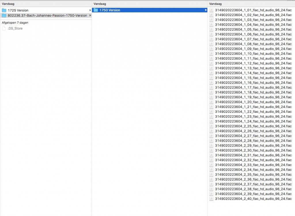

talking about editing tags and digital files...
Bought the new Johannes Passion on Harmonia Mundi SACD http://store.harmoniamundi.com/bach-st-john-s-passion.html and was pleasantly surprised it included a free digital 24 bit download of the recording. Always felt SACD should include that, but this is a first.
This is what it looks like though:
Sunday well spent  :?

Yes. In default view, during playback, I always see album art. What I am describing refers to issues in artist view with the thumbnails.
