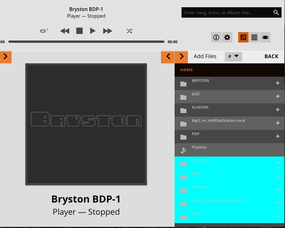

Would you consider and be able to allow MM to have a less black interface? Often i find it very difficult to see the contrasting parts of the interface, and in certain lighting conditions, find the white on black to be rather fatiguing to the eye.
Somehow i hope you can have a lighter (grey even) background with darker letters, like print, as an option? Like in the folder bar on the left of MM. Far easier on the eye. For me that is (50+... needing reading glasses, having reading issues in darker conditions etc etc...)

Hi Chris,
Did you add the crossfade.jpg to librarydoctor scan yet?
Marius
HI Chris,
Can't send images on the private messages so please allow me to post here.
Could you program the library doctor to search and delete for all files MM previously created in our libraries: adding crossfade.jpg to the already searched files bdp_front_44.jpg and bdp_front_250.jpg.
I've found the bdp_front files in .png format too, the doctor apparently doesn't find these? If so, please add that?
Also, please have the doctor search per drive, since my first attempt to run it hangs, presumably because of library size/amount of found files to delete.
Making this available in Disk Information would be really nice.
Thanks in advance,
Marius

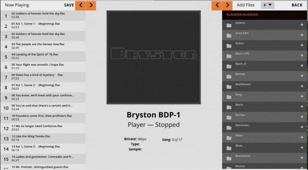

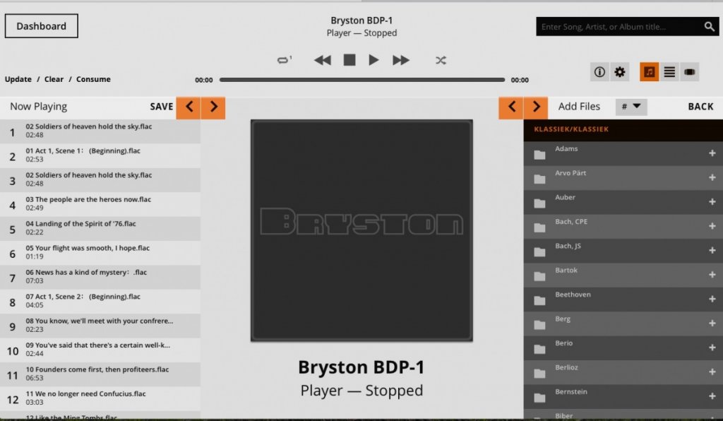

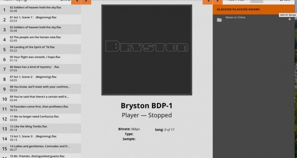

Re: Manic Moose (S2) - BDP's third major firmware release
« Reply #1653 on: 15 Mar 2016, 07:41 pm »
Yep, You're sure right not showing the missing files makes it a lot better.
Please let me re-post a question on the window-behavior of MM.
Whenever one clicks "back" the screen scrolls up just a bit too far, leaving those buttons only half in the picture. Can you adjust that? No need to scroll all the way up in the first place, secondly: Certainly not this far:
This would be much better:
Preferably even like this, having the command center in the picture all the time, scrolling only needed in the MM file/folder browser, not the safari-browser window:
Marius

« Reply #1655 on: 16 Mar 2016, 04:26 am »
Yes, this please! Especially with/for phone/tablet use!
Marius
Marius
« Reply #1656 on: 16 Mar 2016, 08:31 am »
Grit is right, mobile this is even more of a topic/priority.
Of course, that is why i also asked earlier if you could move the command buttons down, to right atop of the file browser, and not all the way up, above the Album-art, in the mobile version MM
Marius
