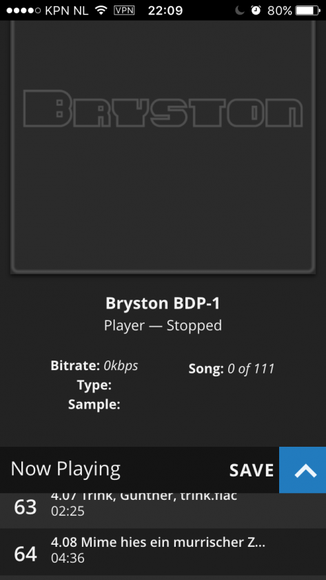

well, this is a first for me in 5/6 years: i'm playing music on the BDP1, and all seems working fine. Except there is no sound at all  :scratch: :scratch:
Im not 100% certain, but i think it is the first time i play with the latest beta build Chris made available. Has anything changed Chris? can i check a specific setting somewhere in the firmware? I see both ESI Juli@ entries, but of course don't have them disabled...
Have of course checked amps and dac which all play fine on others sources.
Please help...
Btw Chris, can we disable the popup messages? I find them quite intruding, especially on mobile. I do know by now i can put a bookmark on the desktop....don't need these 'tips' each time i load the bdp homepage.

Hi Folks, Chris,
Though im not easily panicked, im starting to get worried now. I'
ve tried it all, up to a power down/up pulling the plug from the wall, all to no avail.
Still my BDP displays everything fine, no error what so ever, but no music is heard. Nothing at all, not out of the AES/EBU nor the SPDIF.
Need some guidance here,
Chris, if you're there, servicemode 110 please?

MPD log:
Mar 10 07:44 : avahi: Service 'BDP' successfully established.
Mar 10 07:48 : alsa_output: Failed to open "ESI Juli@-00" [alsa]: Error opening ALSA device "plughw:0,0" (snd_pcm_hw_params): Device or resource busy
Mar 10 07:48 : alsa_output: Failed to open "ESI Juli@-01" [alsa]: Failed to open ALSA device "plughw:0,1": Device or resource busy
Mar 10 07:48 : output: Failed to open audio output
Mar 10 07:48 : player: problems opening audio device while playing "BRYSTON/01 - Dave's True Story/01- Misery.flac"
Mar 10 07:49 : player: played "BRYSTON/01 - Dave's True Story/01- Misery.flac"
Mar 10 07:49 : alsa_output: Failed to open "ESI Juli@-00" [alsa]: Error opening ALSA device "plughw:0,0" (snd_pcm_hw_params): Device or resource busy
Mar 10 07:49 : alsa_output: Failed to open "ESI Juli@-01" [alsa]: Failed to open ALSA device "plughw:0,1": Device or resource busy
Mar 10 07:49 : output: Failed to open audio output
Mar 10 07:49 : player: problems opening audio device while playing "BRYSTON/01 - Dave's True Story/01- Misery.flac"
