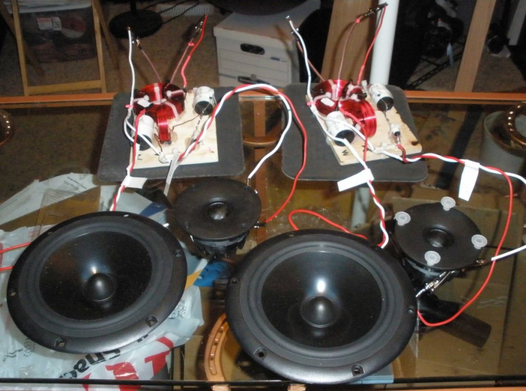

Good idea thanks. I hooked them up and got sound not smoke so I guess I did it right  :D
Mike

 Mike, Your crossovers look great! Did you use any components from the original crossovers? Also, is the cabinet plywood Maple? I used Maple Apple ply to make a boombox, and found it difficult to get a stain to look good and ended up only lightly tinting it. Maple is not the easiest wood to stain. If your going to round over the edges I found the fact that plywood has the grain alternating with each layer, I got minor tearout of some plys on the roundovers. Maybe experimenting with different router speeds on scrap pieces would be prudent.
Keep the pictures coming...

No I did not use anything from the crossover circuit boards that normally come with the kit. Since I wanted to upgrade everything on the board and do a complete point to point crossover the circuit boards would have been redundant so I didn't get them to begin with, just the parts and schematics like you would get with any of the A/V, N, or OB kits Danny sells.

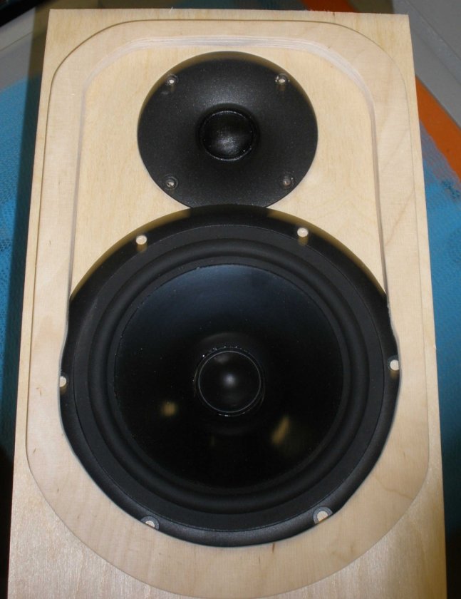

Got a little more done.

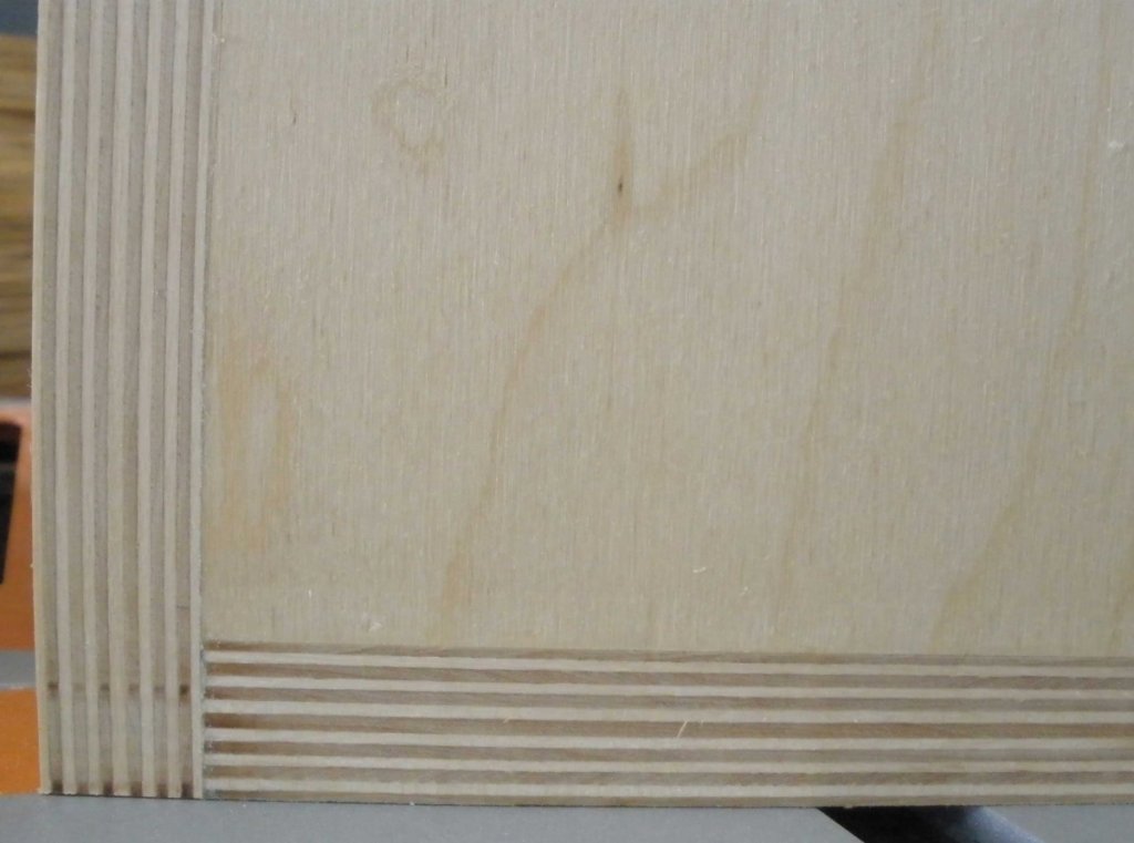

Here is a sample of the color I intend to use, it is Mahogany. It has one coat of pre-stain, one coat of stain, and 2 rounds of shellack with sanding to 400 grit after coats 1 and 2. The actual finish will have 2 or 3 more rounds of shellack with progressively finer sanding. I like the darker, richer colors and warmer tones.  However, I cannot figure out how to keep the flash glare out of the pictures.

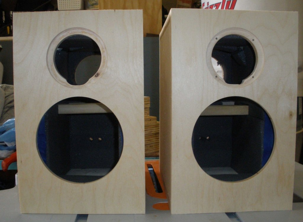

Here are the cabinets glued up and flush trimmed.
I realized that since I cut the front baffles oversize all the way around so I could flush trim I could not align the grills before gluing the baffles on without risking them being cockeyed. Therefore I decided to mount the grills afterward and live with plugs over the magnets.  How thick of a plug will a 1/4" x 3/8" neodymium magnet work through?

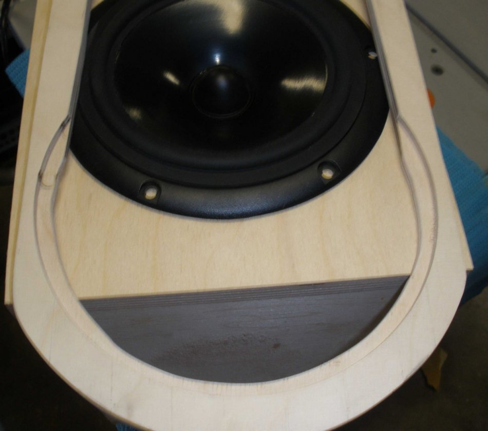

Here is one of the grills. I recessed the back for the woofer.

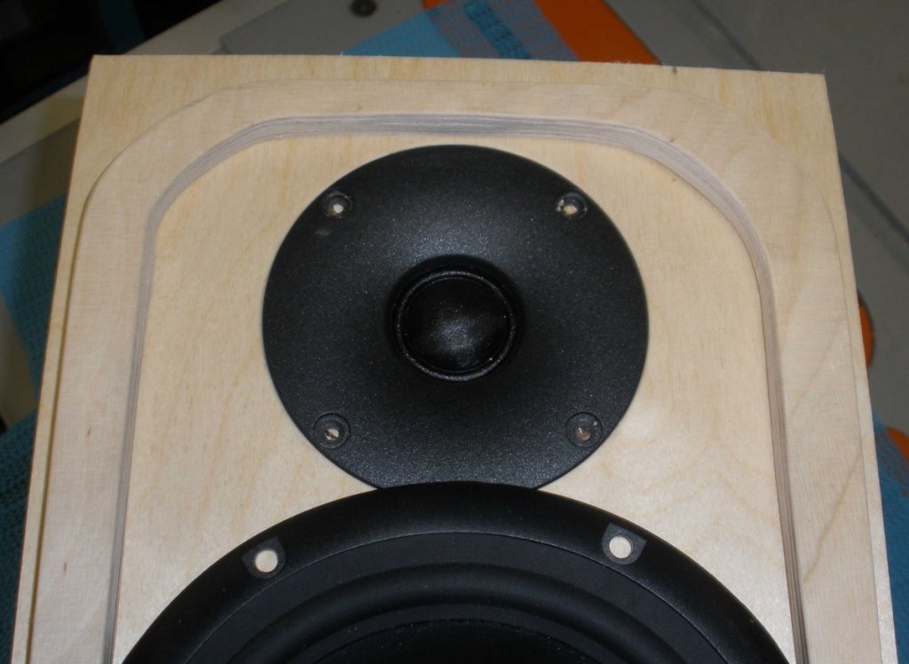

Is there enough room around the tweeter?  The stock is 1/2" Baltic Birch. How much of a round over should I put on the inside, 1/2" or 3/8"?
Mike
Danny Richie
Re: X-LS Encore & X-CS Encore Build
« Reply #29 on: 26 Jun 2013, 03:28 am »
Mike,
The negative effects that a grill frame has on the response is from a flat inside surface that is as tall as the grill frame is thick. Put a large radius on the inside edge of the frame and you will greatly minimize its effect.

I'd try  to keep the plugs as  thin as you  can.... are you  using the N52  greade magnets , they are stronger and will let you  get away with a bit thicker plug  .   You might want to try some different thickenss's  between a couple of the magnets just to see  how much  the plugs effect   the pull
The bigger roundover would probably be better but may be a PITA to cut on the 1/2"  grill frame due to the depth of the bit.  If I remember correct,  I used  a 3/8" roundover  then  used a   foam sanding block to   try and increase the  radius slightly.

Yes the magnets are N52 grade.
I will probably do the roundovers on my router table. I haven't been able to figure out how to hold something that thin high enough and solid enough to use even my smaller trim router.
Mike

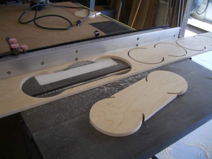

Lesson learned..... a 1/2" roundover won't work on a 1/2" piece of stock, there is nothing for the bearing to roll against. The router chewed that grill cover up, it's toast.  :duh:  Now I have 2 to make instead of one. At least I'd already traced out the 2nd one.

If you could get another opening to exactly match it would probably work but since the opening was cut out with a jigsaw and final shape was achieved with a sander getting an exact match would be difficult. I'll try a 3/8" roundover on 1/2" stock and see if that works better.

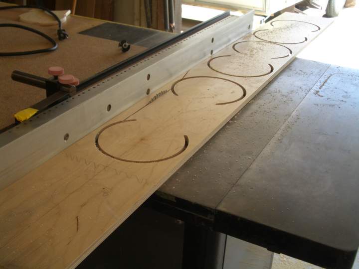

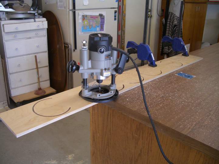

I used a circle jig to cut out the holes in my grill frames, then you can cut out the extra by dropping them on your table saw blade.
Your project looks great

Thanks Mike and Niel.  I was just wondering about using a jig with my router. I'm still pretty green with the router.  But my table saw?  Wow I must have misplaced it.  :lol:  I'll be using my circular saw.   Oh yeah, I should pit my boxes together first!  :lol:  :duh: :lol:

That's why  I  was  saying the  depth of the 1/2" bit might be  a PITA  .  Thought   if you  were trying it yo  might have   clamped the  2 frames back to back   on a table, routed the top one,  then flipped it  to  route the bottom one.
Sorry Mike,  I should have explained   rather  than  just  saying  PITA
