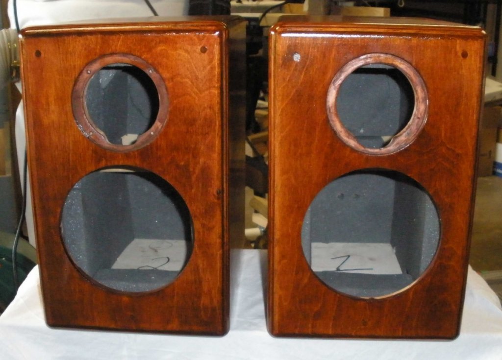

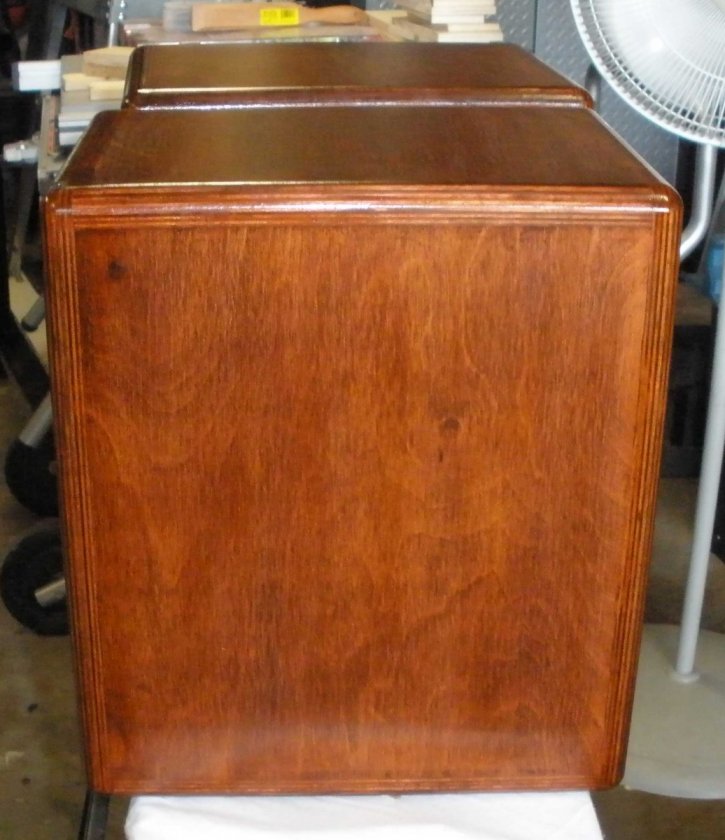

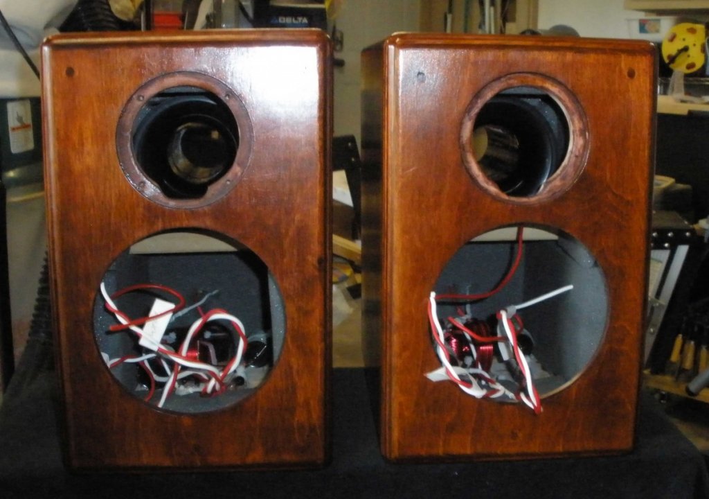

Here are some shots of the LS Encores after the shellack has been applied. First from the side

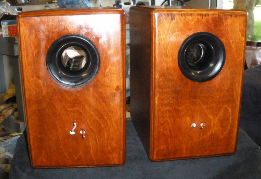

Here's one from the rear showing the flared ports. You can see the tear out still shows, on well, it's on the back
And here's one from the front

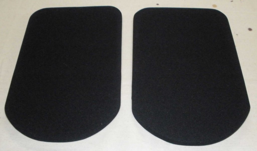

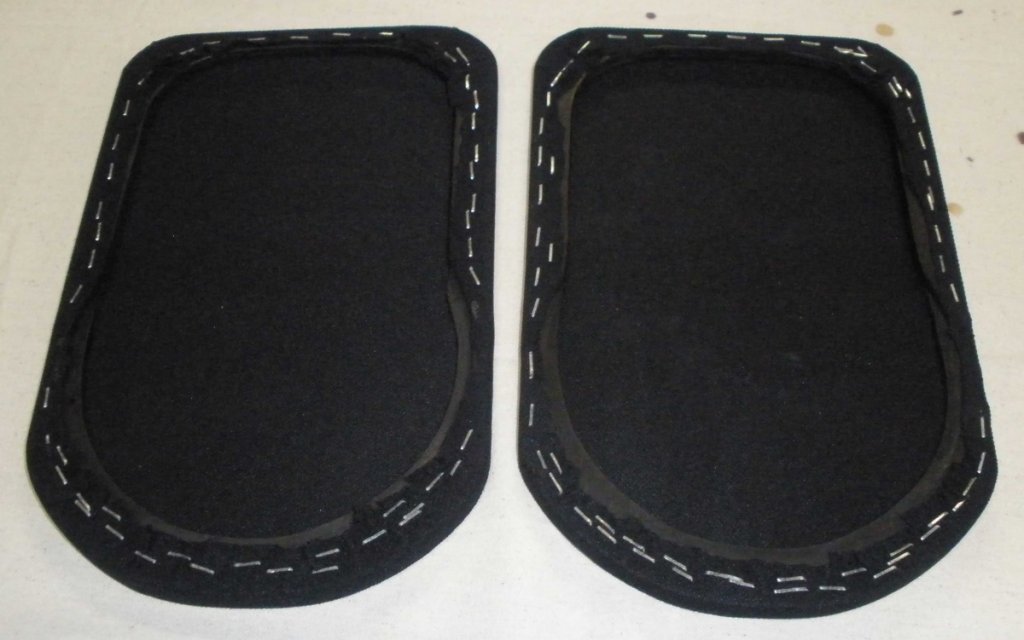

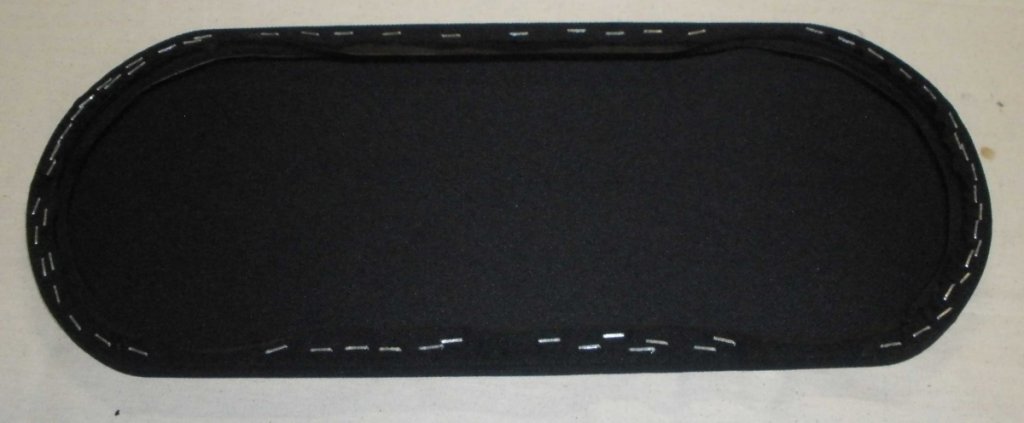

Here are the finished grills. First from the back
Here's a closer shot of one from the back

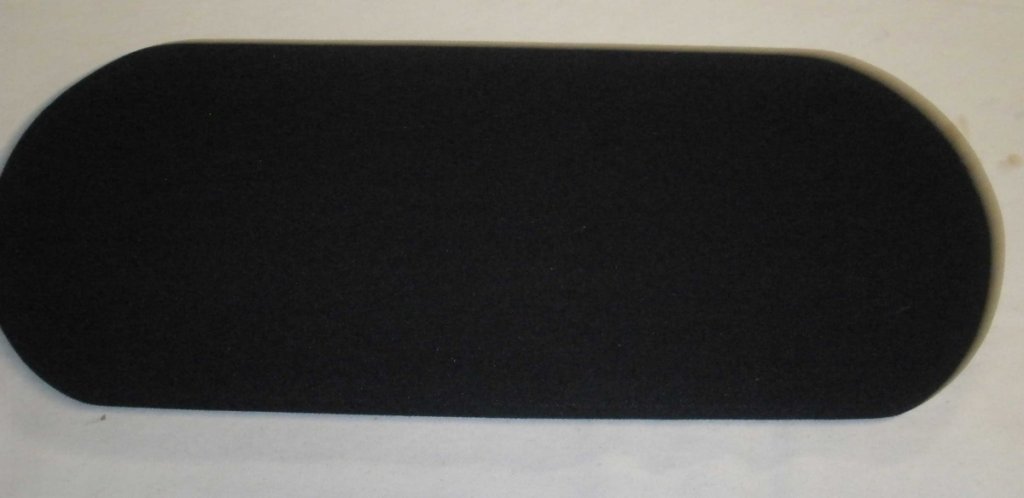

And here's the front view
More on the way,
Mike

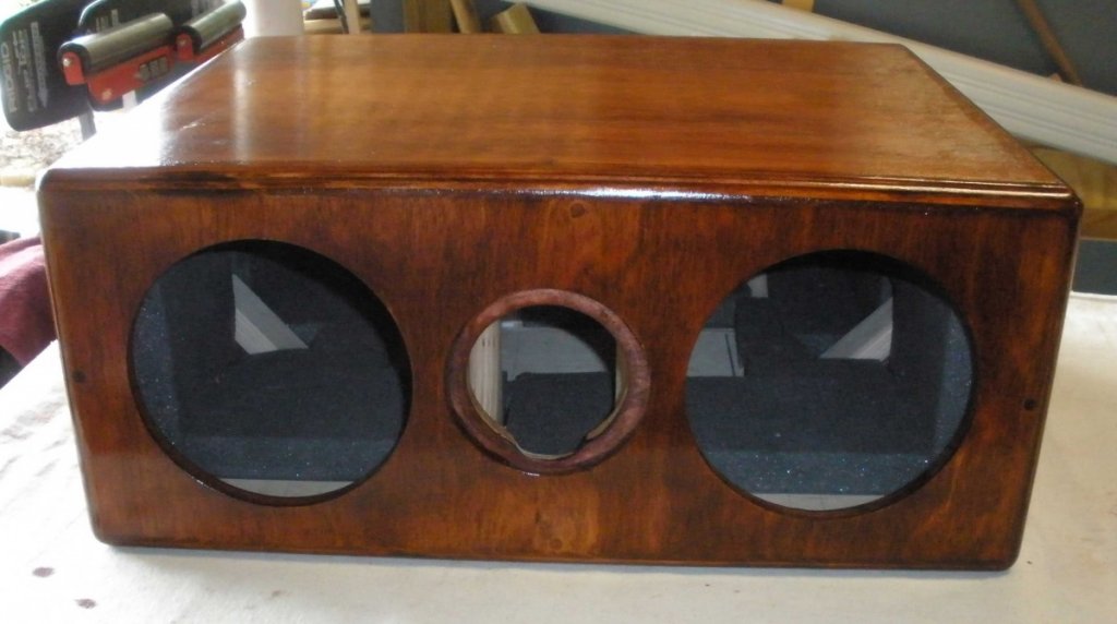

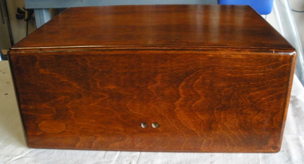

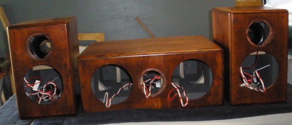

Here are some shots of the X-CS Encore after the shellack has been applied. First from the back,
Then from the front

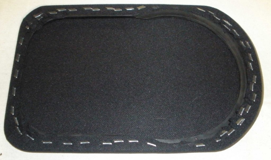

Here is the finished grill for the X-CS Encore from the back
and the front

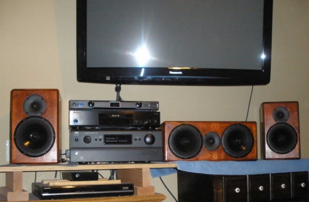

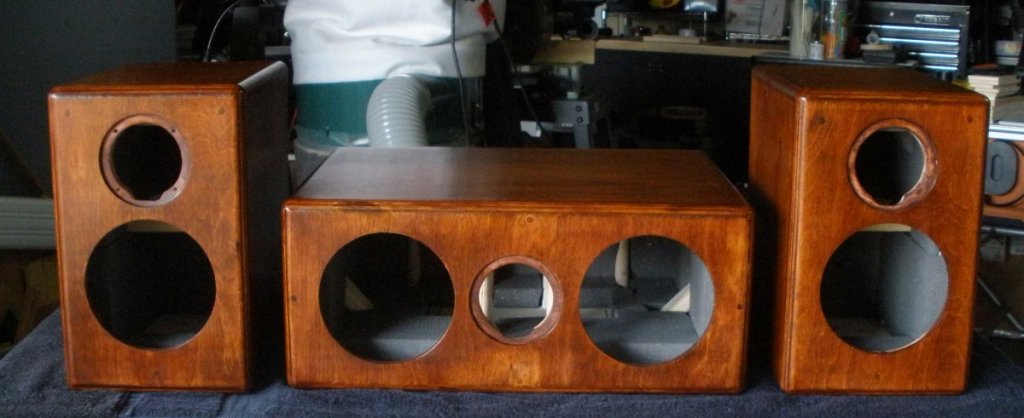

Here is a shot of all three speakers from the front after the shellack
Here is the CS with the crossover installed
Here are the LS's with the crossovers installed
Here is a shot of all three speakers with the crossovers installed

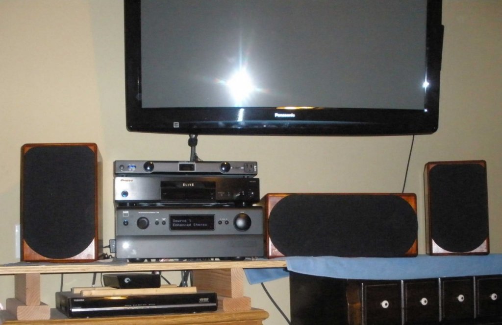

Here they are set up and playing in the upstairs room. First without the grills
Then with the grills on
They've been burning in for parts of two days now and have about 20 hours playing time on them. Sounding better but still have a ways to go. They do require more power than the PSB's they replaced (3dB less sensitive) but are well within the ability of the NAD AVR. So far I have not run them any louder than -20 on the volume scale (it goes up to +15). Right now they are playing at -20dB and I can hear them just fine downstairs in my office.
