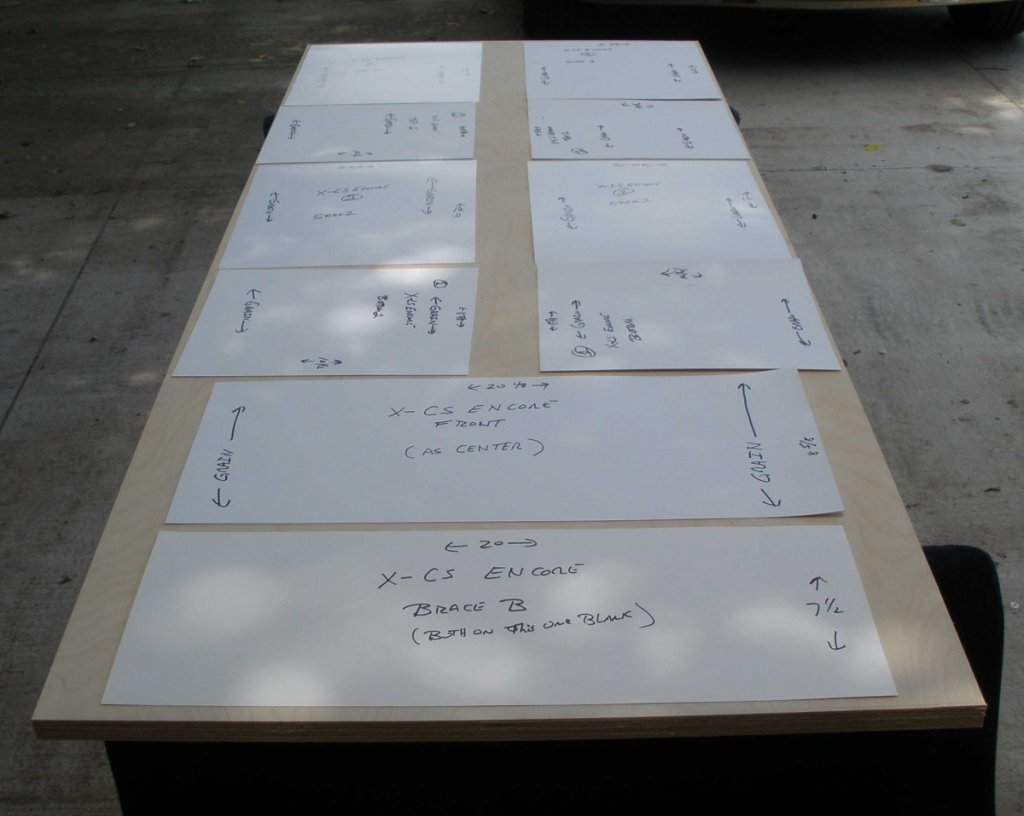

I started out making templates out of poster board and laying them out to match the grain and best use the wood. I was able to get all pieces out of one 5' X 5' sheet of Baltic Birch.  Lessn learned: after going to all the trouble to match the grain on adjacent pieces, mark said pieces with all pertinent information including which piece goes with each other  :duh:

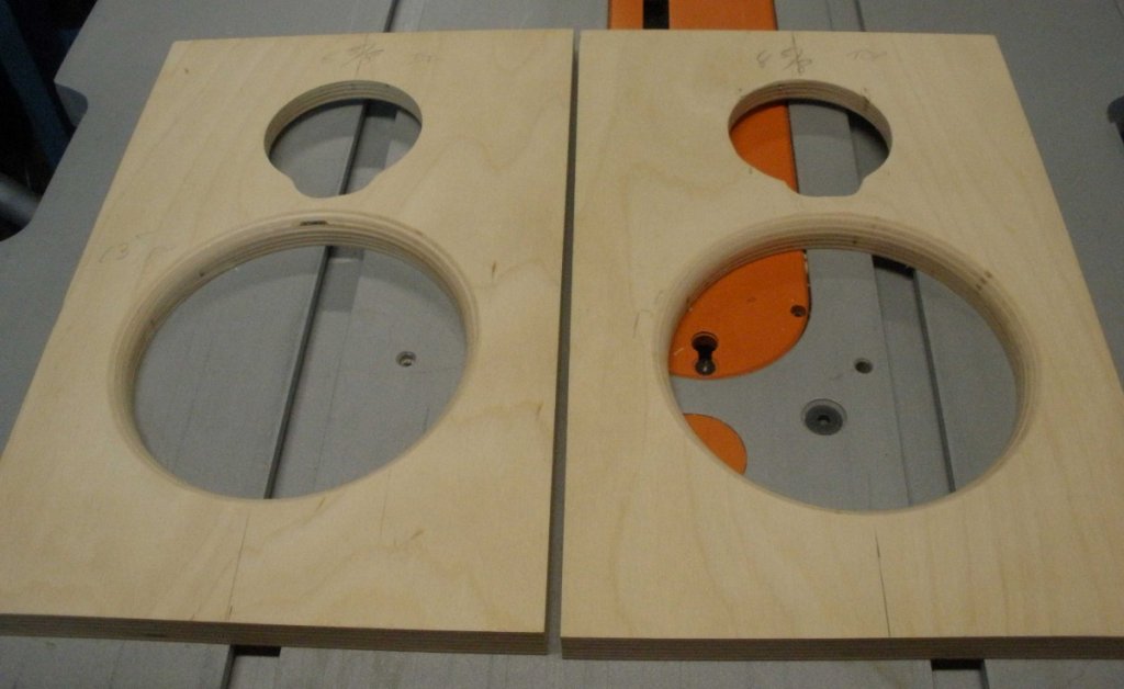

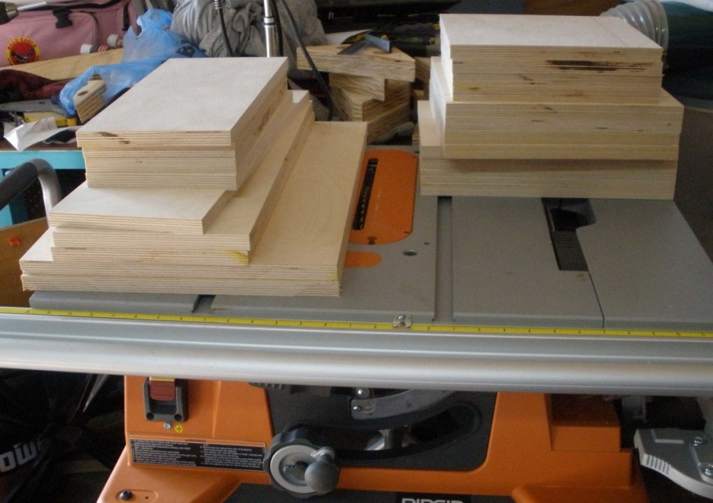

Then I cut out the pieces for all three speakers

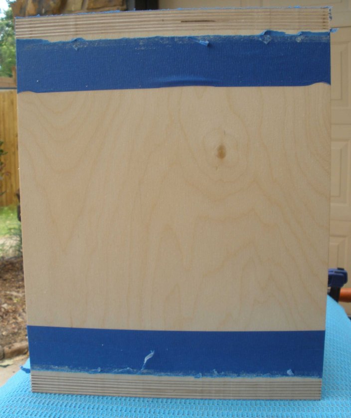

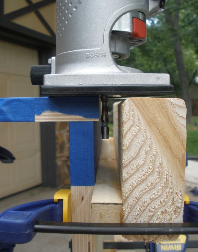

I cut the tops and bottoms a little wider to make lining things up easier then flush trimmed the overhang. Here is the jig I set up to provide more stability for the router
and here's after flush trimming but before any sanding. The painter's tape was to keep the bearing from marking the plywood.

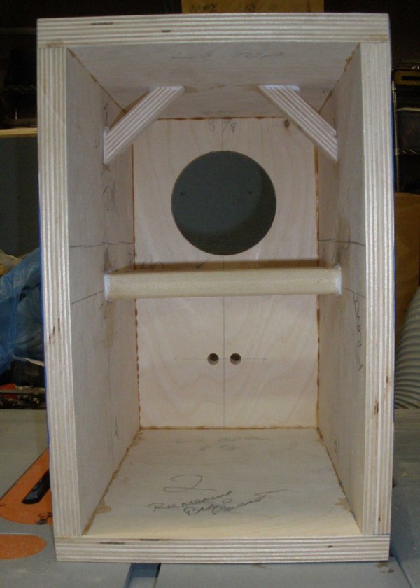

Here are the X-LS Encore cabinets with the bracing installed.

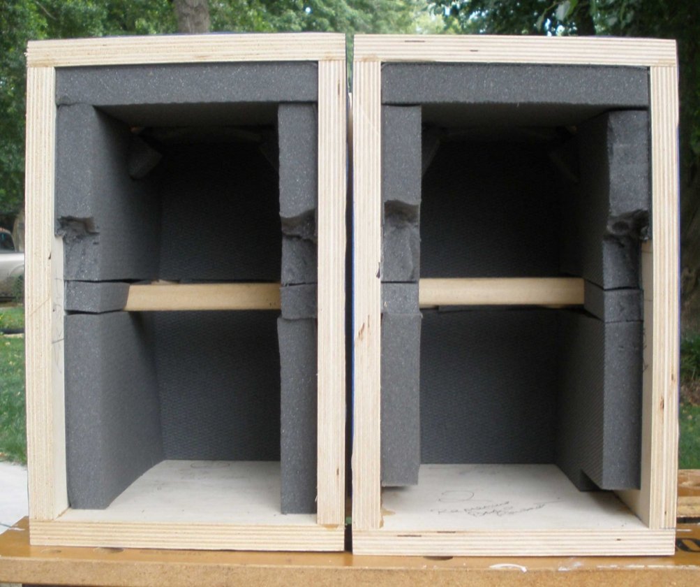

Now for a question. When installing NoRez on the sides, how close to the front baffle should it come?
You can come right up to the front baffle, but stay back about 1" or so from the front baffle around the woofer. You don't want to block the woofer in with the foam.

   I usually keep the No-Rez back 1-1/4" to 1-1/2" from behind the front baffle  which works very well.

I've installed most of the NoRez. I brought the top part around the tweeter out to the front baffle and left the lower portion around the woofer 1-1/4" back from the front baffle. I have to cut out the part covering the port openings and the tube connector openings.

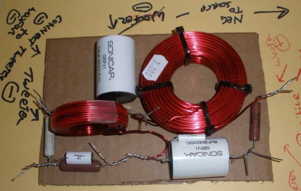

Thanks. I have been experimenting with cardboard as a layout substitute board. I had gotten it onto a 4-3/4" x 7" platform but by scooting the resistors all the way to the edge it would fit on a 6-1/2" board. I'm not sure if I have this layout right or properly distributed.

After looking at the crossover layout a little more it looks like I could rotate the largest cap 90 degrees counterclockwise. This would have all the caps aligned in the same plane and allow me to move it more toward the edge of the board. This would then allow me to move the smaller inductor more towards the center of the larger inductor.

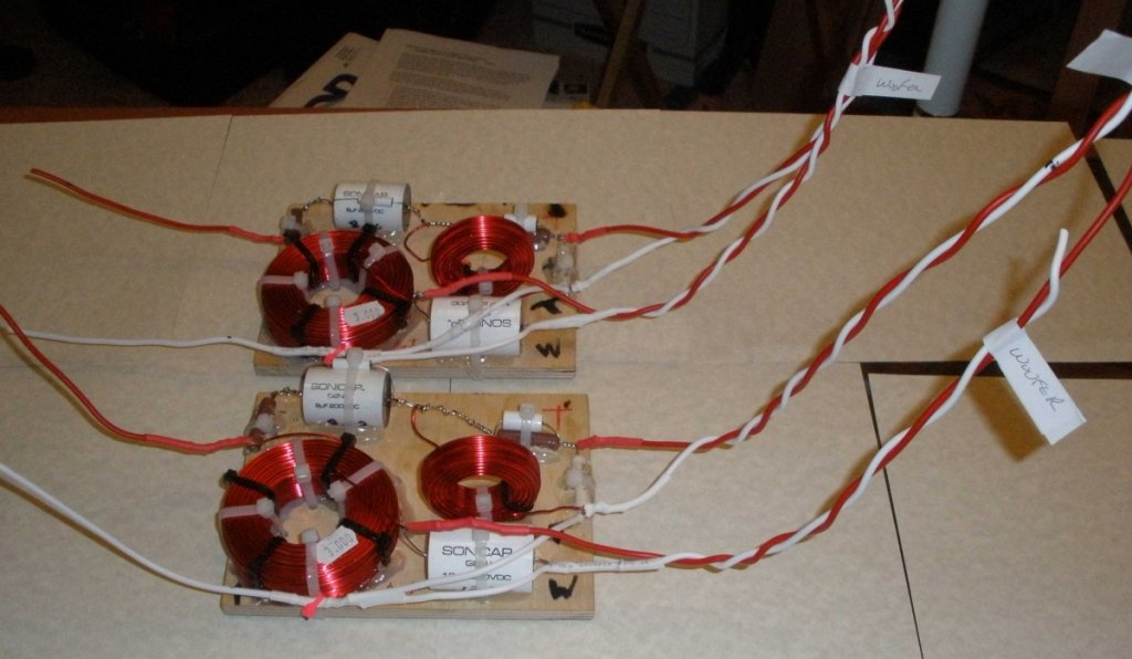

  The following pictures show a pair of crossovers I built for a pair of N2X speakers:
  The X-LS Encore crossover uses fewer component parts can be laid out in a similar arrangement as the N2X. The board size is 4-3/4" W x 6-1/2" long. I have found that a scrap piece of laminated wood flooring like Pergo works very well as a crossover board. I agree with Jay that the small piece of No-Rez in front of the crossover really isn't necessary.

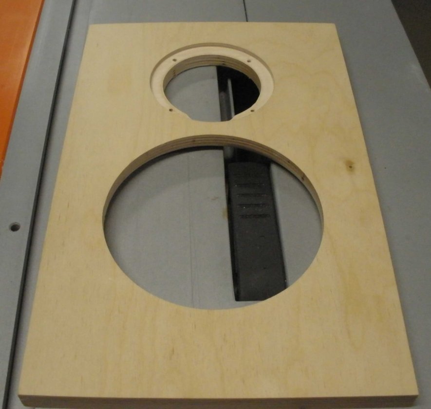

I also have the front baffles ready to attach including a 1/2" roundover on the back of the woofer cutouts.

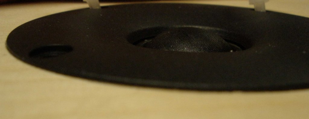

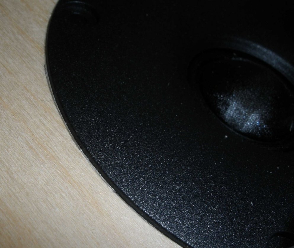

You will notice the mounting holes in the front baffle. I cut the recess too shallow so the tweeters sat proud of the baffle face.
I had a heck of a time sanding them down enough so the tweeters sat flush.  Later I was reading an X-LS build thread in the GR section over at HTS and found a tip to quickly and accurately set the recess depth first time every time with no measuring. The trick is to use the flange to be recessed as a spacer. Start by setting the router so the bit is flush with the bottom of the router base. Then raise the depth stop rod out of the way. Now place the flange to be recessed on the depth plate of the router and bring the stop rod down on top of the flange. Tighten the stop rod and you have the depth set perfectly to recess that particular flange.  A picture shows this much better so check out post #59 in this build thread:
http://www.hometheatershack.com/forums/gr-research/61533-giant-killer-build-6.html
