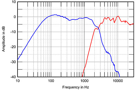

For a bit of perspective, here's a shot of a 2-way using an 8" Vifa NE225W-04 crossed to a waveguide loaded Dayton RS28A tweeter at 1KHz.  This was with a 10W input for roughly 98dB@1m output.  Distortion across the band from 100Hz on up remains below 1%.  (the blip at 130Hz is due to boundary conditions)
And here's a set of off axis plots of the same setup but using the silk dome version of the RS28.
These are very good drivers even if somewhat "budget" level, and they are delivering fantastic measured performance by any objective standard.
The ATC mid is indeed very good and measures exceedingly well.
Here's a distortion plot of that dome taken by John Krutke.
On the other hand, here's a distortion sweep of the Tang Band 3" dome also taken by John under the same conditions.  Notice especially the reduced 3rd harmonic content compared to the ATC above 500Hz.
I only post these plots to show that while the ATC speaker may indeed measure well, it is by no means "at another level" compared to more budget drivers available.  And while the off axis response of the ATC may indeed be good, it is certainly no better than the 8" 2-way plot posted above.
