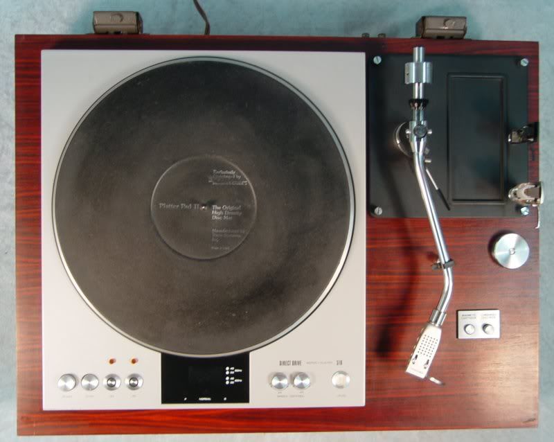

Woodsyi,
I must admit I'm more than a little surprised.  A new Aesthetix Io costs around $25K.  I was thinking you probably had a SME 10, HRX, or at the least, a Classic.  That's totally cool, and look at the size of that plinth.  It looks like a trap door on the armboard next to the arm.  15 lbs of clay no less.  Bet it sounds solid as a rock.  Separate rig for mono?  What's that Encounter arm?  Sure doesn't look like Origin Live.
Glad the Toshiba is working out.

Woodsyi,
neo
I am running 3 tables.  Io is with Teres.  Toshiba is the dedicated mono player or will be once Gary delivers on the phono stage.  Hope his health is better.  The arm in the picture is the original which I removed -- had to desolder the hard wiring inside.  There was a lot of hollow space under the plinth.  I bought a few lb bars of electricians putty and had to run out and hit 2 Home Depot stores (as one ran out) to get all the putty I needed to complete the job.  It's solid now.
