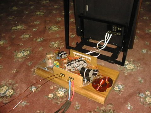

DIY version- really quite simple, no circuit changes just better quality parts -

No, I soldered them myself just following the original circuit diagram. Both sides took less than a day to build, with another half day opening up and rewiring the speakers.
Back in the day, when little things meant a lot, I thought the upgrade was well worth it. But when I look at the performance of my present speaker, the Carver Amazing, I think the money I pumped into the 3.6's was probably a waste. I had almost $6K into the 3.6's and my Carver's are more satisfying at well under $1K. (though the ribbons do need to be rebuilt at some point, which will double my investment - still worth it IMHO).
I wrote-up the project and here's an extract from it with the pertinent info, for what it's worth:
Choose a XO board of suitable proportions. I used two 24" X 12" X 2" solid Mahogany boards, but would have appreciated another 2 or 3" on both length and width to allow better spacing of the components. This sounds like a large board, but your new XO components and going to be much larger than stock, so you will need it.
Plan on removing the back-plate from the circuit completely. Rewire the speakers internally and take leads from the 3 drivers through the back-plate cavity and terminate the leads with good quality spades. I used Nordost flatline cable throughout and AlphaCore solid silver spades. I left 18" on the leads from the point of leaving the back-plate. I didn’t use spades inside the speaker, I drilled small holes in the ends of the Nordost wire and used the actual speaker wire as the crimp.
The leads will now terminate on one side of your new XO and I used good quality Cardas binding posts available from www.dedicatedaudio.com You will need a total of 10 sets of binding posts, around $400 if you use the Cardas design.
I built the new XO using the same value components as stock but selected better quality items. I used Solen fast-caps for larger values, Kimber for the mid values and Jensen oil/paper caps for the smaller values on the tweeters. I used Solen iron-core inductors for the bass, and AlphaCore air-core inductors on the mids/highs. (www.madisound.com)
I used Cardas silver solder and flux, and believe me, it makes life much easier than the Ratshack stuff that doesn’t stick to anything other than the carpet. (www.dedicatedaudio.com)
I used DH Labs wiring through the XO www.madisound.com
Building the XO’s is relatively easy, though some of the soldering maneuvers are a little tricky, particularly where 8 caps need to be wired in parallel.
I experimented with isolation under the actual components with great results, so it’s a good idea to leave a little slack on the point-to-point wiring to facilitate this. I tried Vibrapods under components and also foam. I found the best results were attained with packaging air-bags, but they are a real pain to work with.
I used brass cones on the underside of the XO bases and spiked them into the carpet (www.supercellaudio.com)
The end result is worth the effort. After around 2-300hrs of break-in, the sound is better in every possible respect. The deficiencies associated with the stock 3.6R speaker are almost fully addressed. Dynamic impact in the lower registers is greatly improved. Bass is more extended, tighter and more tuneful. The highs are effortless and extended, without sounding as shrill.
Transparency is greatly improved, as is stage presentation, particularly depth. There is a much-improved sense of layering in the soundstage with air around instruments/performers that just wasn’t there to the same extent previously.
The total cost for the XO upgrade and speaker re-wire was in excess of $2500, so it falls outside the scope of being a ‘tweak’. But it performs beyond its price, at least when taking a typical audiophile perspective on things.

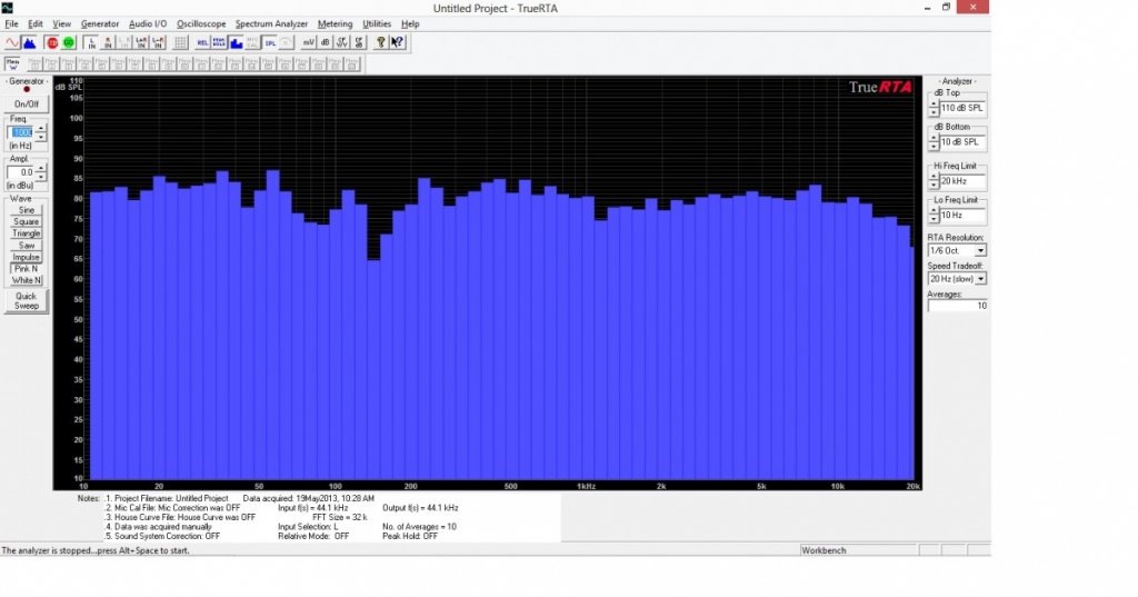

I just got back from calibration my measuring mic and ran a quick sweep this morning and things are looking pretty good
This is 10hz to 20k hz  most of the 50hz  hump is gone but a couple suck outs at 80-90hz and 140-150hz

What are you going to do to tackle that?

A suckout at 80-90Hz could be due to the distance of your bass panels from the front wall.  Are they just over 3' out?  (1/4 wavelength cancellation.)

Yes about 3 feet.
Am I right if I just move them the suck out point wikl just nove to another freq

Yes, correct ... unfortunately, simply physics!  :cry:
So - if you don't like the sound where it is - what you try to do is move them out so that the "placement dip" occurs at 50-60 Hz, where you will see, if you put 30-100Hz tones through them, the bass panel has a resonant peak before dropping off sharply.  So around 5' out.
