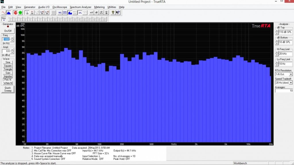

Moved panels one foot further out and got a better plot (still evaluating if it sounds better/different)
So the inside edge of the bass panels are 6ft 6in from the flat portion of the front wall and the center of the bass panels are 6ft from the center of the truncated corners
Ribbons are on the outsides because of the only 12ft width and I feel this gives me the widest image
I think this is pretty good since you are looking at 10hz to 20khz

I am pretty sure this is a room problem and cannot be fixed by adding more drivers.  My system is basically flat from below 20hz to over 10k hz with a gentle roll off above that.
I have found most tube rolling only changes the character of the sound at best.  May add some extension at the extremes which I do not need.  I am most happy with what I am getting out of my system. I did more critical listening on Sunday with the Maggy's out 5 1/2 feet from the front wall.  I actually lost some depth so I need to adjust toe in (or out) AGAIN!
