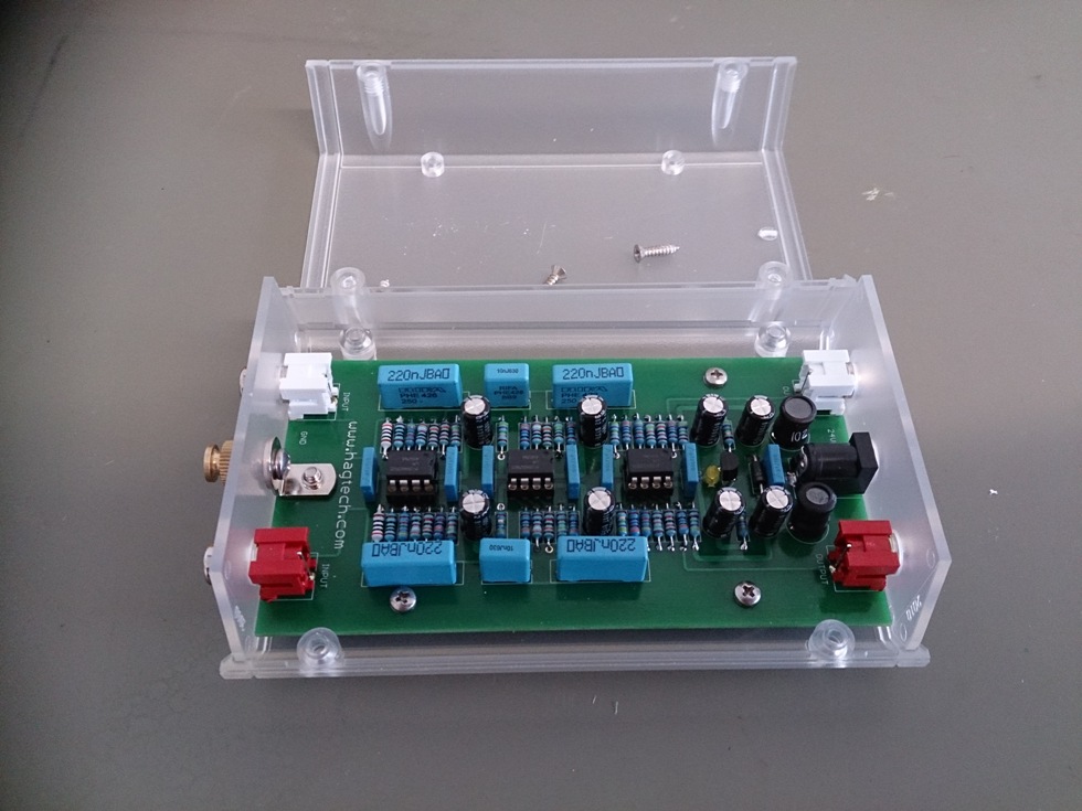

« Reply #8 on: 26 Aug 2013, 11:31 pm »
Since the picture was taken I have altered the gain to 54dB and changed the output IC to a pair of OPA627s, this has improved the bass quite a bit.
I now prefer this over my Marshall Leech pre pre into my phono input on the Copland.
