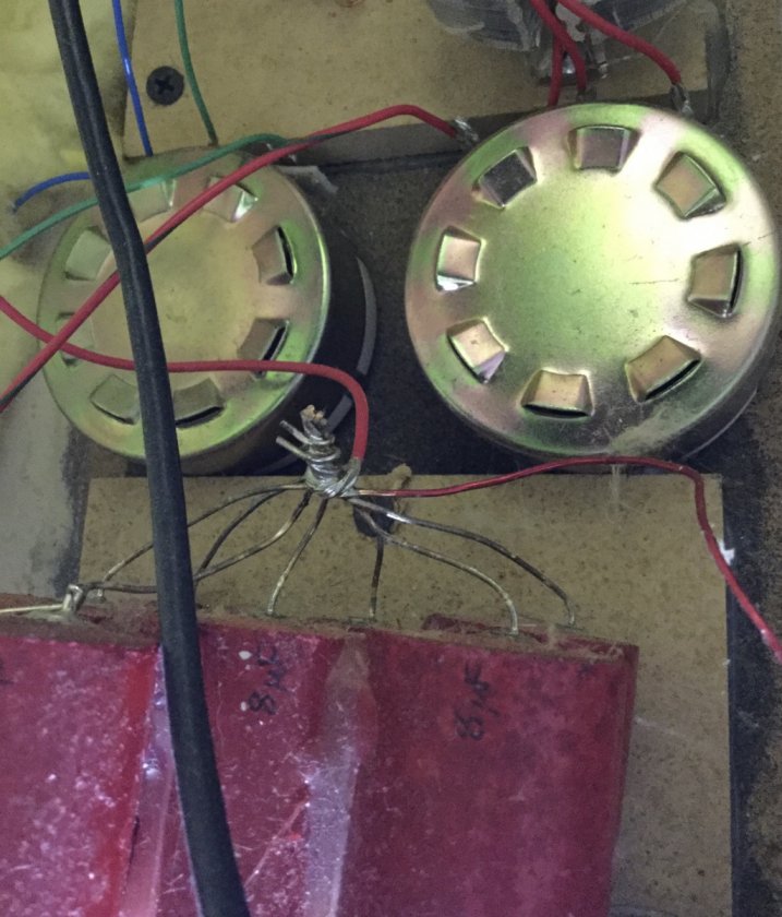

I pretty sure this is the L-pad (#260-265 , 100watt, 1” shaft,  8 ohm ) for RM 40, both L-pads in my 40’s are the same (100watts). But you still want to check what Brian used in your speakers. Good luck Zak
https://www.parts-express.com/speaker-l-pad-attenuator-100w-mono-1-shaft-8-ohm--260-265
The best way to access the L-pads and crossovers is to lay the speaker on it side and remove the base and the passive radiator.
Pictures of RM 40 L-pads and crossover
Left L pad for tweeter ( green and blue wires )
Right L pad  for midrange panels (red and red/green stripe wires)
Thanks for the pic and info, Zak.  So the base plate (looks like MDF) comes off?  I just assumed it was glued.  In fact, it all looks like MDF around the bottom so I assumed it was all glued together permanently.  Especially since the fully loaded cabinet weighs in at 240 lbs.  So it's screwed / bolted together?

ZAKski288
Re: VMPS Inventory available
« Reply #213 on: 31 Oct 2019, 12:55 am »
Hello Stehno,  This is want I would do. I taken a large bedroom pillow placed on the floor, two feet from the bottom of the speaker , I then grab the top of speaker  and tilt it down. Now the speaker is on a tilt we’re the base is off the ground. There are a bunch of holes in the base, but the 4 large holes hold the base , 4 long wood screws, unscrew them.  That removes the base. Now unscrew the 8 screws on the passive radiator. You may have to pry the passive from the cabinet gently. Good luck ZaK
« Last Edit: 1 Nov 2019, 02:25 pm by ZAKski288 »

Sometimes they can even burn the cabinet.
In any event, I would change them out on BOTH speakers, as the burned windings will reduce sound quality.
Brian bought them from Parts Express often, and they are very inexpensive.  Best plan is to see if you can get the part number from yours, and take a picture on your phone to sent to Parts Express.
Remember, they have been "hot glued" into position, so be VERY CAREFUL to slowly pry them lose.  Take your time, or you may damage the cabinet.  When you Glue the new L-PAD in place, take GREAT CARE to position it so that 12:00 is at the top.
Also be very careful to mark the wires and what each was soldered to.  Again, a phone photo can be helpful.
Also as a resistance device, the more "wide open" you run them, the lower the resistance and heat created.  I always ran mine hot (like 1:00 or 2:00)  Brian generally ran lower than that, but seldom blasted.
