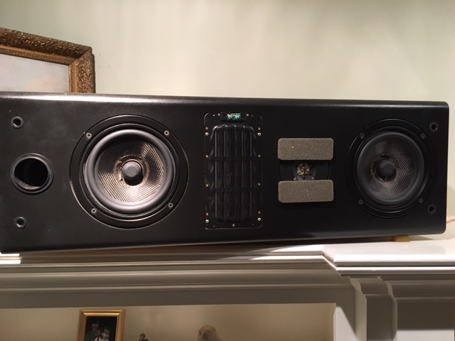

I have break-up in the midrange or tweeter in one of my two LRCs, used on a bookshelf. I'd be interested in buying a pair of both the midrange panels and the spiral tweeters or suitable alternates as available. Any help would be appreciated as I really love these speakers. Please see photos attached.
Thanks.
