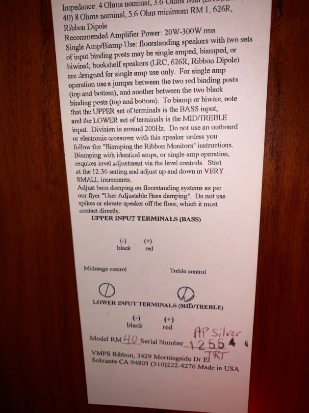

John, while I have your attention, I'd like to ask a few unrelated questions if I may based on the label above.
1.  At the very top of the label it looks like Brian is listing the RM-40 model as 8 ohm whereas I always thought these were 4 ohm.  Can you confirm?
2.  I used to bi-wire these speakers but no longer.  My speaker cable runs are routed from the amp to the lower terminals (mid/treble) and the jumpers carry the signal to the upper (bass) terminals.  From a sonics or overall best musicality potential would you consider this the proper config?
It says 4 ohms nominal, 3.6 ohms minimal for the RM-40 if you look closely.  It is the RM1 and 626R that are 8 ohms.
That connection pattern is fine.

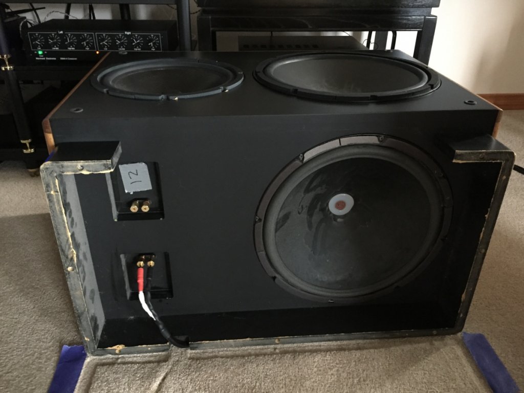

I have a 30+ year old pair of VMPS Large subs that I finally got out of storage only to find the down-firing 15" passive radiators were rotted out.  The front mounted active drivers are fine but the speakers only go down to about 30hz in their present condition - certainly not the room shaking like they used to.  Does anyone know where I can find a pair of passive radiators?  I'm assuming to replace them I have to remove the 15" active speaker and will the passive fit through the hole?
Or should I just upgrade to a pair of JBL 18" per side?

Thanks Js.  I don't see how I can fit the new 15" passive radiator thru the bottom slot as its 4.75" tall and the slot is around 3".  Does the bottom of the enclosure come off?
Maybe a picture of your subwoofer is in order to assist?  This is a picture of the Larger Subwoofer's from VMPS legacy site:  http://pointillistic.com/vmps-audio/subwoofers.htm and what mine looks like.
Maybe you have a tallboy Sub?  Which looks like this:  https://www.audiocircle.com/index.php?topic=122314.msg1832169#msg1832169 If so, the base should come out by removing screws to access the passive speaker.

tj309 , so you have the older tallboy ( larger ) there should be 4 screws to remove the base, so you can access the passive. I have the smaller version, and mine is screwed together.
tj309
  • Posts: 7
Re: VMPS Inventory available
« Reply #233 on: 26 Nov 2020, 09:02 pm »
yes that is the one I have (in the above pic).  I've never seen the bottom of them but will tonight.  Thanks!

The bottom easily came off with the removal of 8 fairly hefty screws.  Easy replacement thanks to the link a couple of posts above.  Thanks!

I got a pair of 15" passive radiators from Parts Express and to get them in I had to cut a bit only to find that they don't fit the hole.  I need to enlarge the hole by about 1/8" all around.  That is going to be very difficult even for an accomplished woodworker such as myself as one cannot get power tools into the box to do the surgery.  It may have to be a total sanding job with a drum sander on my drill ...  what a pain!
