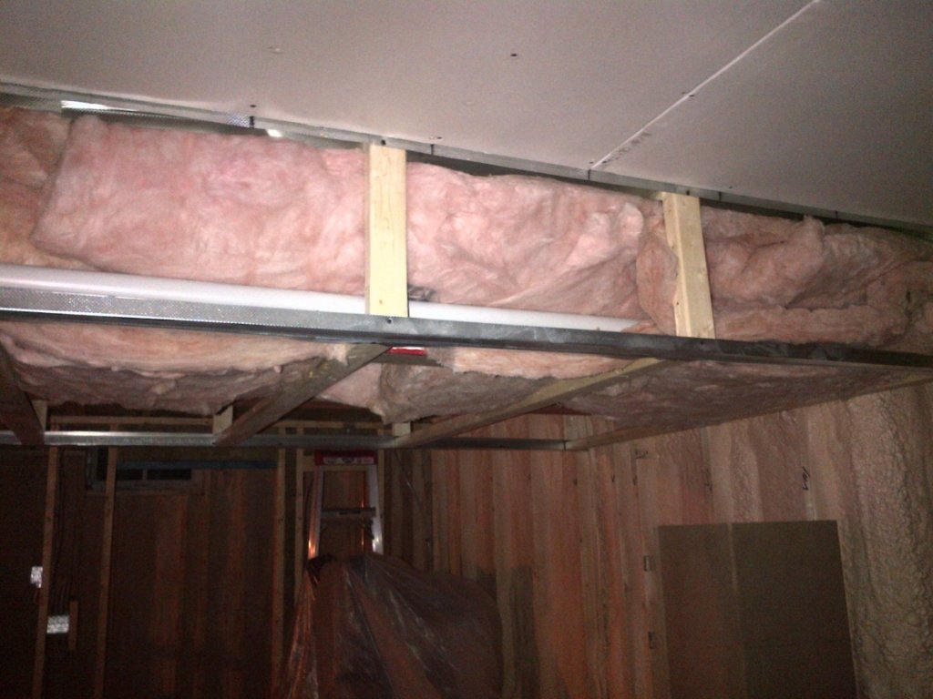

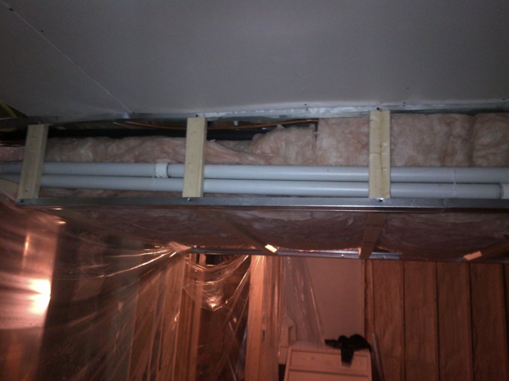

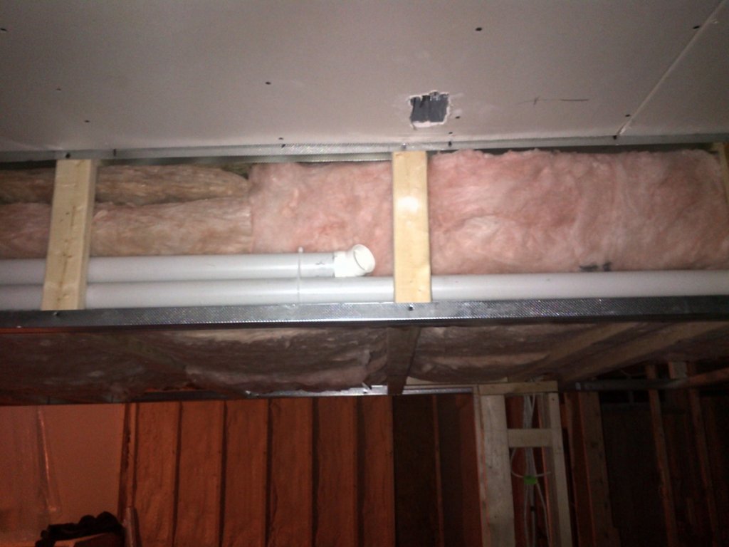

Cut, joined and installed the 2 runs of LV conduit.  One to the future PJ location, and one all the way to the display wall.
Stuffed 100 ft2 of pink insulation around the HVAC inside the bulkhead.  Banging my finger against it has changed from a mid ranged bonging noise, to a dull thud.  Hopefully that helps keep sound out of it.
Props to bpape for suggesting pink for this, at 1/2 the price of the Roxul!

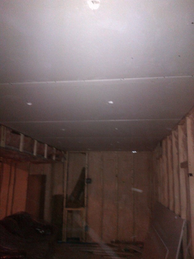

One third of the 5/8ths drywall is up on the ceiling.  Will be big progress tomorrow with all the ceiling going up, and walls starting.

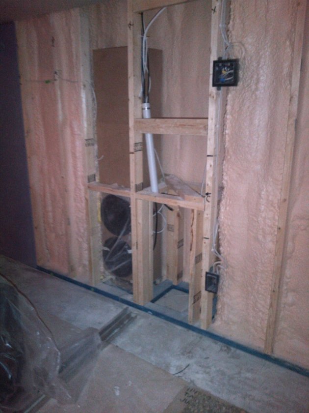

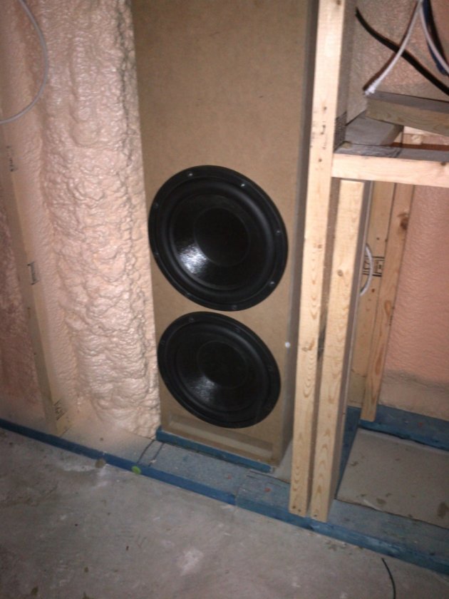

Subwoofer wired up, terminal cup installed, and it is tied into the floor inside the cavity.  It does not touch anything around it, so it should produce limited vibrations in there, and free up considerable floor space.

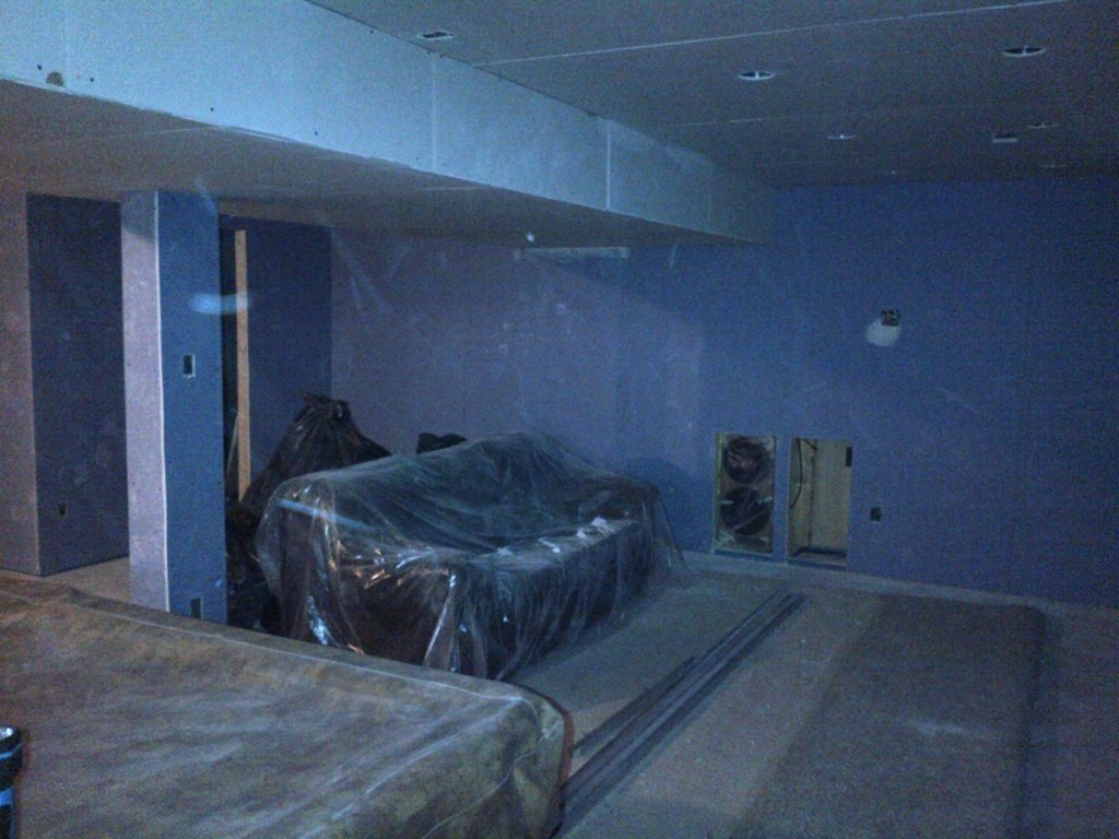

Most of the pics to follow as the walls are refined, will hide all the infrastructure.  Here is one last pic of the framing around the subwoofer, and the built in under what will be the display.
I taped plastic over the woofers, and the port since the dust down there is bad, and will only get worse during mudding and taping and sanding.
You can also see a piece of conduit I installed that will allow me to run wires from the built in, up to the display.  I will cut in access points (with proper low voltage covers) once the work is done.
Above the sub will go a false cold air return, that when removed gives me access to both that short conduit, and the long one from the utility room to the display wall.

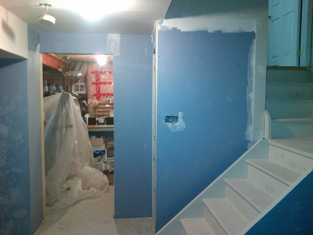

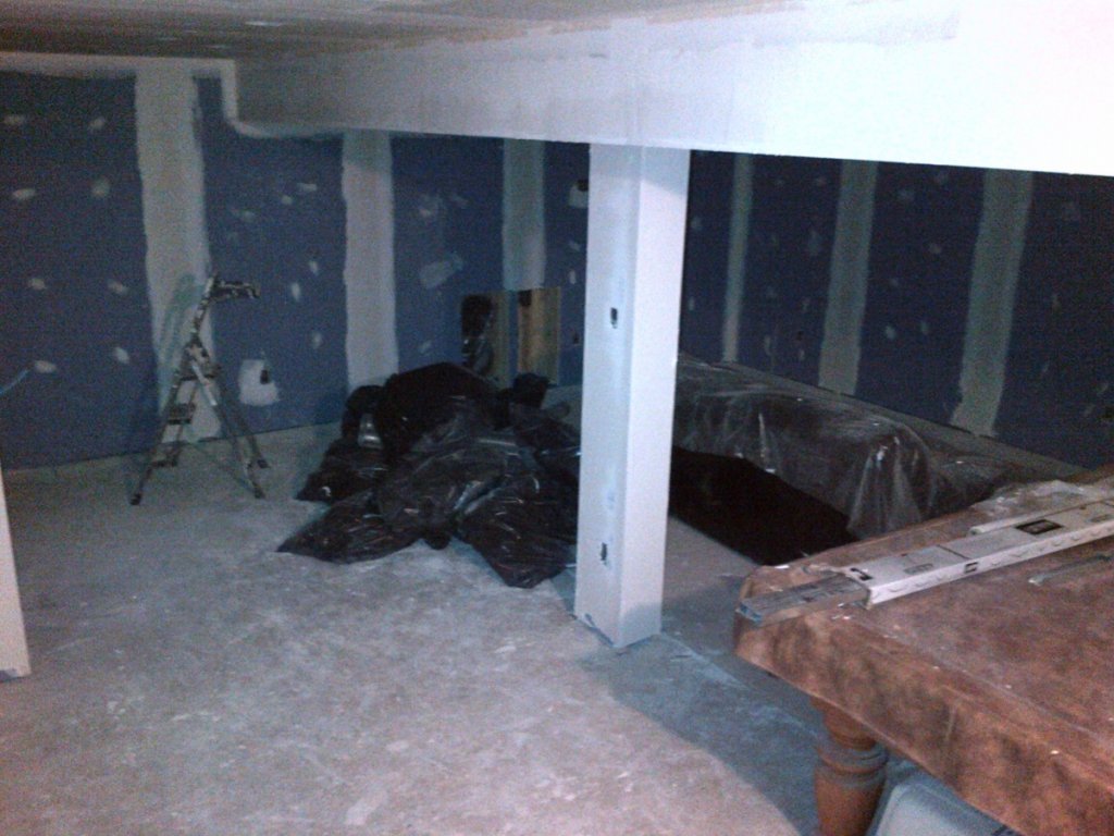

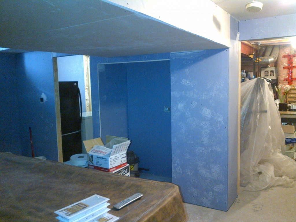

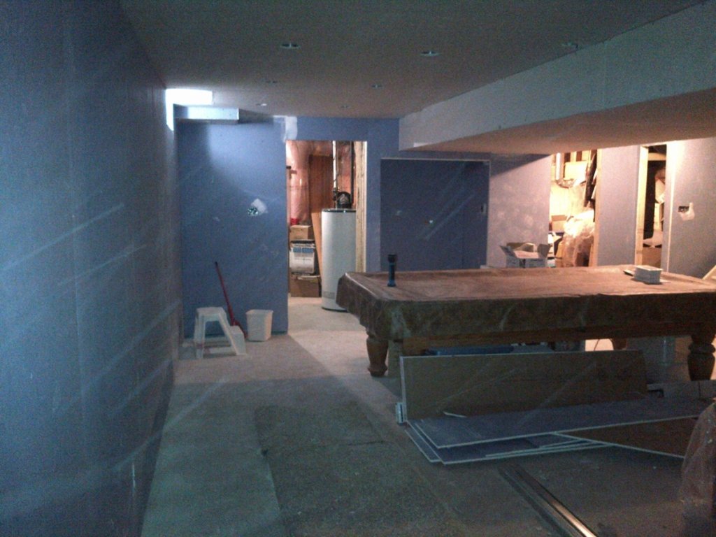

The drywall is up in the area to be finished.  A couple of pieces still to be put into the bathroom, and on the utility side of the dividing wall.  Work to be done this week in the evenings around mudding and taping.
Pic below shows the dividing wall including both doors into the utility area, and the built in by the pool table.
This is a shot from the HT area, back past the pool table towards the dividing wall.
Here is the outside of the media closet, by the stairs.
Lastly a shot from the pool table towards the HT area, where the display will be on that far wall.

I am not that concerned about completely burying the sub in the wall.  I will be able to service it through the rectangular cut out (ie replace drivers in the future if something goes wrong), and ultimately if it blows up completely and I cannot fix it, I will just remove the grill and drywall over it.  My current DIY sub in my main floor 3.1 HT has been in constant use for 10 years now, with no issues, other than 1 amp failure.

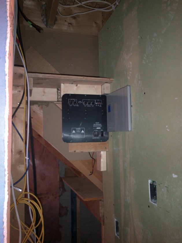

Note that the woofers and box are buried in the wall, but the amp is in the media closet.  I wanted to be sure I could still replace or upgrade the amp easily.

Here is a shot of the media closet wall with all the power buried in it now, and the sub amp hung in there too.  Still dark, as the switched light in there won't be in until all the electrical is truly complete, in around 2 weeks.
