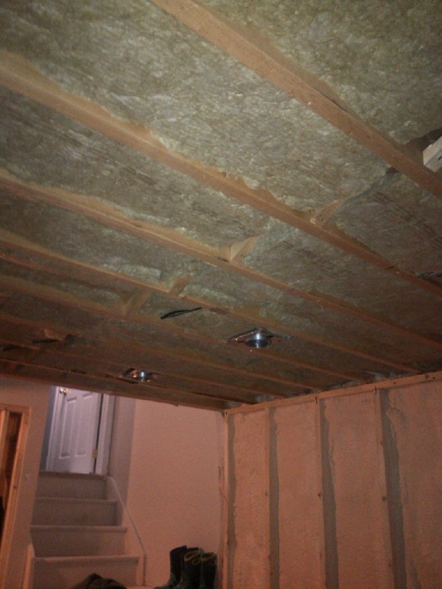

« Reply #68 on: 3 Mar 2013, 08:21 pm »
The majority of the walls were framed 1 inch off the foundation.  The one wall where the display will go was framed 2 inches off.  The foam is behind them all yes.   It is 2lb closed cell, so theoretically 6 per inch.  Potentially 12 for what I have had installed on the walls.  4 inches or so was blown into the joist headers, where I understand the majority of heat loss actually occurs in our climate up here.
One memorable Holmes eposide was him with the infared camera, poking at folks using steel studs in exterior walls.  He said if you want to use them, use them on interior walls, so that was also after the one where he must have got in some hot water for the commentary on them.  I like the show, and know that he is over the top.  I like all the HGTV shows, and am much more comfortable overseeing work, and taking on the odd job myself having seen them.
My electrican says that an apprentice must have wired my home, he had to rewire a bunch of things on the main floor as the lines from the basement were tied into stuff up above.  Glad it was taken care of, and looking forward to watching a movie down there some month!

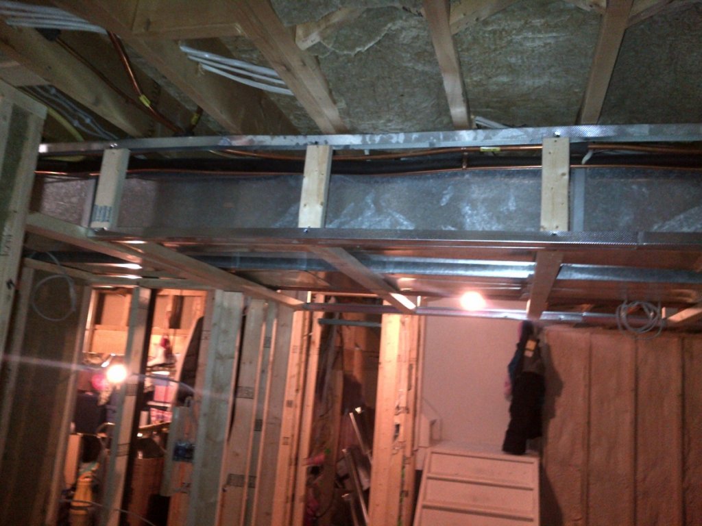

Below is a shot of the ceiling.  I have finally finished putting up the Roxul.  Glad that is over.
I still have to insulate pieces of the interior walls, and will insulate the bulkhead once that is built too.

I'll bet that room passes 'the clap test", right about now.  :thumb:

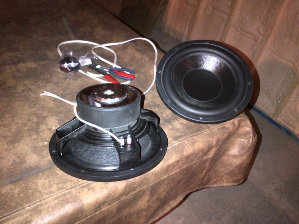

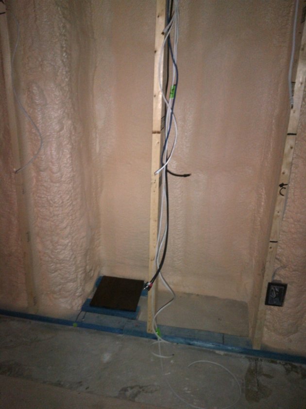

Spent some time measuring and dry fitting that sub into the wall, will fit fine and I can also generate a small built in shelf beside it for a Wii or whatever gaming console my kids want.

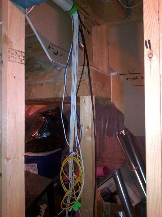

Added more wiring for futureproofing.
The bulkhead/soffit is now WIP.

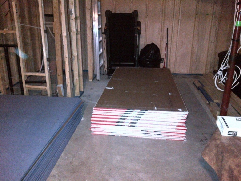

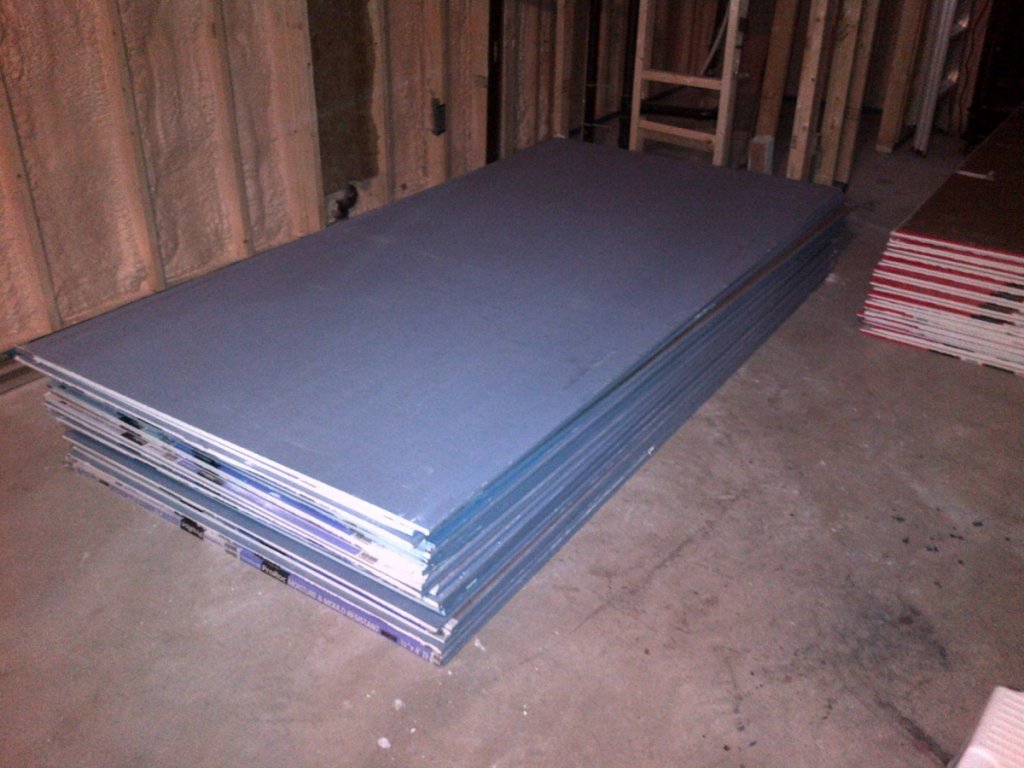

Drywall arrived today, was well worth it to pay a little more and they carried it all downstairs.  That 5/8ths stuff sure is heavy!  The blue stuff is the 1/2 inch mold resistant that will be all walls, while the 5/8ths is for the ceilings.  Drywalling both sides of the utility wall, not that it likely needs it, but my old furnace was really loud, so I am paranoid that the new one will suddenly start up.  Figure it is simple enough to do, and might as well do it now.
Here too is a shot of my wiring up the DVC subs, not in the pic is the multimeter, need to make sure I end up with 4ohms!
