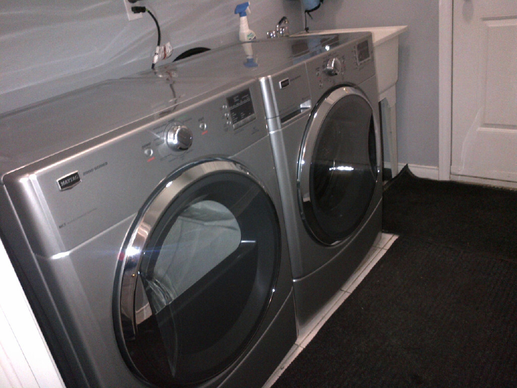

In case anyone is not sure what a 2K budget hit looks like, below is our new laundry team... The prior units lasted 10 years, and just gave up the ghost.
What fun it is to try to get through this project, having lost 10K to furnace, AC and laundry machines!

Sure are perty!!  :thumb:

A month ago we replaced our 23 year old Whirlpool washer and dryer with new units.
I think we got our monies worth.  8)
Yours look nicer than mine though. Very cool.

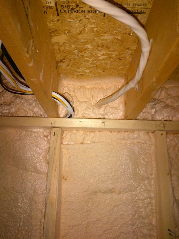

It is spray foaming day, here are some pics I took before the day begins.

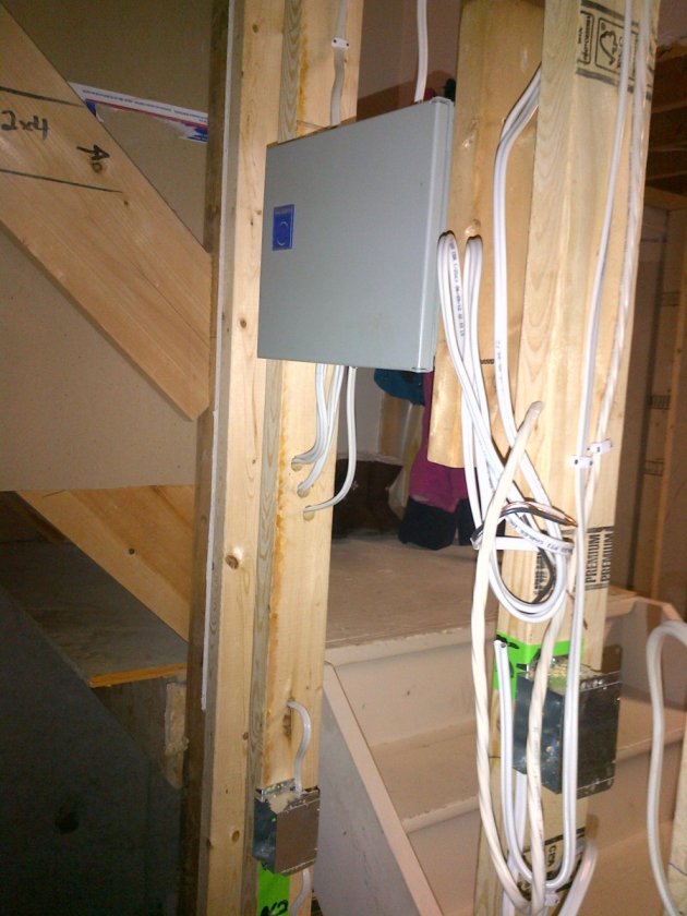

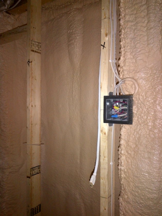

Here is some progress on the electrical in the media closet.  The wall that the pony panel is on will be finished on both sides, burying all the wiring.

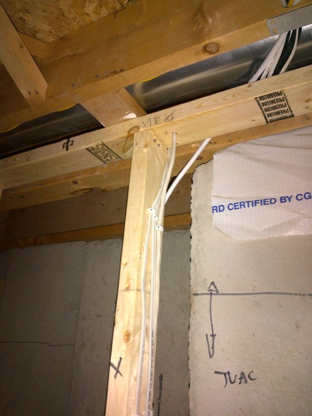

Below is a pic of my hieroglyphics - roman numeral stud numbering, Chinese character for middle, and some wall scribblings that were guidance for the electrician.  The foam will cover the wall marking parts, so I took lots of pics of where I had written stuff, including other areas where I had measured off the size of the display, speaker locations etc.
Lastly, here is a pic of some low voltage that passes through my basement.  Several HDMI's, some speaker wire, and a Cat6 drop (the yellow wire) that goes all the way from the upstairs HT to the media closet.  It will be encased in foam today, so I had to be sure I ran all I could think of...  The giant white wire is the AC for the hot tub.  I used to have one, but don't anymore.  Left all the wiring in place in case my wife makes future demands!

Funny how posting a pic makes it more "real".  In reviewing that last pic with the 240AC and the low voltage together, I went back downstairs and tied the AC to the next joist over, to help keep space between them.
Just for the future, no hot tub present today, so that line is dead but can be put back into service.

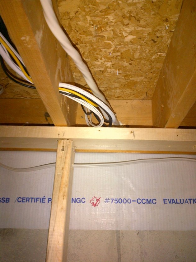

Umm...might now be a good idea to run low voltage wires parallel to 110.
"Crosstalk", EMI, whatever it's called.....
mcgsxr
Re: mcgsxr's basement build
« Reply #47 on: 22 Feb 2013, 03:35 pm »
There is no 120v near the low voltage.  The 1 inch wire is the AC for the hot tub.  I cannot move either the bundle, or the huge hot tub wire.
The hot tub line is presently dead, but can be brought back to life.
Below is a pic of how I changed it as best I can.  At the closest point, the LV bundle is now 5 inches from the AC line.
Best I can do.

It looked like Romex AC wiring was running along the CAT5 wire.  So it made some of us nervous that you might get some unwanted noise.
That's the one things us downunders always wonder about; once you spray foam, you're pretty much "stuck".

One of the 3 HDMI is a brand new white 1.4.  The 2 black ones are 1.3.  WOW the 1.4 is thick, and so it likely appears to be romex.
I could have put in a conduit into the floor in that joist bay, but it does not line up with my downstairs display anyway - so it would have meant cutting into the joists to run cable.
I decided I value continued structural integrity over future wiring for between the 2 systems.
I agree that once the foam goes in, you are basically stuck.  Plan well!
Yip, that's what I saw too. Good to know.  :thumb:

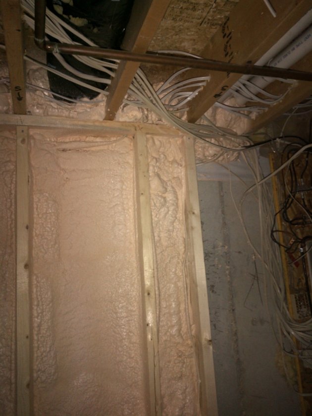

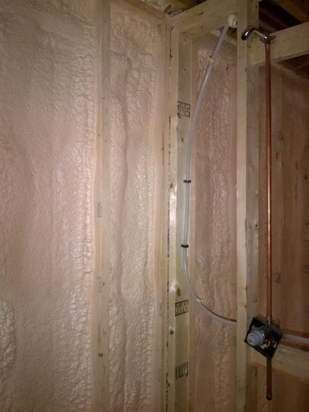

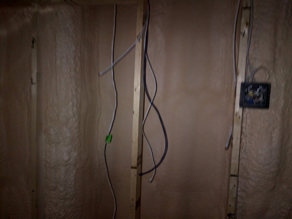

Below are some pics.  I am happy with the job they did.  There is evidence of 2-3 inches on all wall areas (spec was 2 inches) and 3-4 in the joist bays.  They managed to get into some tight corners where the framers did not leave a lot of space, and they were in and out quickly and cleanly.
It likely cost me 3x the price of batt insulation with vapour barrier and tuck tape and sealant etc, but I figure it does a superior job of creating a total vapour/moisture/thermal break, so I dediced to pop for it.
First up is a pic of the low voltage bundle by the hot tub AC line.  You can see that it is buried in the foam now, so I am glad I spent the time to tie it off how I wanted, and ran all the cables I wanted between the upstairs HT and the basement HT.
Here is a pic of the area where the display will go on the wall.  It is an angle shot into the recess into the foundation, which they sprayed top to bottom.
A pic of the exterior shower wall in the bathroom.
Lastly the wall inside the utility area that I decided to frame and finish - not finishing around the electrical panel, but up to it.  This is an exterior wall that my freezer and fridge sit against.  I figured it was worth doing that one wall in the utility room.

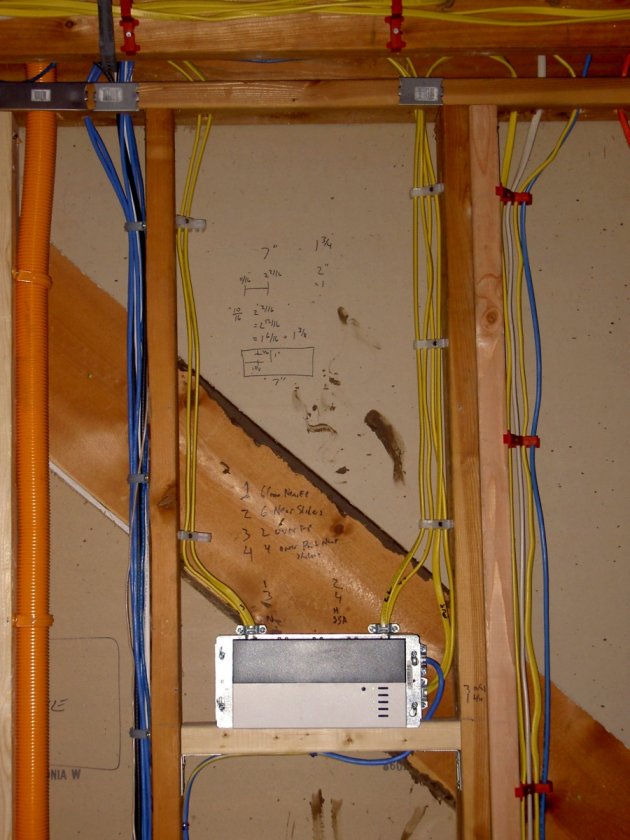

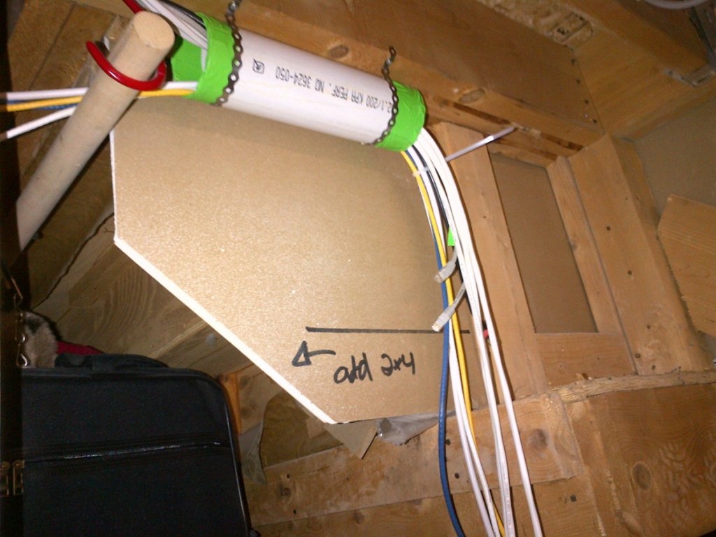

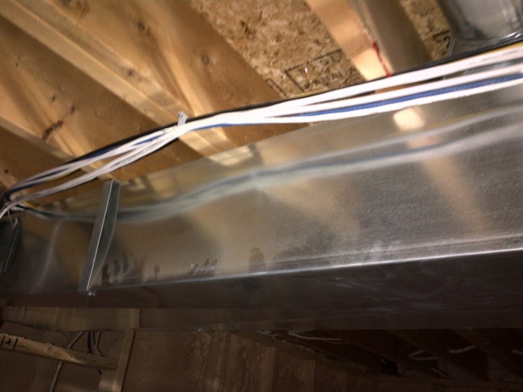

Pics below of some progress around running feeds to the display wall.  All the wires below are low voltage - some are RG6, some are Cat6, some are CL2 speaker wire.  I am about half done the LV runs.  Ran out of time tonight so I will have to complete it other evenings this week, juggling some work travel.
I am glad I decided to use some 3 inch perforated tube as the main conduit over the HVAC and into the media closet, it has plently of diameter to run all the various wires I need to.
I am hard wiring the various LV to the locations, and then will add conduit to 2.
I have thought it through, and will do a 5.1 in this room.  No point trying to force anymore speakers.  The location of the bulkhead and the pool table basically interfere with using height channels in the front, or more surrounds in the rear.
Here is a shot of the media closet ceiling, with the 3 inch conduit.
Here is a shot of some of the LV heading through the bulkhead, to the display wall.
Here is a shot of the display wall at where the panel would go.
