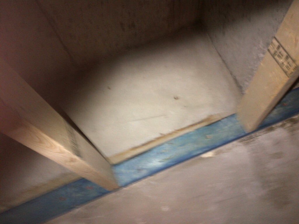

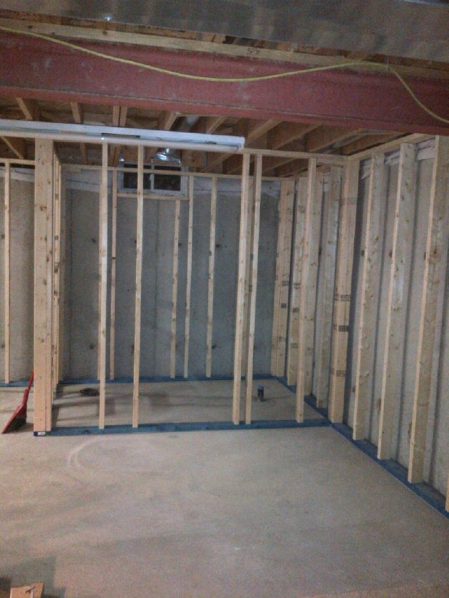

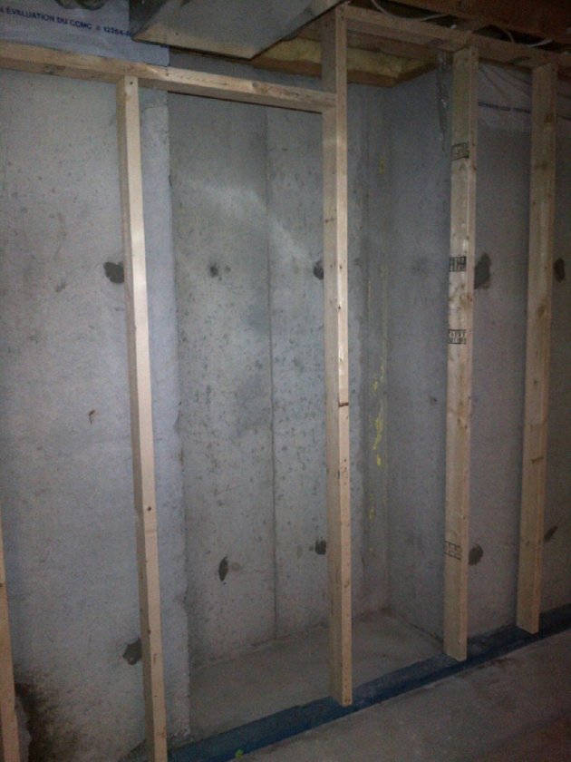

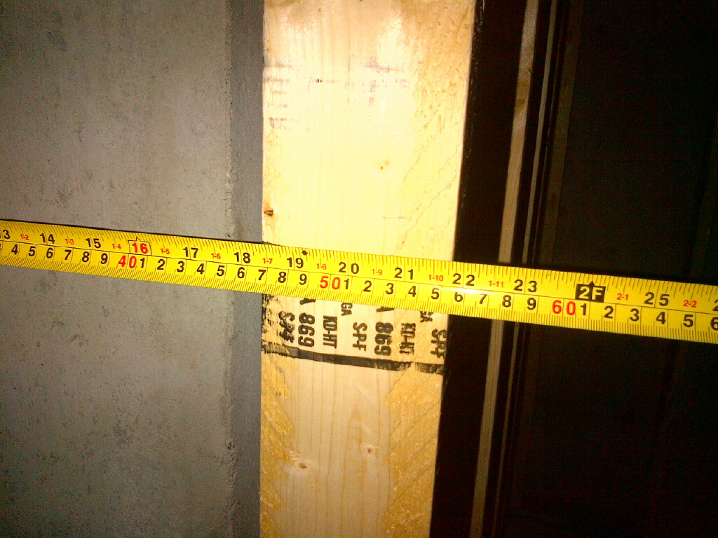

OK, here are a few more shots of the recess into the foundation.
It is 44 inches wide, and about 18 inches deep.  Once they spray foam the back and sides, it will be around 40x16 behind the wall.  Full height, so around 90 inches or so, but I don't intend to use the full height.
It will be mostly behind where the display will go, and partially hidden by the bulkhead on one side.
Hard to think what else to put in there BUT subwoofers!
I actually framed that wall leaving 2 inches behind the studs to the foundation wall.  2 inches of closed cell foam will be sprayed in.  By leaving this wall (where the display will go) 2 inches proud of the foundation, I can allow for in wall speakers if I chose.

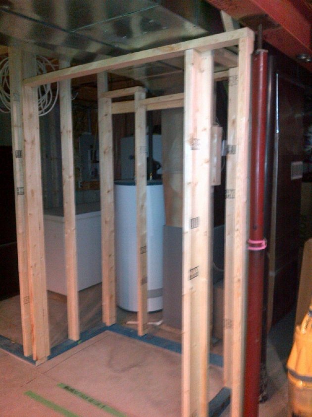

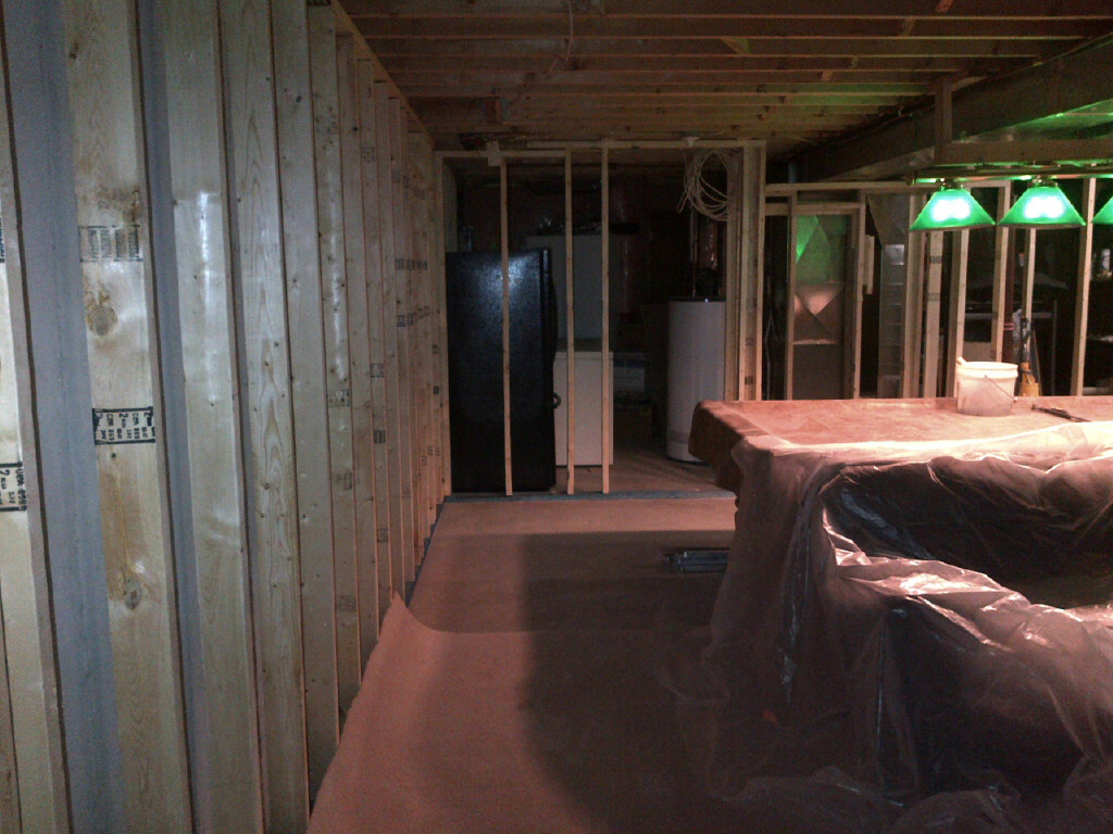

Ahem, OK bass freak shots aside, here are a few more of the general framing of the space.
This is a shot from the display wall back past the pool table towards the dividing wall into the utility space.  You can see the fridge inside the utility room.
Here is a shot of the recessed area beside the pool table.  I intend to put in cabinets with a countertop there - like a bar area but not one you go behind, just one you approach from the pool table.

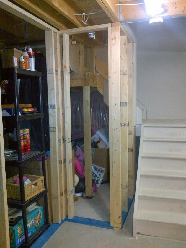

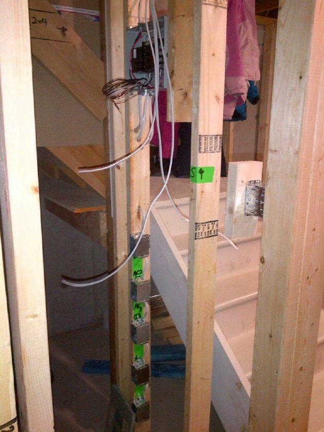

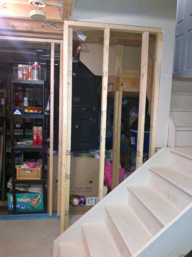

OK home theatre fans, this is the door to my media closet.  It wil allow front access to the gear.  The rear of the closet will remain open, allowing me to access the back of the gear in the future.
Here is a side shot of where the media closet is, by the stairs.

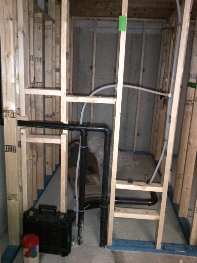

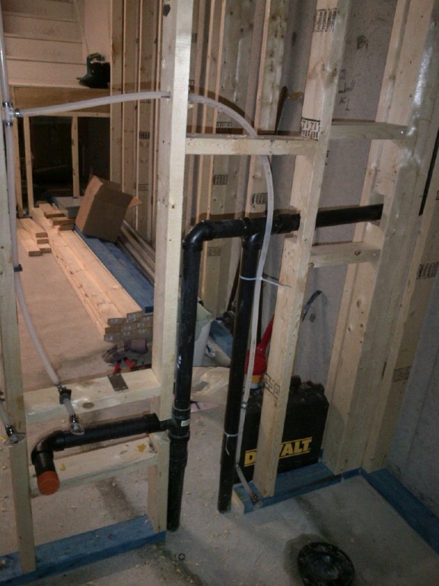

Plumbing final rough in for the bathroom finishing up tonight, I will post some pics.
Box of cables arrived today, so I can spend weekend hours finalizing my HT wiring runs.  Conduit will go in later, these will be the permanent runs of speaker wire, CAT6, RG6 and a few others.
Electrical starts in full force tomorrow, and spray foaming is lined up for next Friday.
mcgsxr
Re: mcgsxr's basement build
« Reply #29 on: 14 Feb 2013, 01:07 pm »

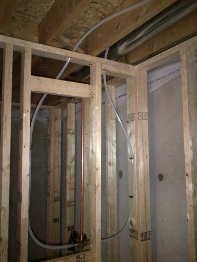

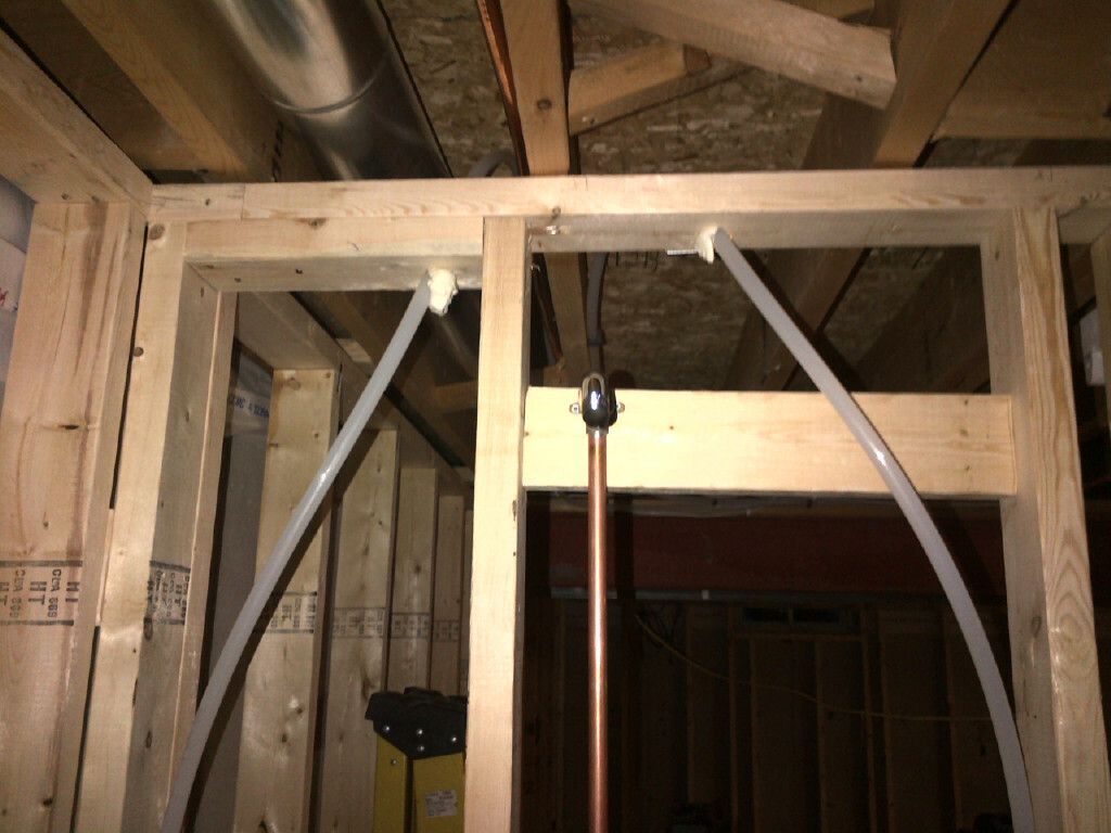

Pex joined to copper and distributed to the corner bathroom.
Below are a few shots of the finished product.

Don't forget to insulate the interior bathroom walls for noise reasons.

Solid advice.  I am the lucky bugger doing the insulation other than the spray foaming, so there will be Roxul in the interior bathroom walls, and the dividing wall into the utility area.

I had a problem with my washer, when i used speed wash, it really cuts on and off the water and the PEX that is in that area knocks hard.  I appear to have forgot to attach it all down.  I would insulate or spray foam around the holes that the PEX is going through to stop any possible knock when pressure is added/released on the system.  And yes, overkill is ok, you only get one chance at it and you don't want to be putting holes in walls.  Also, the extra piping for fishing wires is a plus for future stuff.

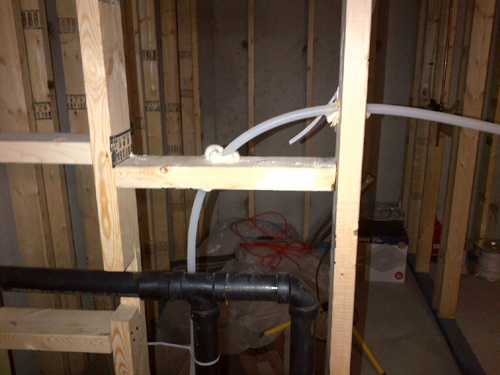

Proof I am not just reading the suggestions, I am following through!
Below are some pics of the spray foam added to the PEX in the bathroom plumbing.
Below is one shot of the electrical progress.
My sparky loves the 5 dedicated lines in the media closet, with about 3 feet of romex!  The other 3 lines head off to the display area, and one for the potential PJ down the road.  I am lucky the PO of the house was a woodworker, I never would have popped for the cost of the pony panel, and breakers etc.
