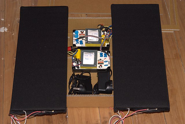

Here's what's in the box: two panels, two High-voltage units, two DC plugpacks:
The panels come with "socks" to protect them. For mounting in a baffle I will be removing it.

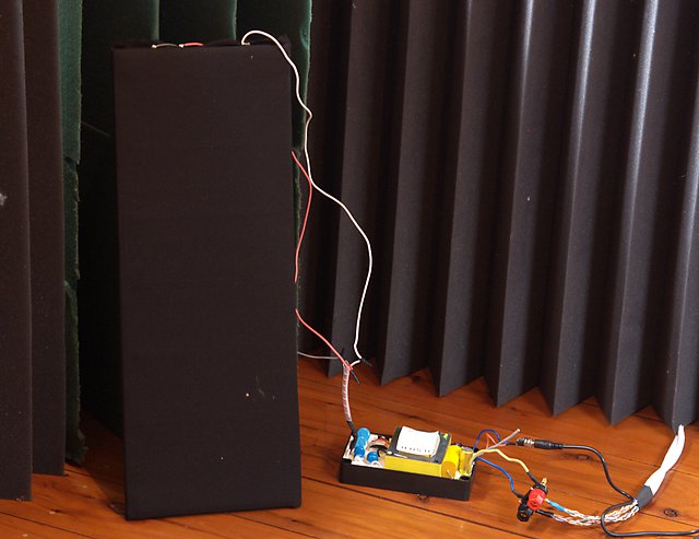

Not being the patient type, I had to have a listen. It didn't take long to wire the panels to the HV units and connect everything up. The HV joins are of course heatshrinked. For this quick run, they are sitting on the floor, leaning against some acoustic foam:
Very promising so far. The HV units include a highpass capacitor on the input to the transformer, it sounds to me like it's around 200 Hz. (I haven't done any measurements yet.) There's an unconnected lead coming out that you can use if you want to use your own crossover or connect directlly to an amp for an active crossover.
Next will be to biamp them with a dipole woofer.

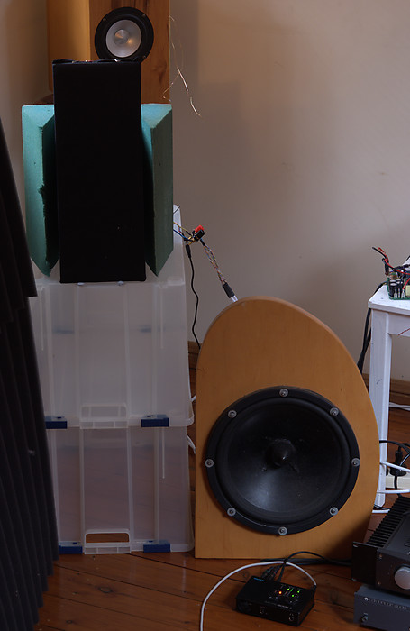

The next step in this experiment took longer than expected... I ran into some "issues" with adding in a dipole woofer. I thought I had some kind of ground loop, that there was something wrong with my crossover unit, etc etc. It turned out to be no more than a bad cable...  :banghead: :banghead:
With that out of the way, here's a picture of what I'm listening to right now:
Obviously, this is a prototype/mockup. The panel with the black sock really doesn't lend itself to photographs... anyway, you get the idea. Ignore the speaker in the background, it's not connected.
The crossover to the dipole woofer is at 500 Hz currently, I decided to be conservative until I make some measurements. The crossover is done by the MOTU Microbook II at the bottom of the image. Great unit for the price, I'm reviewing it now.

So you are running your prototype ER panel from 500hz to 20khz and the dipole woofer up to 500hz in a two way arrangement?
I am really curious to know more about the entire setup including the crossover you mention reviewing.

Sorry Nick, I'm practicing my hyperbole, it seems to be the order of the day around here lately :) :) I'm just excited that a quick prototype is working out so well. But I really should do it properly before making comments.
Yes, crossover at 500 Hz. The Microbook II has DSP onboard so can use it as an active crossover - http://johnr.hifizine.com/2012/10/03/motu-microbook-ii-highpass-and-lowpass-filters/
Hopefully I will get a couple of articles out of it. While the idea of a two-way is tempting, I think the best results will be a threeway: a bass/mid and this panel in the main panel, and separate dipole subs.
