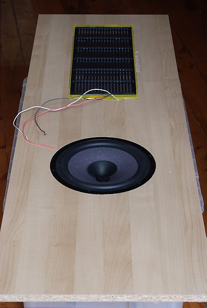

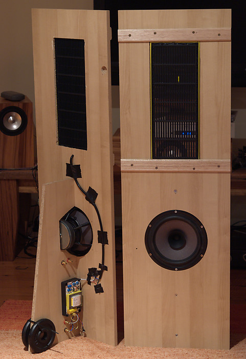

Hi Josh, these are just a prototype using cheap (or free, it was sitting in the spare room) material. It's not the material that's the issue it's me forgetting to add 12mm to the scale on the jig because of the router bit size. Anyway I'm getting there, the second one is much neater, should get the supports finished up today.I'd love to use BB for the final one but I haven't been able to find any.

Hi John,It seems you can order Baltic birch ply online, I'm not sure what the quality is like or whether these prices are reasonable, but I found some sources in Google:https://www.google.com/search?q=baltic+birch+plywood&ie=utf-8&oe=utf-8&aq=t&rls=org.mozilla:en-US:official&client=firefox-a
You're right! Found a place not too far from me, $128 for 18x1200x2400 plus delivery. Wil go have a look at it, he says it's B surface grade.
