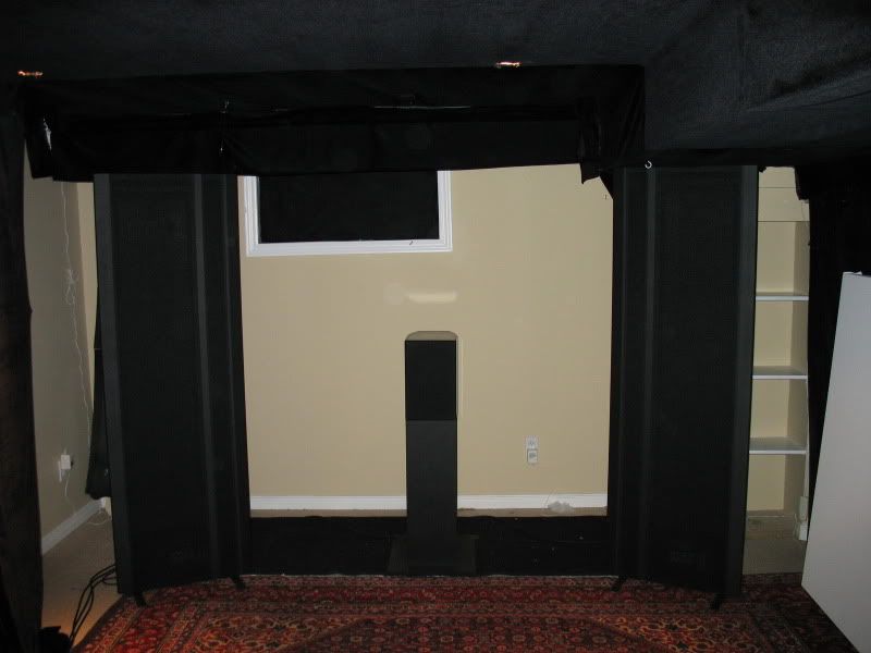

The question about room size is a good one.  I had 3.6's for years in a room 15' x 25' with the 3.6's on the 15' wall about 3' out from the wall and with about 8' between the insides of the speakers.  Tweeters on the outside.  The sound was divine and I still consider it my reference.
I was transferred by my employer and moved up to Canada and into a much smaller house that had absolutely no room for Mags so I sold the 3.6's.  I then bought a house that has a room in the basement that is 12.5' x 23'.  I struggled with whether this might be too small still but took a chance and got a pair of 3.7's.
Well, I'm sorry to say that I've been moving the speakers around for almost a week now and have yet to find the perfect spot for them.  Either the bass is right and imaging is out or imaging is fine but the midrange sounds veiled or midrange is clear and something else is wrong.  I am sure this is the room and not the speakers as I know just how wonderful a properly set up pair of Mags can sound having owned various pairs for all but the last five of the past 20 years.  Compounding the issue I think is that I've got a shallow built-in in the front right corner of the room and the left wall of the room has a fireplace and built-ins sticking out a foot or two starting around 6' from the front wall.  I've got absorption at the 1st reflection points and used to have absorption on the front wall but found the sound better with it gone.
Do you guys think I'm screwed or should I try something new?  I've tried just about every configuration between 2'-5' out from the front wall.  Tweeters in or out, speakers betwee 4-8' between them and can't get the sound right.  Are there rooms that just aren't right for Mags?
Here is a pic of the room with the 3.7's in it.  The persian rug starts about 39" from the front wall.  The ceiling is only 6.5' high and where the soffet is on the right, the 3.7's have less than an inch of clearance.  Looks like more in the pic but that's just light playing tricks with the velvet.  The room is covered in black velvet because this doubles as an HT as well.  (AT screen leaning up against the right wall at the moment)

I can see a couple of things but I'll be late for work.
Try no toe-in for starters (3.7s have more bass than the 3.6s) and further away from the side walls.
That weird cieling will give you some grief.
Is the room open on the r/h side?

You should't overdamp the side walls and even the low ceiling with this black cover. In such a small room you erase a great area. Better you make a combination of absorbtion and difusion on the front wall, leave all other wall blank...Side reflection isn't such a problem... Also tweeters in, no toe in and pull them further out.

Thanks for the response Steve and sorry for hijacking your thread.  I probably should haver started a new one but it was late and I got excited reading about my problem.
I have tried the no toe-in but will try moving farther from the side walls.  The farthest I've gone is 2' out from the side walls which only leaves 4' between the 3.7's.  I can try even closer - what can it hurt? :)
The room is closed on the right hand side and the wall has no annoying protuberances.
I realize I mispoke a bit about the ceiling.  The part without the soffet is actually 7' tall rather than 6.5'.  I can try taking off the absorption at the first reflection points again.  It is hard to pull the speakers out further as my screen hangs down 50" from the front wall so I can only pull the Mags out that far.  I'll give it another shot pulled out that far and with no toe-in to cross off the list.  The black velvet on the ceiling is to combat reflections from the screen.  ANSI contrast gets destroyed on my unity gain screen without them so I really need to keep that up.  It is thin though and I would not expect it to have any significant effect on the sound.  The velvet on the side walls is actually on a motorized track so the curtains can be pulled back - I'll try that to see what difference it makes.
I really appreciate everyone's help.  I've got a long weekend and at least another month before any possible replacement speakers get here so I've got plenty of time to try to get this right.

If I see right, your curtain is about 1 feet from the side wall?? This makes it alltough thin,  a good absorber( ok, don't know in which region ). The sound is absorbed once it get through it and the second time when it is bounced from the side wall. This is good, but  too much absorbtion not well balanced or only in some regions, can destroy the sound, especially in  small rooms like this one.
I would also put them further out and even in front of the screen...
Describe your bad sound more...

From taking a closer look at that picture I think 1.7s might be the cure for that room.  I did something similar years ago and I just could not get big Maggies to work right in a small space.

There does seem to be too much HF absorption in that room. If pulling the velvet back doesn't work, you could try removing the carpet. Also, you don't want absorption behind them, not usually. Try diffusion at the first reflection points between the speakers on the front wall. Ceiling height shouldn't matter. If they're too close to the side walls, you'll get boomy bass, but you don't want the speakers to be too close together. Then -- set the speakers up for best imaging and EQ the bass. They're never right in the same place even under the best of circumstances, and in this room, I think that's going to be even more true. Bass should be EQ'd anyway, it always sounds better that way.
