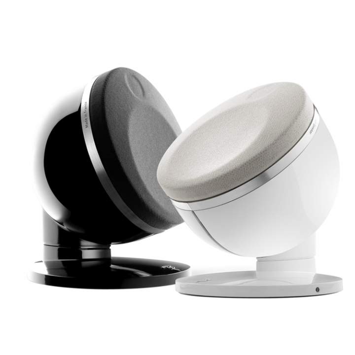

Looks nice, but I'm even more intriqued with this one, the Focal Dome.  It looks like an awesome mini speaker, and rightly should be at $749/pair, well beyond the OP's budget.
6.75" x 5.6875" x 5.625"
88dB
80Hz - 28KHz
Steve
