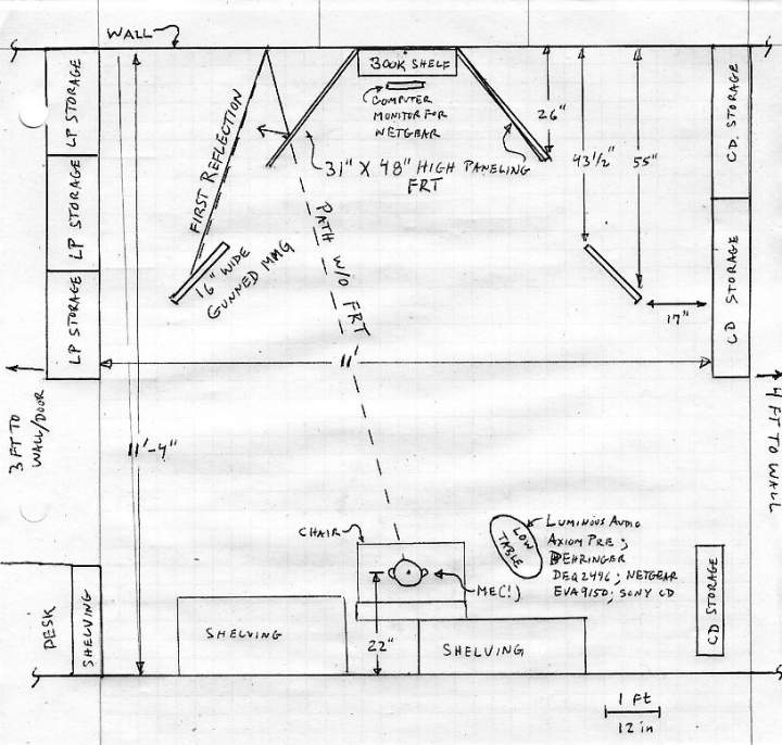

I have my "Gunned" MMGs in a 11 foot by 11 foot "listening room" carved
out of an 11 foot wide by 20 foot long shed, with a barn-like ceiling (8
foot-4 inch average height, peak height 9 foot plus), insulated and
climate controlled. Because it also has to act as storage for several
pieces of furniture and other stuff, I could never make the full
footprint symmetric enough for Maggies to throw a reasonable soundstage.
The non-exterior "walls" consist of my 6 foot tall vinyl LP Album and CD
shelving to make a symmetric listening space within the shed, keeping
spaces on the back sides of the media shelving for storing the most
non-symmetric stuff. The bad news of course is that the listening space
becomes a 11 foot X 11 foot square!

a placement about 50 inches from the front wall and 17 inches from the
side shelves to the outer speaker edge which had fairly even frequency
response properties*.  With a 45 degree toe-in so the direct sound
crossed about 2 feet in front of me, there was some real depth to an
amazingly wide soundstage. So far so good, but even with tweeters on the
inside the phantom center sounded like cardboard (how's that for an
audiophile descriptor?) compared to a monophonic signal from one speaker
only. I came to realize that some serious comb filtering due to the
first reflection being only about 7 milliseconds after the direct sound
was the likely culprit.

The brainstorm: what if you could delay (not absorb or diffuse)
rear-wave reflections from reaching the LS by use of a baffle? I had
some wood paneling pieces around, and I took 2 designed for fake
wainscoting (48 inches wide by 31 inches high), turned them on their
side so they were now 48 inches high by 31 inches long and angled them
out from the front wall into the room in such a way that the first
reflection from the front wall is "trapped" behind the paneling, hence
the name "First Reflection Traps" (FRTs). Not absorbed; the point is to
have the first reflection bounce around the front and sides to lengthen
the time it takes to reach the listening position. I settled on the
position by placing a mirror at the first reflection point, and ensuring
the paneling blocked the speaker from view. Since I had a small (6 inch
deep X 20 inch wide X 6 foot high) bookcase centered on the wall, it
acted as a convenient brace and spacer for the panels. Like the MMGs,
the paneling is also sitting on cinder blocks to elevate them in line
with the MMGs. The result? Spacious sound, by my calculations the first
reflection went from about 7 milliseconds to at least 16 milliseconds
after the direct sound reaches the listening position**.  The phantom
center now sounds very nearly identical to the sound of one speaker
alone. And the depth of the soundstage was not harmed; in fact, it may
have improved! Here is the floor plan:

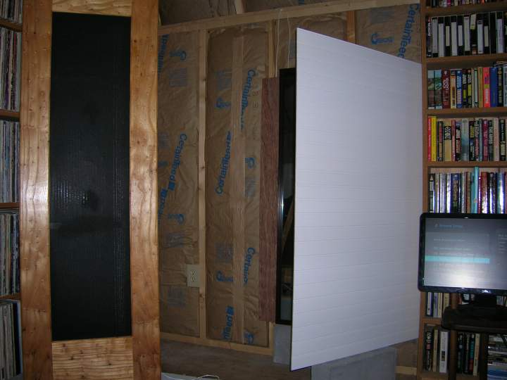

and a photo taken from the LS:
I think the 45 degree angle of the MMGs to the side wall is a key
element to this strategy, because it allows placement near the side wall
(good for bass reinforcement and for getting as wide a stereo soundstage
possible in a narrow room) while keeping the first reflections from
those side walls behind the speaker to bounce to the front wall, where
the FRTs as well as the bulk of the speaker can manage them by
lengthening their arrival time to the LS.
Since a lot of folks place a big TV between Maggies, some of the
positives they provide the sound could be some degree of first
reflection trapping similar to my FRTs. Especially the old-school big
TVs which taper towards a point in back behind the screen. It seems to
follow that, if one uses these FRTs that one could put ANYTHING centered
between them without affecting the sound, as long as it didn't stick out
further from the front wall than the forward edge of the FRT. Also, the
FRT probably shouldn't extend beyond the plane of the Maggies. I could
imagine a variant which even has some WAF, if they are made to look like
attractive, self-standing oriental screens behind the TV perhaps.  As
long as the backs of the screens are acoustically reflective, the front
could be anything attractive, like rice paper behind a wood latticework.
Since mine are in a shed which my significant other refuses to enter,
WAF is academic in my case. ;-)
OK, what does it sound like?  Unfortunately I can't write in Audiophilia
as well as I can read it.  All I can say is that music sounds like I'm
sitting in the second row of an intimate theater, with a stereo spread
approaching that of headphones, except for being totally outside the
head vice in-the-head like headphone listening typically is. Drums in
particular sound present in the room, although a lot of that came from
the Gunn mod. The excitement factor is through the roof, and I can
listen for hours without ear fatigue. I also suspect some here would
consider me a heretic for using a Behringer EQ as my DAC. All I can say
is that, judiciously used, it just seems to work without screwing up the
sound, like the Gunn mod does on my MMGs. OK, maybe the EQ function
introduces a little congestion to the sound, but that is more than made
up for by the evenness of the frequency response, meaning ALL the notes
get equal emphasis.  Besides, when listening to rock the congestion
actually adds to the "slam" and sounds totally normal!  Point is, I've
gotten the sound of my relatively inexpensive system good enough for me
to put it up against many multi-buck systems.  I'm still grinning.  ;-)

**"Calculations" meaning drawing sound trajectories on graph paper and
measuring them. ;-) True, the second reflection may be hitting me now
before the old first reflection does due to the FRTs, but the bottom
line is that the phantom center sound is now powerful and clean.

MGbert
I haven't tried it, but as I said back on the asylum, I think it's one of the most interesting experiments I've seen and hope eventually to play with it myself. The theory is sound, in fact, studio control rooms are typically designed with a "reflection free zone" consisting of facets that keep early (<10 ms) reflections from reaching the listening area. The facet approach works with soffit-mounted monitors, but dipoles require a different approach. The ideal? To delay most early reflections so they arrive no sooner than these:
A formidable task with a much smaller room.
In general, with dipoles, you have:
Floor and ceiling reflections -- not a problem in a full height line source.
Front wall reflection -- speakers need to be at least 15' out, that is, as far as the players are from the rear wall of the shell. Diffusion can help.
Side walls -- you can null the proximate side wall with the dipole null which helps but in a small room even that isn't enough. Rooze comes closer than anything I know for the side walls, it effectively increases the acoustical size of the room. But it doesn't work in every room. Diffusion can help.
Rear wall -- hopeless, unless you live in the Taj Mahal. Control rooms typically use diffusion on this, it's probably the best approach unless you're sitting against it, in which case you need absorption.
Anything that helps circumvent these limitations is welcome.
So what are you waiting for?   :)  The rear wall is NOT hopeless, btw.  I came up with an improvement which actually adresses both the rear wall and side wall issues, and is a marked improvement over the initial FRT arrangement, which itself was an improvement.  It's also impossible to ascribe any WAF to it.  Basically, you lean a 6 foot high, 4 foot long piece of luann paneling on the outer edge of the speakers, angled so you just see the back of the panel from the listening seat.  I know, I need to provide another sketch to make this clear, and I will in a few days.  Looks ugly, sounds great.  Never was there a better excuse for listening with eyes closed!

I find well placed clutter works.  Not trying to be funny, as it breaks up the 1st order reflections.
Actually, I don't think I could do this with my new setup, Tympani IVa's in the split configuration (woofer panels 1/2 wavelength behind the mid-tweeter panel, against the outside walls). It's unexplored territory for me, I used to have Tympani 1-D's but those you couldn't split. I imagine if you did, you'd want to do it for the mid-tweeter panels but I'm not even sure that would work, since low frequencies have a major effect on spatial sense.
My rear wall is going to have to have absorption on it, because my room is too small -- I have to sit almost against it. This would solve the early reflection problem, unfortunately, it would do so by eliminating all reflections, and you really do want reflections back there.
However, I have something else interesting to try. On my desktop, my computer speakers are behind my monitor and I realized at some point that I could position them so the monitor acts as an ambiophonics barrier to minimize interaural crosstalk. Now I have a large monitor for my listening room -- the idea is to do most of my computer work in there where the big speakers are -- and I'm going to see if I can position it to get crosstalk cancellation. Whether it works I think will depend on whether I can get it close enough to minimize diffraction, while still maintaining the right angle -- I didn't buy the new monitor with this in mind, thought of the idea later.
Actually, I'm not sure how the setup is going to work at all in my room. I was having trouble with it, with the speakers where I'd like them to be there's a fireplace mantle on the front wall that screws up the sound. The only thing I've been able to come up with is to put barriers on either side. Easy enough to do, but not very functional since my equipment closet would be behind one of them.

The diagram shows just a single ray emanating from the rear of the speaker (at a fairly extreme angle.)  What about the infinite number of other sound rays at all other angles?  How are you blocking first-reflection on those?
Dave.
josh358
  • Posts: 1240
At higher frequencies, ray tracing is a good acoustical approximation. At low frequencies, not so much. But since the reflections arriving within the first 10 ms are the most problematic, the main imaging impairment will be caused by the indicated first reflection from the front wall, and the first reflection on the proximate side wall, which seems here to be in the dipole null. Floor and ceiling reflections aren't a problem with full height line sources. The main potential problem I can see here is not with first reflections, but second reflections, e.g., the corner bounce reflections, which also have a short path length.
