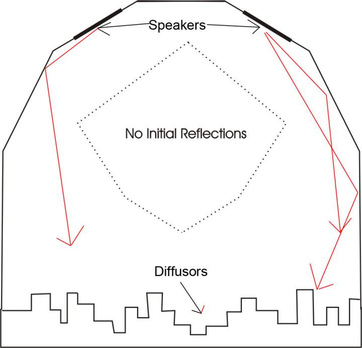

The diagram shows just a single ray emanating from the rear of the speaker (at a fairly extreme angle.) What about the infinite number of other sound rays at all other angles? How are you blocking first-reflection on those?Cheers,Dave.

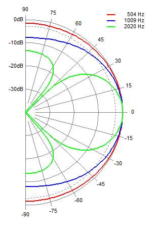

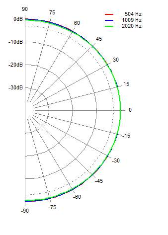

Josh,Is that ray trace on the diagram at high frequency or low frequency? Actually, if you look at the MMG woofer panel horizontal polar response you'll see it becomes fairly directional above 1000Hz. (A deep null at about 2000Hz at 45 degrees.) The tweeter is much "wider" of course because it's much narrower.So, I think it illustrates the polar response (when crossover is included) is pretty much cylindrical for most of the frequency range. (Two cylinders....one on the front and one on the back...out of phase.) Thus, the single ray doesn't properly characterize the larger situation.I think the whole concept outlined here is overly simplistic to what's actually/really a very complicated acoustic environment. A solution in search of a problem......IMHO. Cheers,Dave.

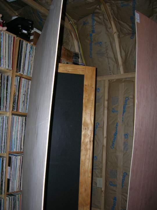

No Jim I.messed with them a lot. You should see all the spots taped out. I had just never tried this specific orientation, with something blocking.Remember I've only had these seven months!
Calm down Jim. I'm talking about a small improvement in soundstage, nothing more.

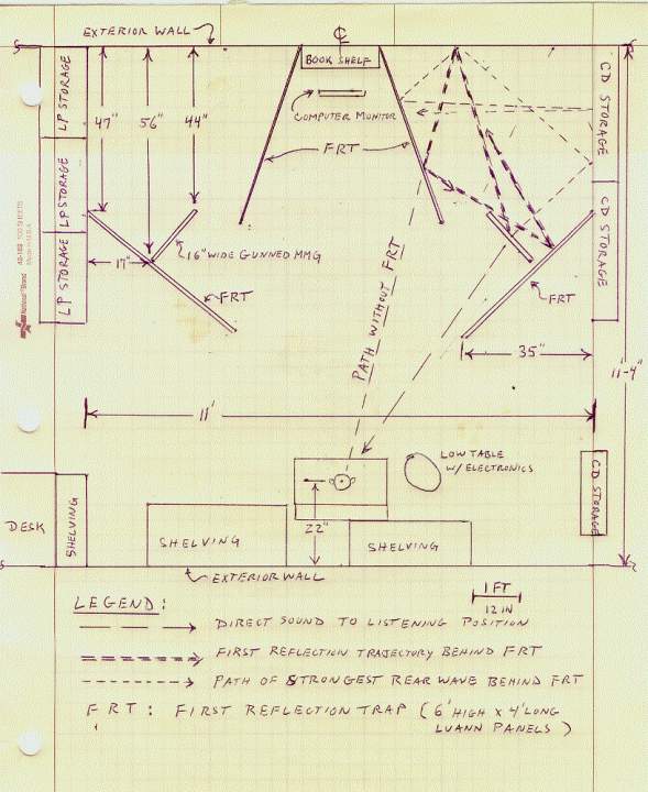

C'mon. Obviously you don't need to draw an infinite number of rays on your diagram. But I think you should draw one at about every 15 degrees (front and back.) I don't think that would be too busy looking. It looks to me like your FRT panels are fairly optimally placed to try and "block" first reflection points in your room and achieve your objective. However, my point (poorly made I guess) is that you've got the wrong speakers if this is a primary objective for you. Magnepans are just the wrong speakers for small rooms IMHO. Okay, now I'll get beat up and laughed at by someone who says his 20.1's just kill in a 100 square foot room. Anyways, some sort of very controlled directivity speakers....much like the Geddes offerings would seem to be the optimal playback system for your environment. Had you considered something like that?Cheers,Dave.

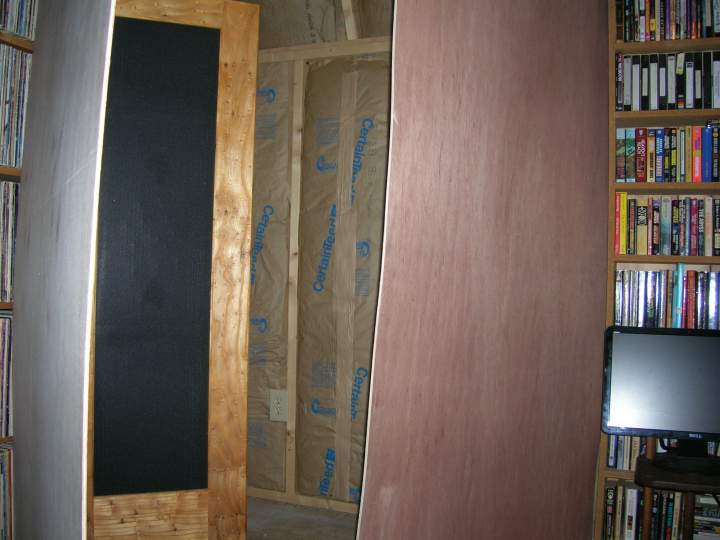

Josh:Where did you find that graph? There is an awesome amount of info represented by it. I'd like to learn more.And check out my latest version of FRTs. The second set might make even chamber music afficionados happy, since the rear reflections are well controlled - at least to my ears. MGbert
I honestly believe I found a way to make them sing in a small space, and like many engineering solutions it is functionally elegant and aesthetically awful. If someone else here can take the concept and increase the WAF, I'd be all ears - no pride of authorship here.
