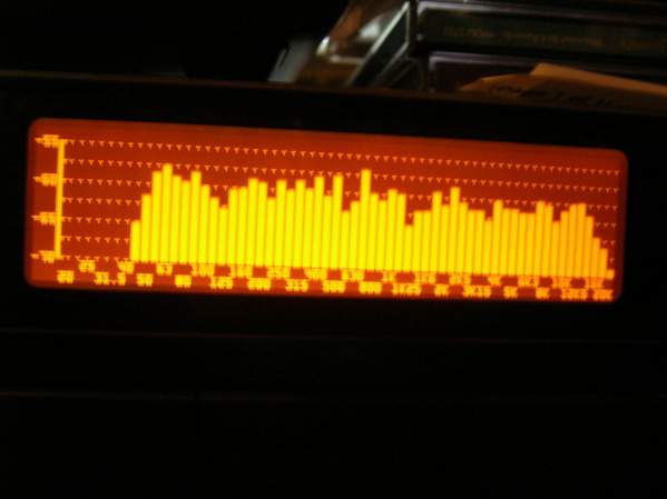

And your frequency response looks like the typical MMG in room response I've seen in a zillion plots, including mine.  The saddle response of upper-mid bass suckout and just above the crossover dip is quite common.  As is the boost in the 60hz region.

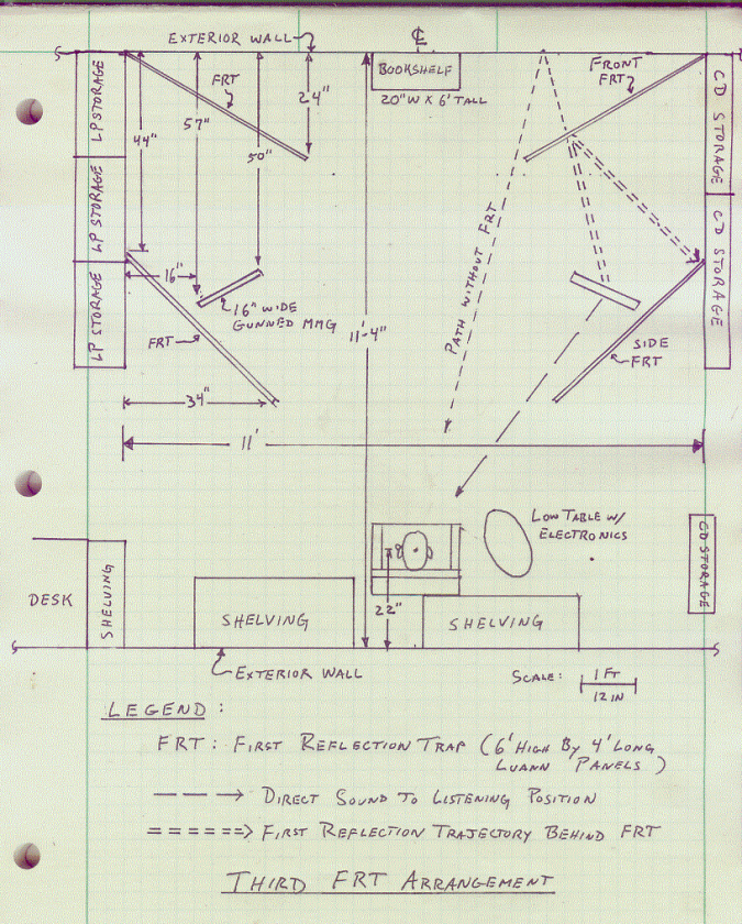

Time for an update.  I changed the front FRTs so instead of being "ears" to the bookshelf in front, they now are in the front corners of the room forming 30 degree angles to the front wall.  I had come to realize the bass emphasis from the previous arrangement was a bit much.  The new arrangement has the following advantages:
1) The new placement is a lot less intrusive, since it is closer to the front wall.  Potentially higher WAF, too.
2) By changing the angle the front and side wall make to each other, it seems to act a bit like a bass trap, smoothing out the bass.
3) It works in conjunction with the other FRTs on the outer side of the MMGs to delay the propogation of the early reflections, drastically reducing comb filtering effects.  However, unlike the previous arrangement, it offers no real advantage without those additional side FRTs.
I'll post a new floor plan and photos soon.

Thanks, sounds interesting. I'll be interested to see the sketch when you post it, it's kind of hard to visualize what you've done from the description -- I'd have to go back and reread the thread since you've used differential encoding. :-)
MGbert
Here is the sketch.  Computer problems delayed my being able to post sooner.
The advantage to this arrangement is that the front wall FRTs are less obtrusive, but this will only work with the side FRTs in place.

Don't you get bass reinforcement from the side traps? Not that that would necessarily be a problem with the MMG's . . .
MGbert
Not as much as the second arrangement, interestingly enough.  I realized that the bass reinforcement was too much, and started searching for a way of naturalizing it while maintaining the advantages of reducing comb filtering effects.
