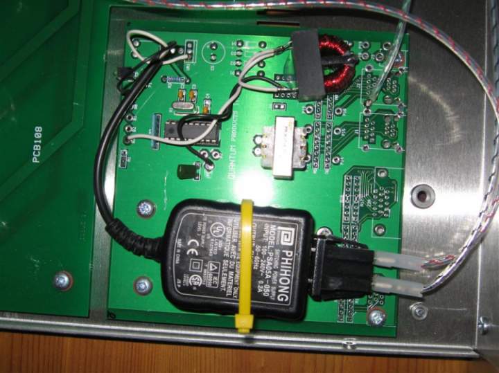

reminds me of another thread about the Nordost Thor:
Interior pictures of the interior of Nordost Thor  Power Distribution Center ($3300), and the above text is Roy Gregory's review (Hi Fi+ Issue 35).
So 3k gets you a circuit board with a built in switching power supply :)...
