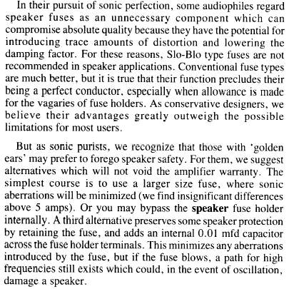

And for the real reason I came back to this thread... This sums up what I went looking for in regards to fuse decoupling.
This is a snippet from a Hafler XL-280 manual that jives with a couple of other suggestions for this. They mostly like the metal film (self healing) or ceramic .01μF for speaker fuse bypassing. Make of the manual snippet what you will but of all things I don't care to spend time pondering is flipping fuses. So ... I will be adding the small number of caps to my Mouser cart for the next order. And I really like Mouser for this kind of thing. Mouser, Parts Express and Parts Connexion covers most anything I've ever gone looking for as an audio parts source.

I confess that I'm a conservative when it comes to speaker fuses, but that Hafler manual pretty much reinforces what I'd thought. I think I'd want to try it first, preferably in some kind of blind test, before I'd take the risk with my own speakers. It's not that I blow fuses these days, but accidents do happen.
That article had something to say about using fuses with higher ratings as well. I may be nuts, but I think that might be a possibility as long as the melting time of the fuse is commensurately reduced. Thus, the current through the fuse stays further from the fuse's melting point, but the fuse still protects the ribbons by virtue of its reduced reaction time – perhaps even better than the factory implementation. I dunno – seems possible. Listening without fuses is inspiring me to seek a better fusing solution.
Actually, I was thinking along similar lines, not in terms of fuses (have you checked to see what they sell by way of fuses with non-standard characteristics), but when I was thinking of relay circuits. My thinking was that while the risk to a Mylar or dynamic tweeter is essentially from overheating, the main risk to a ribbon tweeter may be from excessive physical excursion because there are no adhesives or plastic to melt, just the aluminum itself, and that has plenty of exposure to the air. So, if that's true, you might be able to go with a very quick breaker that has a somewhat higher current limit.
But my inclination if it's still a real problem would still be to make an active circuit with a relay. That way, there's really nothing to muck up the sound. Hell, someone could bottle it and sell it as an overpriced accessory. Actually, I'm surprised no one has done this. I guess it's more profitable to sell $75 fuses that don't blow.*
And why wouldn't you be? All I am looking to accomplish with this is to find out if there is anything to the notion of fuses having detrimental effects in audio equipment. Which I have been skeptical about to begin with. I needed something more than anecdotal reasons for specialty fuses. This mostly satisfies my curiosity on the subject. There is a limit to how much thought I'm putting into it for now. What I really want to be pondering is my next volume control system and not fusing. This is one less rock I am going to look under in the persuit of improvement. I don't know when the Hafler manual was written but there was a Stereophile review on that model in 1987. Thanks offered to the contributor at diyAudio for finding that.
