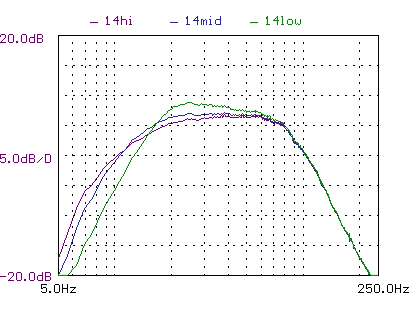

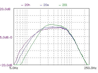

 I did some more reading on the FV12. It appears they took into consideration what people don't like about ported subs and inserted a great deal of control onto the amp:

"The following three figures show the actual frequency response for all 3 damping settings when the frequency is set to 14 Hz, 20 Hz, and 28 Hz. The low damping setting provides a boost up to 1.5 dB whereas high damping provides a most smooth and gradual roll-off.They give a total of 9 different roll-off characteristics."  :o
