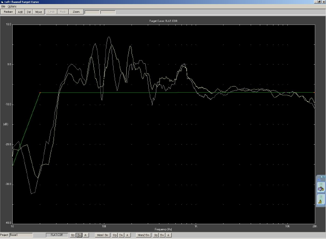

Here is a graph of the in room response curve of the Criterions taken by my Tact RCS.  The speakers were fairly close to the wall behind them in this measurement thus the large bass boost.  Of course the Tact RCS corrected for the excess.  I've added a flat response curve from 20 to 20K as a reference.

Tsunami, for an in room response that looks pretty good. The room gain in the lows are expected and the highs are smooth as anyone could ask for.

Danny,
I did have the cherry pair.  I posted the curves to show that I did not experience any issues at the 3.4k crossover point.  Only having the Criterions for a short demo period, I did not spend much time trying to optimize their location in the room.  I let the Tact take care of the correction there.  I mainly wanted to make sure that there were no major nulls in the response at the listening position.  I too was very satisfied with the frequency response above 1k Hz prior to any correction being applied.
