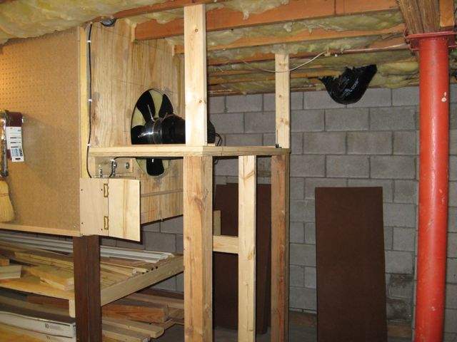

wow. I would love to hear your system. Can you describe the rotary sub some?
Rotary Subwoofer
1. Response is from 25 hz down to below 1 hz.
2. High efficiency at very low frequencies
3. No equalization needed for response to below 1 hz.
4. Has enough acoustic output to move an open door .5"
between 1 and 5 hz.
5. Transient response is near perfect
6. Requires a very large enclosure to absorb fan noise
(My enclosure is 8' long x 4' high x 4' wide)
7. Infinite baffle enclosure to prevent front and back wave
cancellation (I use my entire basement of 2000 sq. ft.)
8. Requires a low pass xover (recommended xover frequency
is between 15 hz and 25 hz (I use 25 hz at 18 db per octave)
9. For pitching the fan blades a 200 watt amplifier is required.
10. Requires a motor controller to control the speed of the
rotating fan and maintains constant speed when fan blades
are being pitched.
11. The motor controller allows for adjustment of speed to match
the size (volume) of one's room.
12. A minimum opening into one's room is 3' x 3'. (I use 4' x 4')
13. Produces very low bass utilizing low pressure (conventional
woofers utilize high pressure (cones move back and forth
madly to produce very low bass.
14. The rotary subwoofer matches the air load (impedance).
Horn enclosures do the same, but would require an enormous
enclosure
15. One needs an additional 120 vac outlet for the fan motor and
motor controller.
16. Distortion is very low down to 1 hz
