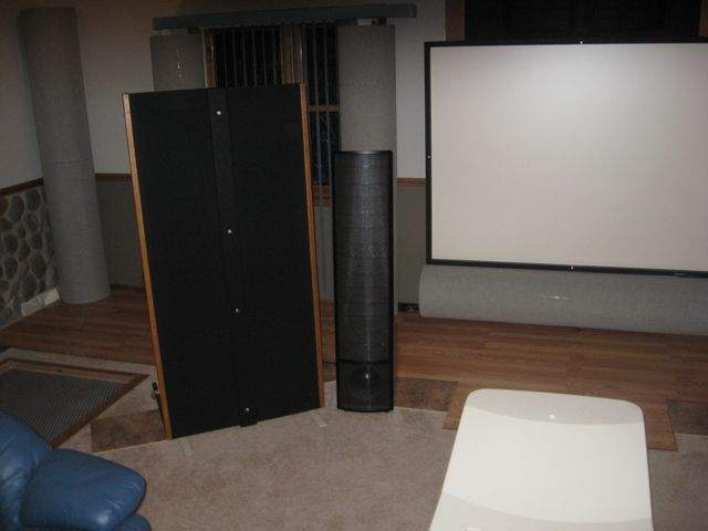

"This combo of speakers is my answer to 'state of the art' bass and integration. Martin Logan Summits (woofers not used) along side of Magneplanar Tympani IV bass panels (modified).
With the addition of the Eminent Technology TRW-17 rotary subwoofer, the bass is stunning in power, impact, and transient response which rivals them all. After 50 years of being an audiophile, this speaker system gives me everything I ever wanted for a truly realistic presentation with depth, imaging, huge sound-stage, low level detail, ambience, and with coherence (all the speakers work extremely well in this area.) My room is 29' long x 19' wide x 11' high cathedral ceiling, with fabulous acoustics (36 ASC bass and mid range traps, GIK bass traps and other diffusers.
All equipment is mounted in a sand filled enclosure on a separate concrete foundation in a control room for superb isolation and is wonderful for access to all wiring. A center Martin Logan electrostatic speaker is used and 8 rear and side speakers provide a realistic surround field that is stunning in giving one the feeling there in the hall (venue) where the recording was made."
wow. I would love to hear your system. Can you describe the rotary sub some?
