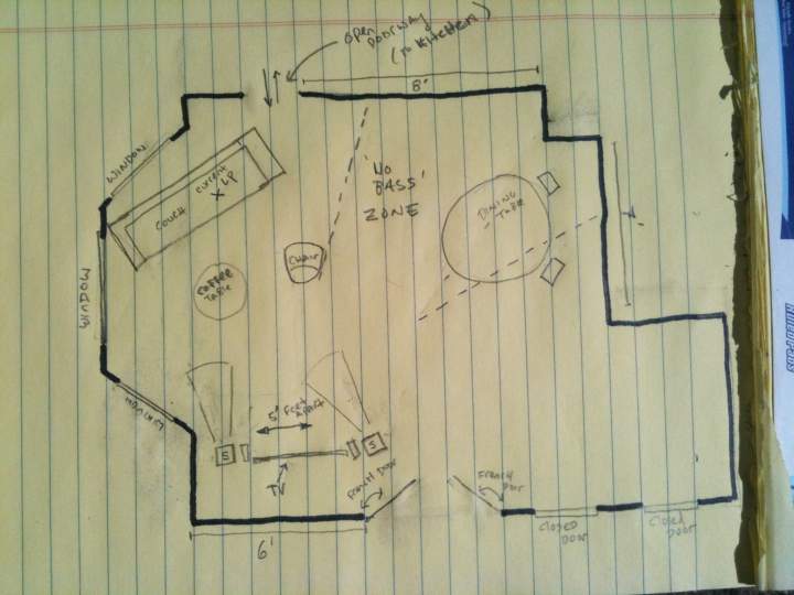

It would really help if you could provide a sketch of the room showing all the openings, bays, windows, and furniture.  12 ft x 18 ft is close to what I had (with hardwood floors, picture window, 2 doors, 2 openings, and another window) and I thought the room sounded pretty good.  My current room was designed following the Cardas "golden cuboid" (8 ft x 13 ft x 22 ft).  So frankly I’m not convinced that you have a problem room (prove it to me).   :scratch:  If you really do have a problem room it probably can't be solved by speakers alone.

Well, here's my sad little attempt at drawing the room in question.  :oops:
I drew the 'no bass' zone, which is where the bass frequencies disappear when I had my couch/lp there.

Listening position may be a bit far back given the space in between the speakers.  May wish to get a folding chair and see what it sounds like a couple of feet closer.

Based on that drawing I would not get any type of beaming speaker.  Your listening position is not ideal.  I see you have the speakers toe'd in to your listening postion, that is part of the problem with the dead zone for bass.  I think that a sub or two would take care of that problem.  You may want to consider one of the wireless Martin logan subs that will allow you to place it any where in the room. Or go with dual subs.

Also, I would put a panel behind and on the side wall of the left speaker, this would help with boominess.  Or place a corner panel by that speaker.

Hi Neeko,
Got your pm and responded, thanks. I promised not to comment about my speakers in this thread. But about your layout, would it be possible to re-arrange the furnishings similar to this?:
may want to try this (or something similar) first, before even considering new speakers, mine included (as much as I would like for you to purchase a pair, if you don't need to spend anything except some energy... :D).
cheers,
AJ

I would agree that what AJ posted would be a much better setup and a lot better room coverage overall.  The way it's set up now, you're pretty much right at a boundary and the speakers are very asymetrically loaded.

It's a good thought AJ, one that I had always discounted for the practical problem of having to put the tv and the speakers in front of the only windows in the room. It would cut down on natural light, among other things. But I do see the merit in terms of potentially improving the sound in the room. If I could figure out a way to get the tv away from my 2 channel stuff, as in divide it into two systems, maybe I could be more flexible with speaker placement there.
The other one I'm considering is putting everything against the 8' wall at the top, with the couch facing it, sort of in front of the french doors, with enough room to walk around it, of course.
With speakers having a uniform (but fairly narrow) radiation pattern, toed in severely (like 45 degrees or so), two relevant advantages accrue:  First, the off-centerline soundstaging holds up a lot better than normal.  Second, the tonal balance holds up unusually well even for listening positions well off-axis, like at the dining room table, or even farther off to that side.
Philosophically, here's how I look at it:  A grand piano would sound great in that room no matter where you put it, and no matter where you listened to it, though admittedly some locations of piano and/or listener would be better than others.  I think a good speaker system should have similar characteristics, and one way to do that is to emulate some of what the piano does well - namely, generate off-axis energy that has approximately the same spectral balance as the on-axis energy (defined by where the soundboard is "pointing" for the grand piano).

OK, so the layout is unusual but not horrible.  It's bigger than I thought (I would have called it equivalent to a 15 ft x 18 ft room and bigger is always better).
Another option would be to try setting up opposite of AJ's suggestion, in front of the 7 foot wall.  That way the TV isn't blocking the window and the couch could be pulled away from the window (sitting against a back wall is "un-recommended" by nearly everyone).  This would provide a fairly symmetrical room layout like AJ's with the couch in front of the system and a sort of nearfield setup.

Yes, the Acurus is fine, stick with it.  Re-arrange the room, get some GIK panels, and either econowaves, VMPS 626r's (which are a great bargain), or some Fritz Carbon 7's for this budget.  And some heavy drapes for the windows.  Subs are a good option for down the road, but IMO are not needed immediately.

Yeah, I think the Acurus is a good piece of gear, I'm definitely keeping it around no matter what. I actually missed the part where somebody suggested I needed a new amp, I'll have to re-read the thread.
My head is spinning a bit from all the permutations, and since any one of these suggestions- speakers, room layouts, etc. require its own consideration, I have plenty to chew on.
I agree with most of you that I will be able to improve sound by moving stuff around, rather than instantly spending a bunch of loot. That said, I'm not really that into the sound from either set of speakers I currently own; the old B&W DM602s2 and the Def Tech BP8020. So I'm in the market for speakers for sure, even if my room were suddenly Carnegie Hall. And I'm fairly certain that my electronics will not need upgrading for a new set of speakers. The speakers are the weak link here, and I keep hearing that they should be the best part of a stereo system.
Anyhoo, I think I'm gonna try out AJ's scheme, see what happens. Here's to some late night furniture moving.

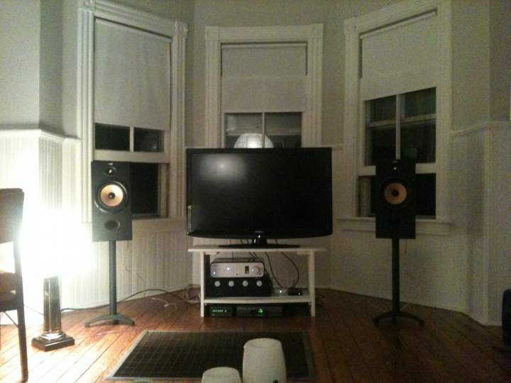

Well, I did it. That was a PITA fo' sho'. Sweating, untangling wires, I kept having to remind myself, 'this is supposed to be fun, this is fun, c'mon, enjoy it...' :wink:...
Anyhoo. The sound is better. I'm too tired to really tell how much better.
The setup certainly has serious impracticalities for living. This says, "I value good sound over pretty much every other lifestyle consideration." Hence, it may be changing soon. Fun to experiment, though. Life is short.
