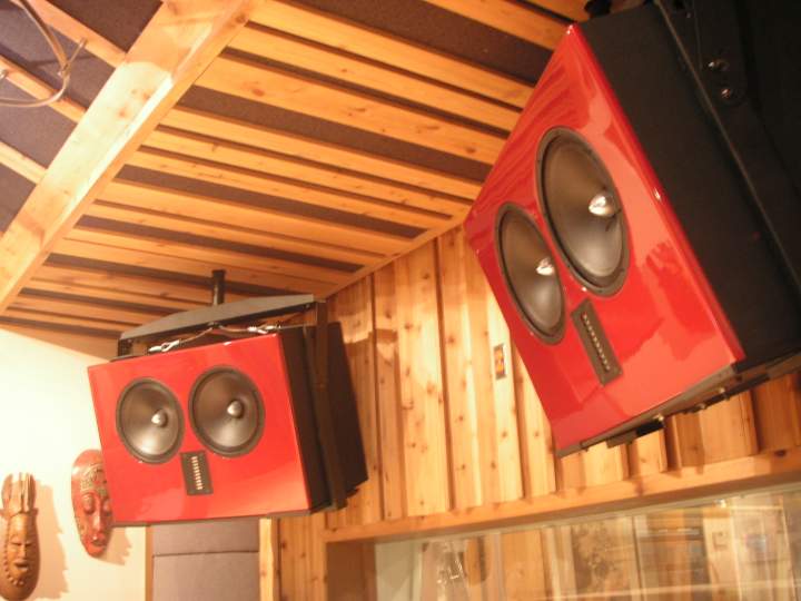

Wow, I love the look of that wide baffle with the glossy red and black spine.  Nice.  Reminds me of the studio mains I built.
