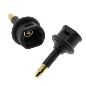

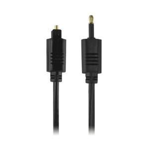

It is possible that your laptop has a combination headphone/optical jack which can accept a mini-TOSLINK connector.
If that's the case you might be able to simply use a Mini-TOSLINK to TOSLINK cable, or a Mini-TOSLINLK adapter with a standard cable and not need a USB interface.  If you have the combo jack, you might be able to see a red LED shining through the jack if you peer into it.  You may have to enable SigmaTel Digital Output Device (S/PDIF Out) for it to be active.

I can't say that optical out of that jack would be better or worse than the USB to optical interface - it depends on the individual implementation with each device.
As mentioned, If you did use the headphone/optical jack you would either need a Mini-TOSLINK adapter or a Mini-TOSLINK to TOSLINK cable.

These items are very inexpensive on Amazon, so I went ahead and ordered the mini-toslink-to-toslink cable, as well. That way I can try both configurations and see if I notice any difference, and Amazon also has a very good return policy in case I want to return any of the items. Can't wait to try this out tomorrow!

The bad news is that either I can't figure out how to configure the mini-toslink jack, or my computer doesn't have that capability.
