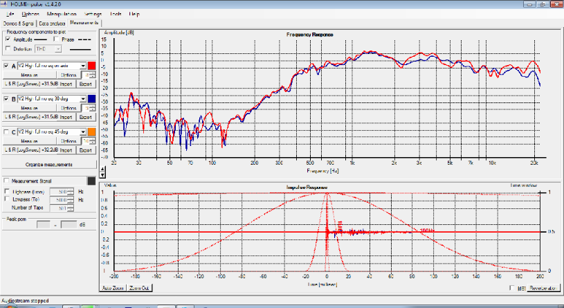

In case anyone wants to see what Duke is talking about, here's a set of measurements of my tweeter with a waveguide measured on axis and then 30 degrees off axis.  Look at the differences between 2khz and 4khz in particular:
Even more excellent, is the measurement to illustrate the point. :thumb:

Tyson's measurement technique is definitely superior to the one I described.  And if a picture is worth 1.0k words, his measurements are worth twice that.

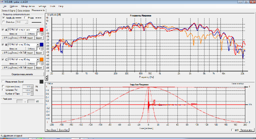

To follow up, here's my midrange measured from 0, 30, and 60 degrees.
As you can see, the 8 inch driver has excellent off axis response, and it also has a nasty set of peaks at 3.5 and 4.2khz.  Given the downward slope after 800hz, I think a crossover point at 1khz with a steep slope is the best option.  BUT, when actually listening, I find that a 1.2khz slope works better because of the shape of the tweeter response.  IMO this tweeter is not happy at 1khz, but quite happy at 1.2khz with a steep slope.  And for the midrange, using a steep slope (like 48db Butterworth), allows the 3.5 and 4.5khz resonances to be avoided.  Other than that, I dial in a small dip at 700hz, and a small boost at 880hz to give me a smooth, flat midrange to tweeter transition.
I also have some bass woofers I bring in at 150hz so I just need a bit of a boost on the midrange between 150hz and 300hz to take care of the baffle step.  The bass woofers sound good at 150hz, but I've heard a rumor that Danny is developing 8 inch servo subs.  If these could be run up to 200hz with even better sound quality, I think it would take the V2's a major step up.
