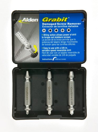

Here's what Harbor Freight sells (one of my favorite places to get tools) - http://www.harborfreight.com/12-piece-screw-remover-and-quick-change-bit-set-95530.html
I may have to look for it next time I visit one of their stores.  I have not been to one in a bit.

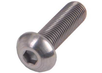

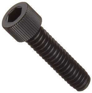

After you get the screw(s) extracted, I've usually always been able to find nicer hex socket head replacement machine screws from one of the larger Ace hardware stores in English or Metric, Button or Cap Head and Stainless Steel or Black Oxide.

That looks like a neat tool assuming it works.
It works. I bought a similar set from Sears years ago.
