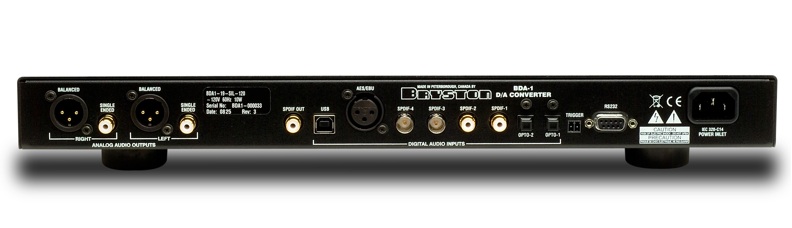

Suggestions on the best way to connect a BDA-1 DAC to a Naim XS integrated?  I would greatly appreciate advice on both both type and company/model.

RCA to Din interconnects are the best method with a Naim amp. Naim, Chord and AR Sound are the three companies that come to mind first.

So DIN is best on the Naim end.  RCA the best/appropriate connection on the Bryston BDA-1 end?
You have a choice of two analog output types/connectors on the BDA-1, single-ended RCA and balanced XLR.  The NAIM has single-ended RCA or DIN inputs, so you would want to use the single-ended RCA outputs on the BDA-1.

Hmm... Let us go over the possibilities here...
We take a look at the BDA-1
On the far left of this device we see XLR and... RCA outputs. Weird, since the RCA basically is the universal standard type of connector when it comes to consumer audio.
Now, we take a look at the Naim XS
On the far right of this device we see DIN and... RCA inputs! What a shocker! Now this is completely unexpected!
So the ONLY sensible way to hook this device up is go from the XLR output on the BDA-1 to the DIN input on the Naim XS. I doubt this could be any more obvious.

I think that the DIN on a Naim is actually unbalanced, so the XLR route would be a waste of time, just RCA to RCA.....
