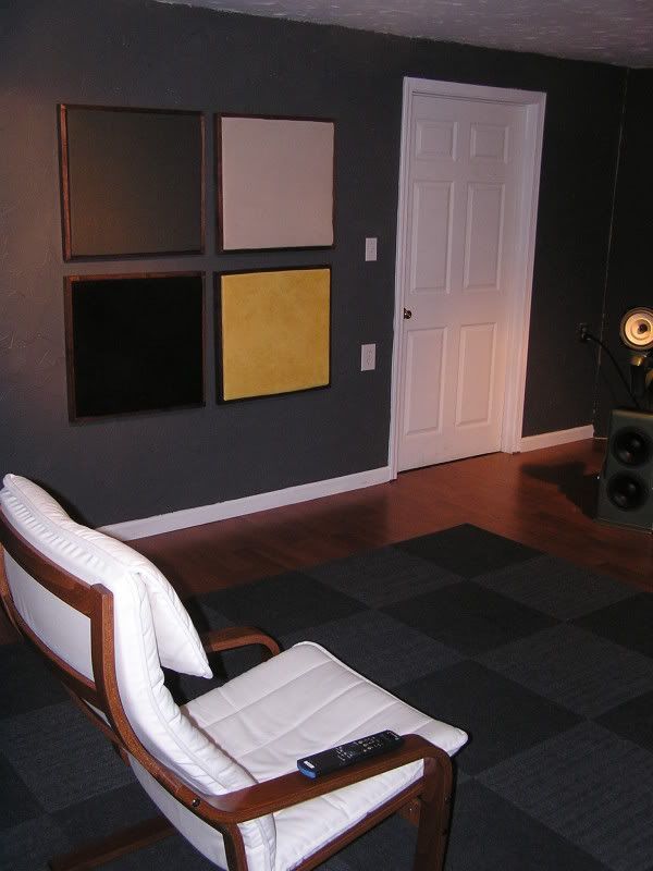

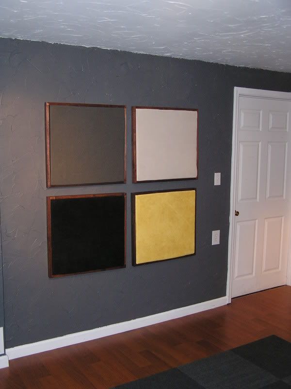

while stuff is drying in the shop... I took sometime and put of some diffusers... this room has come a long way in a short time...

a couple quick notes on listening so far...
all secondary timing and reflection issues are gone as far as I can tell.. focus, attack.. and decay for days... more air, wider stage and better placement...
and prolly the coolest part of it for me, is that the room no longer exists  :thumb:

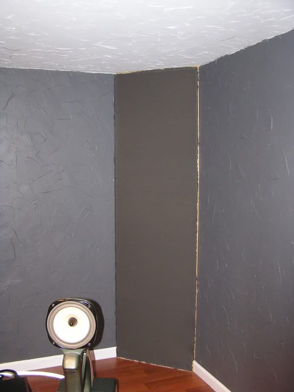

What's being used in those front corners and why ? Could you elaborate on your placement/product approach ? Dave, can we expect some OB general benchmarks soon ?
I took 1inch Owens Corning 703 and cut them into 17 x 16.5 x 16.5 triangles and stacked them floor to ceiling... I then took 1 x 3 inch poplar and ripped a 45 degree cut right down the center and used the cut side to hold the 703 tight in the corners on both sides as well as added cross bracing.. I then stretched grill cloth across it and ran staples down the poplar... I will hide the edges with half round once it's warm enough to paint in the shop   :green:
what I gained from this is a way more even bass response across the stage along with micro dynamics.. it was the first thing I did to the room.. and after that is was absorption at first reflections
Corner bass traps:
First reflection absorbers:
