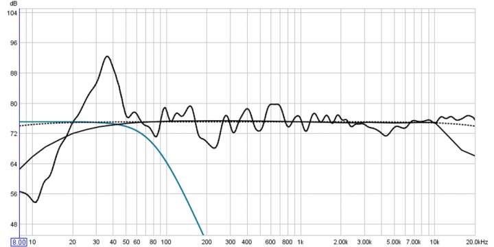

So here is a graph of my problem:
If we can argue that I did a fairly good job at placing the overall frequency response at 75db, then we can say I have a bass peak of about 17db at 36Hz.  I'd like to cut this down as much as possible.
This bass peak doesn't sound all too bad because at these frequencies it's not obnoxious to the music.  However, you can easily hear it in many tracks and I'd like to do something about it.  I'm not a rap music fan, but it is fun to play because my main speakers can really pump out some impressive floor shaking bass.  It's really surprising actually.  :D

Show us a graph of just the full range speakers (no subs).

That graph is without a sub.  My graphs with the sub look fantastic, they just don't sound that way...

It looks like you are using REW for the measurements.  Do you have calibration data for the mic?  The RS meter has known response deviations from flat below 50Hz.
Just thinking that it might be partly mic response related.

I am using REW, but I use an ECM8000 mic with the calibration file.  I am positive this is not a measuring problem.  I can clearly hear the issue.  It's real.  I'm not saying the measurements are perfect, but it sounds like it measures.  It's just that a lot of music isn't affected by the peak all that much.  Unfortunately there are many tracks where the peak is VERY audible.
