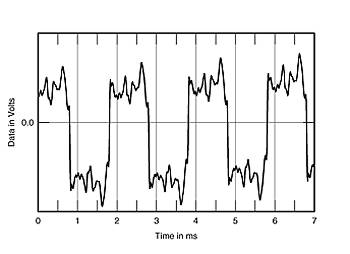

Here are three different Step Response Graphs found on Stereophile. Let's hear how you understand what they mean. Does one show better performance than the other, etc, why? What does the graph show in reality?

Step Response graphs tell you whether the design is time or phase coherent,they also indicate how well the drivers tend to hand off to one another.
  They do not however tell you what a loudspeaker sounds like.
Here are what graphs of phase-coherent designs look like on their designed listening axis.
This is the Dunlavy Labs SC-IV/A.
The step response.
The impulse response graph.
The square-wave response.
Link to Stereophile review of Dunlavy Labs SC-IV/A
http://www.stereophile.com/content/dunlavy-audio-labs-sc-iva-loudspeaker-measurements-part-3
So how does the graph tell you this?
There is volts on the left and time on the bottom.
What does it mean when you get a mountain range?

I admit, I don't know what a step response graph is.  I am familiar with FR and impulse response graphs (and CSD and even wavelet transforms). What is the input signal in a step response graph?
JoshK
Re: Understanding Step Response Graphs
« Reply #6 on: 11 Jan 2011, 04:48 pm »
haven't read it all myself, but here is an explanation.  I now see what the difference in input signal is between the impulse and step, but don't yet see why the step would tell you anything different.

I'm still not quite sure what you can really usefully read off a step-response graph, other than when (like an impulse response) it's exemplary (as per the Vandersteen one I noted above, not there now).

I find the most important data to be the frequency response, impedance / efficiency, and spectral decay. But the king for me is the frequency response.
