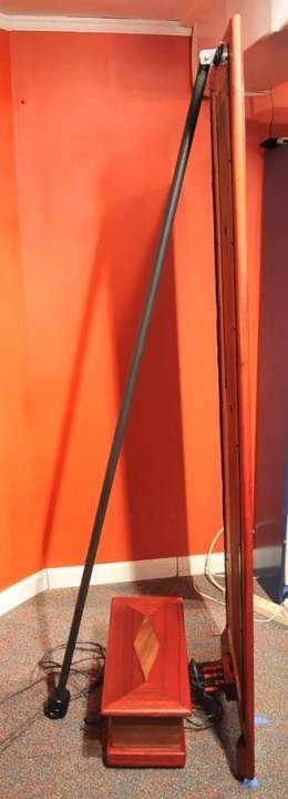

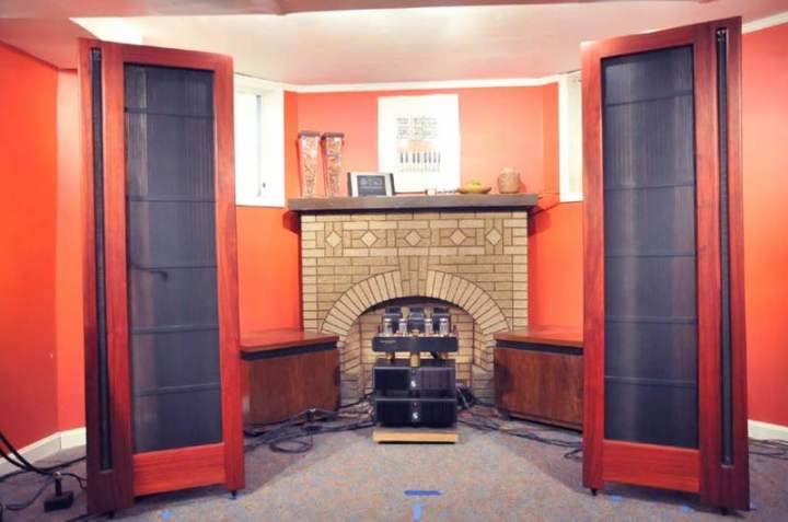

when I rebuilt my IIIa's I looked for the simplest and most stable solution.  I have tiptoes at the bottom corners of the frame and a lead shopt filled pipe supporting the top.  Not much more than a tripod and rock steady

Where did you source the connectors for the top and bottom of the pole?  That looks to be 1" black pipe?
I think I'll do something similar but will go with two rods in possibly an X configuration.

Steve, I suggest 2 rods is not necessary if you do what Peter did ... which is to replace the stock MDF frame with a hardwood frame.  :)
And just adding a diagonal brace (or two) to the back of the stock MDF frame is a waste of time, IMO.  :o

I used 1 inch alum electrical conduit, plugged one end with 3-4 inch hardwood (red oak) dowel.  I had to sand the dowel down a bit then hammered it in.  Turned the pole around filled with lead shot, packed it tight by ramming it.  Poured in WEST epoxy resin until it would not take any more.  After the resin hardened I tapped (threaded) the (bottom) end and inserted a tiptoe.  The other (top) end I drilled through the pipe and wood dowel to accept a bolt and nut to fasten it to a bracket I made out aluminum channel attached to the top center of the panel.  I covered the pole with black heat shrink tubing, heated it for a tight fit.   The pole is very dead.
I added three zinc donuts (used on prop shafts on motor boats) as weights at the bottom of the pole for added stability.
The above sounds like a lot of work but it really wasn't. Much simpler than building a metal or wood frame to hold the panel up.  I believe I got great coupling to the floor.  I may add a couple of zinc plates to the bottom of the panel for more mass.  The panels really do not vibrate much at all unless I really turn it up.
I may do one other mod that AndyR suggested and that is to cut a slot (1/8 inch, width of a saw blade between the ribbon and the mid panel.  This would run from about 6 inches from the top to 6 inches from the bottom.  This would help decouple the ribbon some.  Still trying to decide if this would be worth the trouble.
