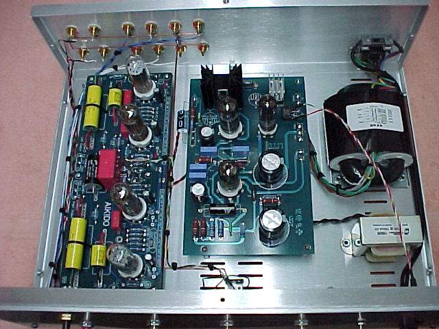

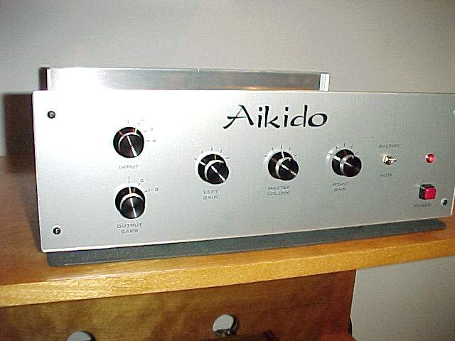

Thanks for the input. I did build an Aikido preamp and was not thrilled with it. Some CD's sounded great while most others sounded "strange". :(
 John's boards are top notch and it was a fun project. :) I have a Dodd MLP preamp and love it, but wanted to go with some form of 6SN7 unit, since I have a bunch of them and believe it to be a VERY good preamp tube. I am now using a Cary AE-3 MKII with good results after I upgraded the caps.

Fantastic build! Well you know the Aikido sound and I'm afraid that the 6SN7 SRPP you linked would sound worse by comparison.
You might need to up the ante and build a full differential design or start using DHT's in the linestage  :P
