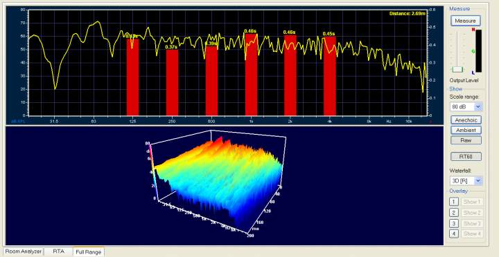

room measurement with front wall passive resonator removed, 4 panel bass trap removed  and 3 placed at the center of rear wall, sillk carpet in front of listening position removed.
U can see that it measured better now particular at around 110 hz. RT60 increased slightly
Initial measurement

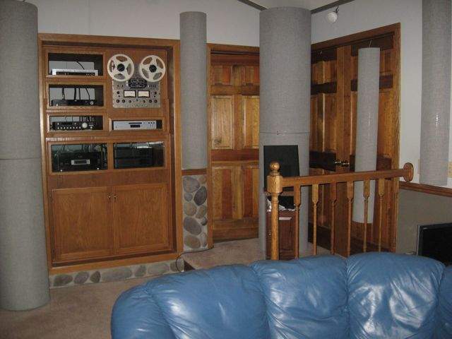

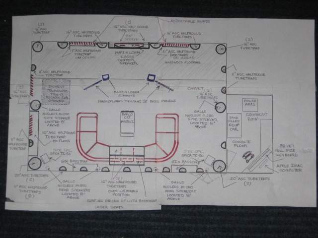

Brick walls and concrete floors are great for isolation but are more difficult to get uniform and well controlled bass.
I use 36 ASC bass and midrange tube traps, some GIK bass traps and other homemade traps.
Here is a drawing of my room showing placement of all the bass and midrange traps.

Nyal , thanks for your suggestion. The graphs shown are for measurements without integrating the sub to the front speakers .
Can I use XTC to measure 2 channel + sub ? To integrate the sub ( a pair of fathom 113) , I connect it thru the output of the preamplifier . So if I were to unplug the RCA connectors at amp side & plug in the y connector at the amp & take measurement with preamplifier driving the active sub & amp driving the front speaker would that be the right way to go about it.
I removed the front passive resonator , removed 6 panel bass traps & add 3 traps to the center of my rear wall behind the LP rack, my room measures
better. Will continue to experiment & see how things turn out.

My room is 29'-3" long x 19'-2" wide x 11' high cathedral ceiling.   All the ASC bass
and midrange tubetraps have a reflective membrane that prevents over damping the highs, but
provides bass that is powerful and detailed.   As Ethan Winer of Real Traps has said many times, one can never have too much bass trapping, and I agree.   The traps are spaced evenly around the
perimeter of the room with 3' between each trap that reduces comb filtering and the
result is voice reproduction that is very detailed and imaging that is extraordinary.  The overall
sound is very spacious and one feels like there in the hall (venue) where the recording was made.

I really don't see any difference in those measurement you are showing either before or after, it looks the same. You removed some stuff, how does it sound now compared with the treatments?

Well it's sounded sharp & slightly blurry. Can't really hear the suck out  issue , probably not much musical  content around the region fr my Lp or cd. However it's still sounded boomy eg with Jennifer Wearnes Way down deep. If u look at the RT60 graph u will noticed that it has increase & that shows that the room is less damp now. I hope my interpretation of the graph is correct
