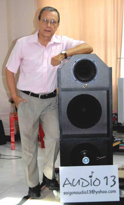

Hi Tyson.
I did a side by side test with the V-1 and V-2 using a switch box and switching form the V-1 to the V-2 I came to the conclusion that the V-2 IMHO as more bass or should I say : Better bass, the kind of deep bass I like. Of course, Danny did not agree and said that the wiring of the V-1 was incorrect, therefore, I am now re-doing all the wiring and I will re-do the test all over again.
Now for the mids and highs, IMHO the V-1 is a little better, it as more detail more presence, however, a little, very little more agressive sound, but not enough to be annoying. The mids and highs of the V-2 was, not softer, but a little more muffled. That's not the correct word, but can't find the right word for it. It's like it came from the back stage. But not to a point were it was annoying.
Conclusion for now. I prefer the sound of the V-2, mainly because of the bass and the price of the V-2 is also more to my liking. Later on, I will add some NoRez and post my finding, but I am not convinced that the NoRez will make a BIG difference. I am sure it will make a difference, but not a big one.
This weekend I should have finished the modifications of my V-1 and I will do another side by side test and post my finding with some pictures. I love posts with pictures.

The Red OB subs look great. I love it. You'll love it even more if you can line it with No Rez. The panels are pretty good sized and those woofers will really shake them hard. My personal pair of V-2's have an additional 3/4" side panel and are lined with No Rez and if I were doing it again I would make the side panels even thicker if I could.
Again on the V-2 build, I'd do whatever I could (follow the plans) to minimize the surface area around the upper driver as the added space there will reduce imaging and sound stage layering.
In the design that you have posted there are several issues.
First, the N3 kit can't be used in an open baffle. For an open baffle design the crossover has to be completely different. For instance, the OB-5 and OB-7 use the same upper MTM as the N3, but the crossover is completely different. And changes in baffle size also require changes to the crossover. So even if the crossover for the MTM section of an OB-5 or OB-7 were used, it would still need the values adjusted for the larger baffle area.
Secondly, you can't series/parallel three drivers. You can series two of them and parallel it to one and get a good impedance load, but the one driver will be working twice as hard (getting twice the power) as the two.
