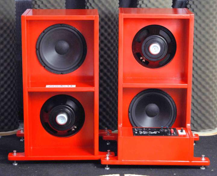

I know all AC members love pictures, therefore, here are a few of the things that have been cooking here in Vietnam.

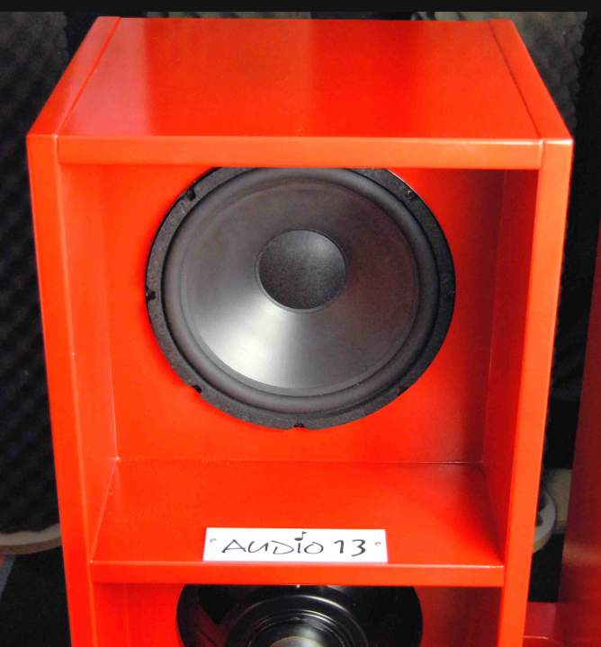

V-2(S) the S stand for sub only.

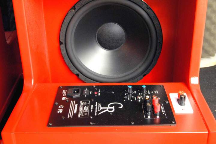

A close up on Danny's GR Research SA-1 plate amplifier.

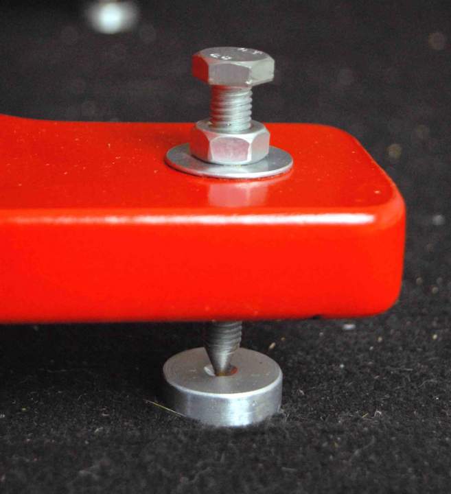

Design by Guy 13 and made in Vietnam. Industrial look spikes, but super strong and at 2 USD each a bargain.

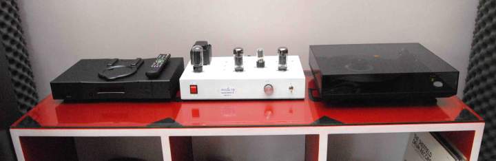

My system (From L to R) :
GR Research V-2M The M stand for modified, mainly the dimensions.
Rega Apollo CD player.
Niteshade Audio Model SE15 (I have re-name it : SE-10M for 10 wpc power output and the M for modified, cosmetic changes, like power rocket switch and volume control knob.
Rega P-3 turntable with Rega Exact MM cartridge. Not shown a Bellari VP-129 phono stage.
The piece of furniture holding all the audio stuff is made in Vietnam for 175 USD, including the locking wheels for ease of getting in the back for cable changes.

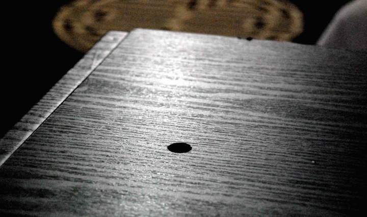

Are your V-2 enclosures finished with a plastic laminate?
Got any close up pictures of them?

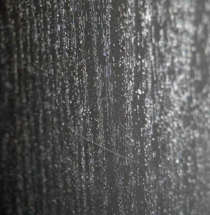

Hi.
I don't know what kind of paint the cabinet maker used, because my enclosures were sent to a paint shop, however, I know it's ordinary air dry paint.
Here is a close shot, but not sure if it helps ?
If you want and if it can be of some help to you, I can take a few more shots. I like to pixelize my creation. (Ha, ha...)
I am thinking of applying a thin coat of Pledge can spray. I will try first on a small area...

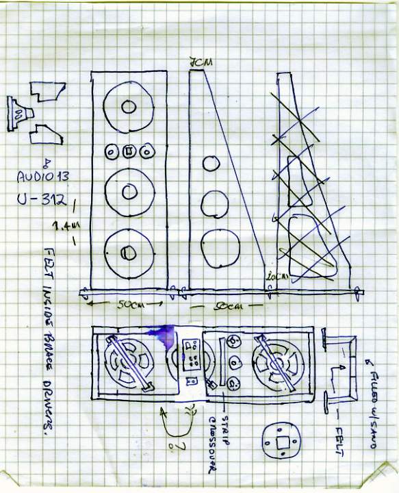

Hi all.
Please find below a preliminary hand sketch of my next project for 2011 called : U312.
U stand for U frame and 3 for three drivers and 12 for 12" drivers.
Simple enough !
The three 12" drivers will be connected in series parallel to give an approximate 6 Ohms load to the GR Reseach SA-1 amplifier.
Now it's time for Danny to jump in, if he doesn't agree.
The mids and the highs wil be taken care of by the drivers from the N-3 kit from GR Research.
Again, last chance for Danny to agree or disagree...
As usual the wood used will by extra heavy duty industrial type 1" thick MFD for the sides and 2" for the front and bottom, I might even put some sand on the buttom to avoid the enclosure to tip over.
As usual, all comments are quite welcome.
Guy 13.

Sorry, but I am still playing catch up over here and I am still about 100 e-mails behind. I answered about 50 or more last night before bed time.
The Red OB subs look great. I love it. You'll love it even more if you can line it with No Rez. The panels are pretty good sized and those woofers will really shake them hard. My personal pair of V-2's have an additional 3/4" side panel and are lined with No Rez and if I were doing it again I would make the side panels even thicker if I could.
Again on the V-2 build, I'd do whatever I could (follow the plans) to minimize the surface area around the upper driver as the added space there will reduce imaging and sound stage layering.
In the design that you have posted there are several issues.
First, the N3 kit can't be used in an open baffle. For an open baffle design the crossover has to be completely different. For instance, the OB-5 and OB-7 use the same upper MTM as the N3, but the crossover is completely different. And changes in baffle size also require changes to the crossover. So even if the crossover for the MTM section of an OB-5 or OB-7 were used, it would still need the values adjusted for the larger baffle area.
Secondly, you can't series/parallel three drivers. You can series two of them and parallel it to one and get a good impedance load, but the one driver will be working twice as hard (getting twice the power) as the two.

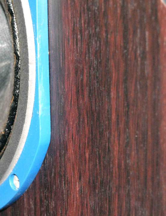

How about a close up shot of the Venuettes?
Thanks again,
Ruben

Hi Danny and all AC members.
For the NoRez, as soon as Danny gets my money, he will ship me ten (10) sheets and I will stick them in all my Venuettes.
I will try first with the NoRez, then, maybe go for extra thickness on the sides of the V-2. I am now working on installing additional 3/4 MDF boards on each sides of the V-1.
For the V-2 top PAudio coaxial driver, I will try NoRez around the back of the driver to minimize reflections.
When I am ready with my U-312 project, I will let Danny know the dimensions of the front panel so that he can supply me with the right crossover.
Since my U-312 project is still on the drawing board, I can change anything or everything to make it right, with Danny's help of course, since he will be supplying all the components.
At first I wanted to go with two 15" drivers, but thought that the cones would be too heavy and sluggish... And, Danny don't sell 15" drivers, that why I wanted to go with three drivers (Virtue/Acoustinators) I also thought about the SW-12B, but it is not for OB and the SW-12-16FR is too expensive, since I need a total of six drivers.
Anyone with suggestions ? ? ?

Hi Ruben.
In a few hours from now, I will post some pictures of my black V-1 and V-2.
All the enclosures are lined with some kind of peel back texturizedéembossed plastic wall paper. For the round surfaces, he peel back the Mac-Tac and heat it with an hair dryer to soften the plastic. I agree to do it that way, because it is inexpensive and for me it looks O.K. but of course the Ferrari Red color looks better.
With my next project (U-312) I might go with the white paint.
But that will not happen tomorrow, it will be more like early next year.
Guy 13

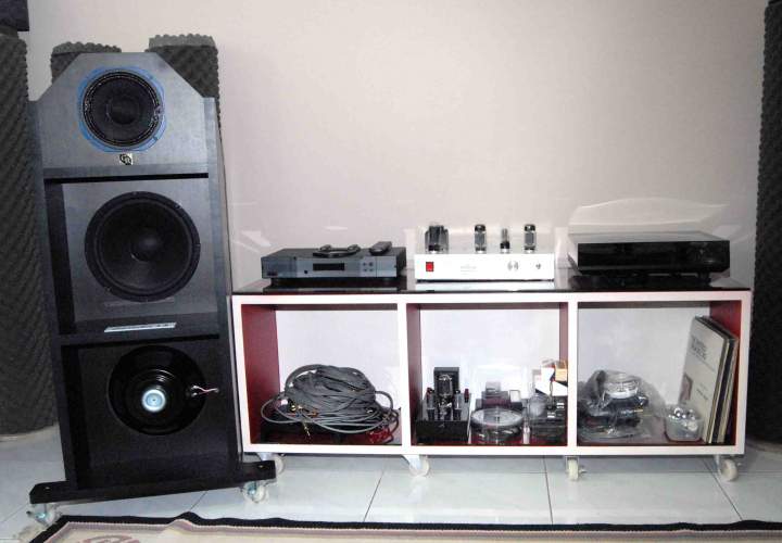

Hi Ruben.
I wrote earlier that I would post some pictures in a few hours, well how about a few minutes ?
I said to myself, might as well do it now, before I become too busy or I simply forget. Here they are.
I hope it will help.
