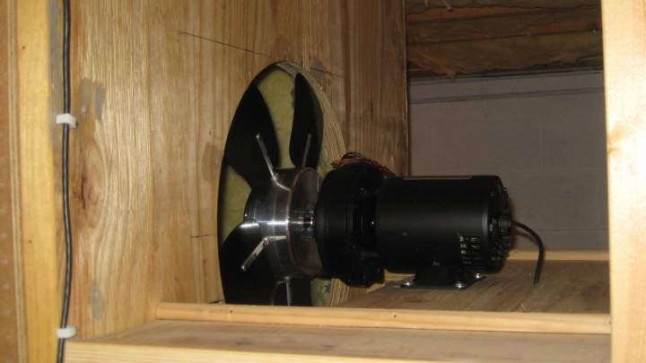

I use Eminent Technology TRW-17 Rotary Subwoofer with my Magneplanar Tympani bass panels.  The Magneplanar bass panels operate from 250 hz down to below 30 hz (low pass xover @ 30 hz, 12 db per octave;  high pass @ 250 hz, 18 db per octave.  The Rotary Subwoofer operates from 25 hz down to below 1 hz, with a low pass xover at 25 hz, 18 db per octave. Martin Logan Summits take over at 270 hz, using the electrostatic elements only (woofers disconnected.  This combination of speakers is awesome!!!!!
