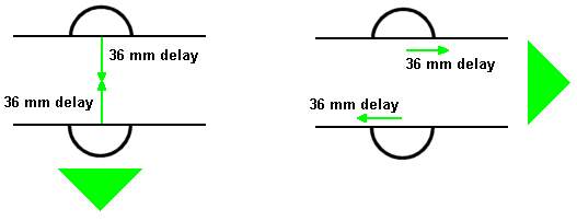

Well, Kreskovsky was only talking about correcting geometric delays, since that has other implications than pure electronic delays. Possibly my example can make that clear:
I look from above at two domes on the front and back of a 72 mm thick baffle. Now I delay each of them 36 mm. Looking from the front (left part of the diagram, direction of green arrow) they now should be time aligned in a mutual plane at the middle of the baffle. Sadly this works only for one position in space. :(
If I change my position from the dipole axis to the dipole plane (right part of the diagram) there are still those two delays. But now they move (literally speaking) the domes along the baffle surface in opposite directions. This will severly distort the dipole figure 8 pattern above 2 kHz. There is no longer a constant attenuation of SPL to the sides of the OB.
Such things have to be kept in mind when changing timings in a geometric context.

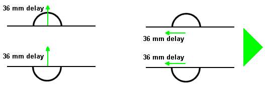

The second part of your explanation only applies if one was to apply the different delay to front vs rear correct? If we apply same/constant delay to both the green arrows would both move to the left correct?
The delay has a value and a direction.
The value is constant for all arrows: the travel time equivalent to 36 mm.
The direction is "+" (added time of travel) for the lower arrow and "-" (subtracted time of travel) for the upper arrow. This would lead (in the left picture) to a virtual "common origin of sound" at the meeting of the arrowheads - as seen by someone sitting in the direction of the large arrowhead.
If both arrows had the same direction, we would simply move both domes back or forth in unison. This would correspond to moving both domes left or right in the right picture:
I think we both understand.... finding the right words to describe our understanding is the most difficult part. Your English is very good especially if German is your native language!
